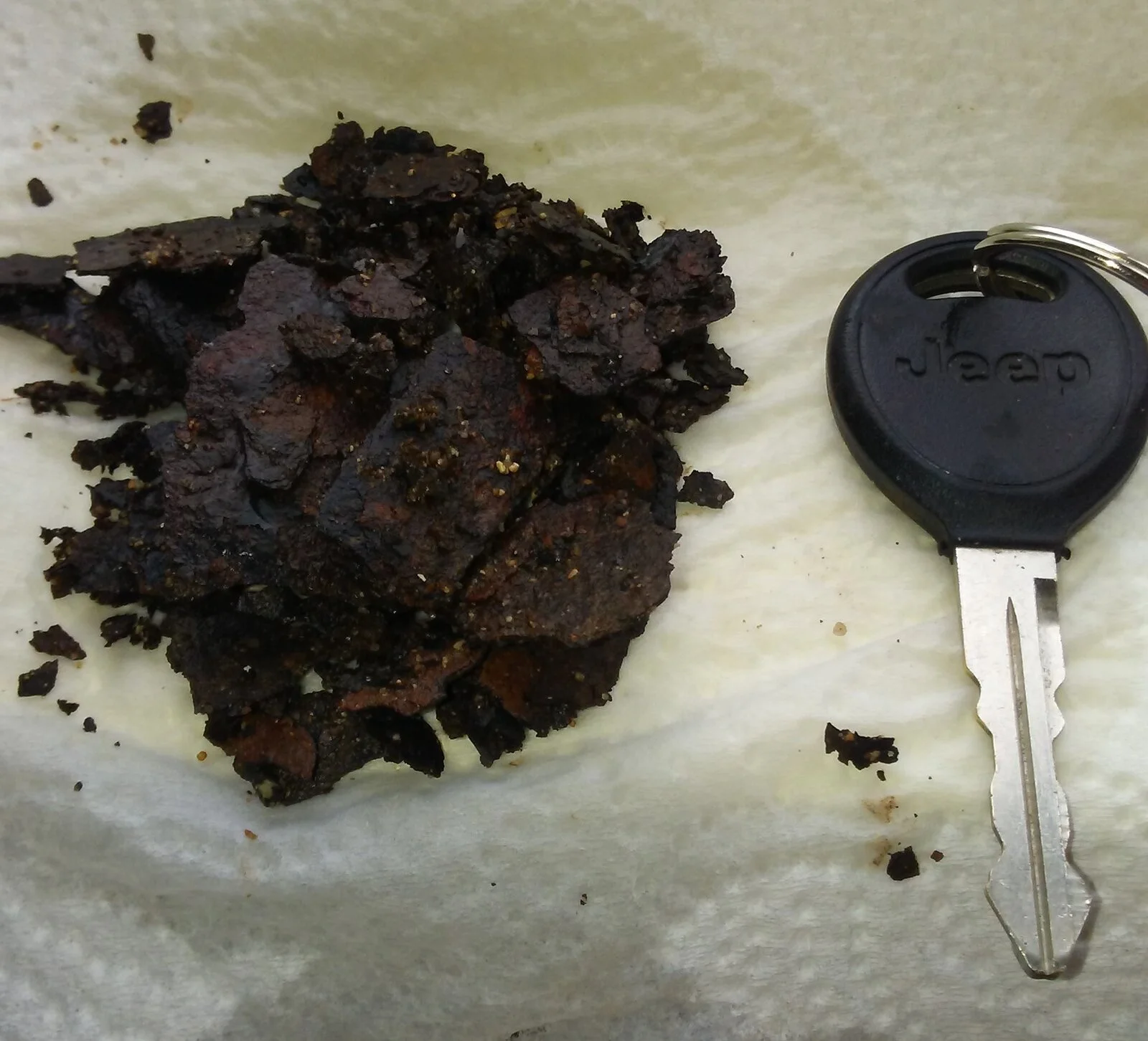

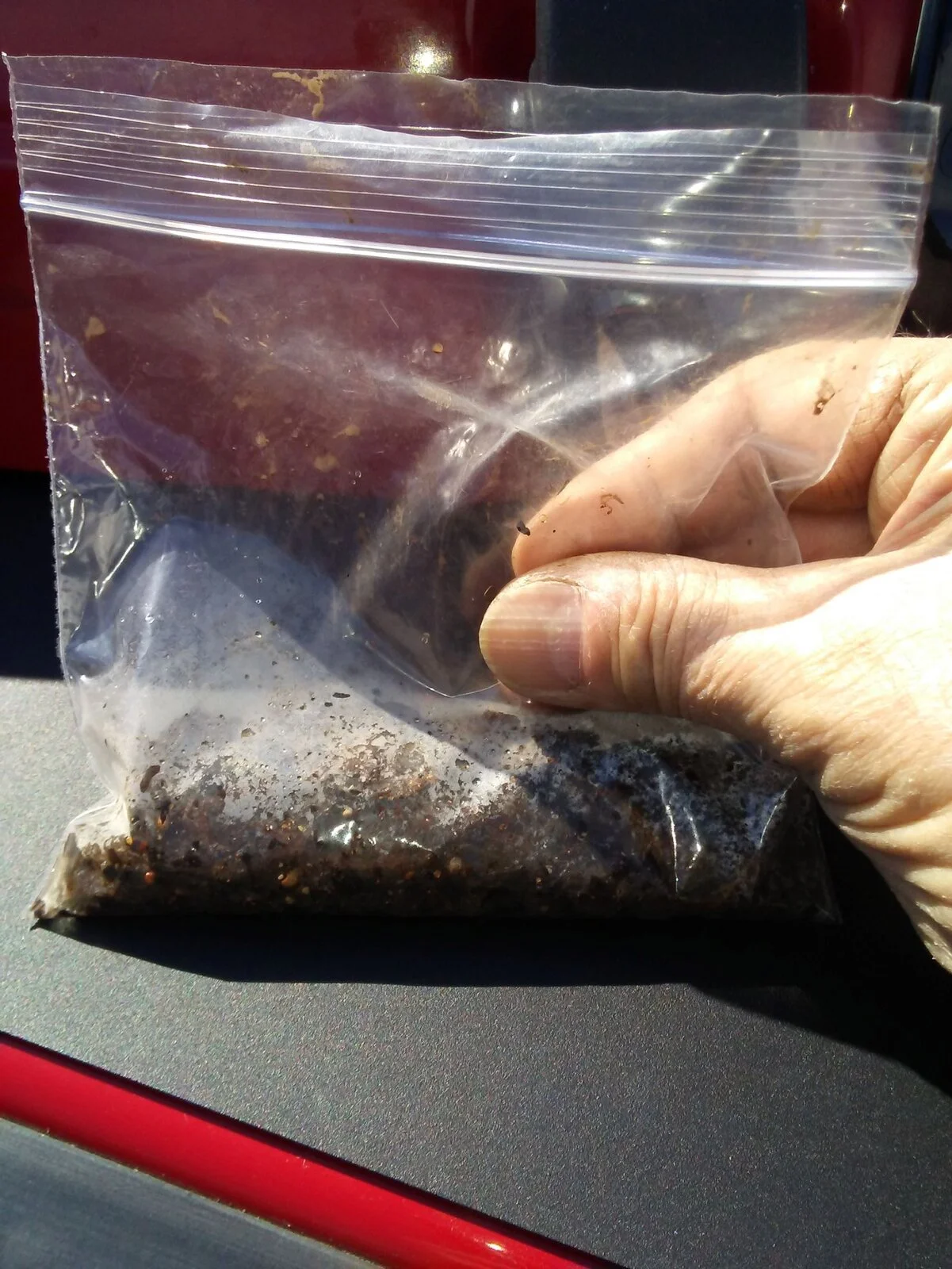

More like SPILL it out. I taped up every hole I could find and it still poured out near the front and rear seams. I didn't even drive it. I cleaned mine out with the car wash pressure hose and used a flexible magnet extension to get the chunks out. Eastwood internal frame coating (4 cans) after everything dried out.
