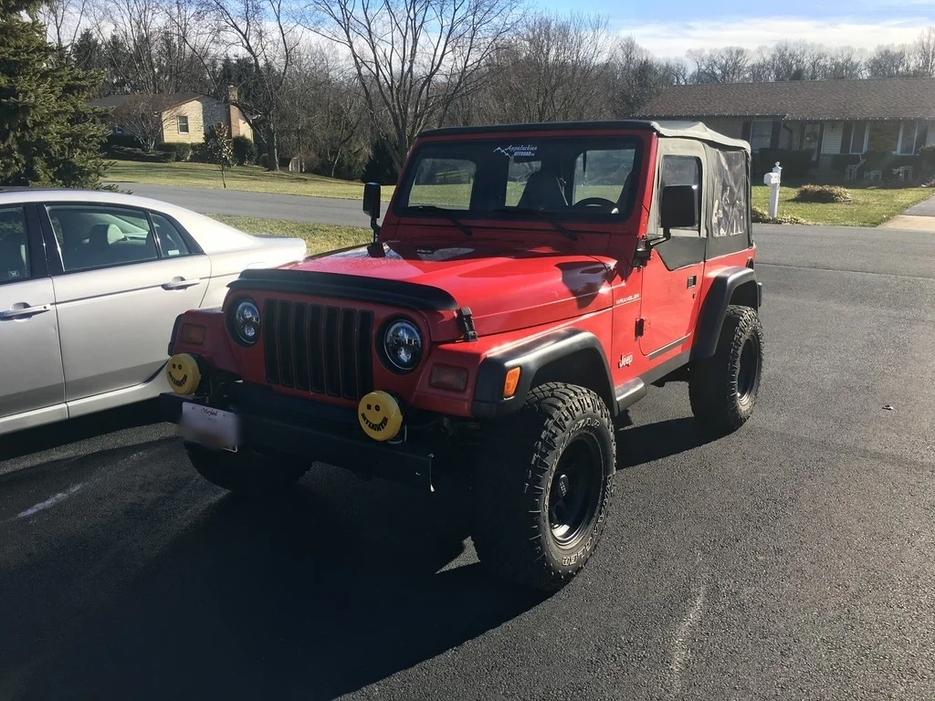

My 2.5 is great for what I use it for. Just Daily Driving and cruising in the Summer. In the winter it is amazing in 3 ft of snow while I drive right past all the stuck cars. I've even had a offer to trade a Camaro for my TJ, I'd never sell the little beast in a million years.
