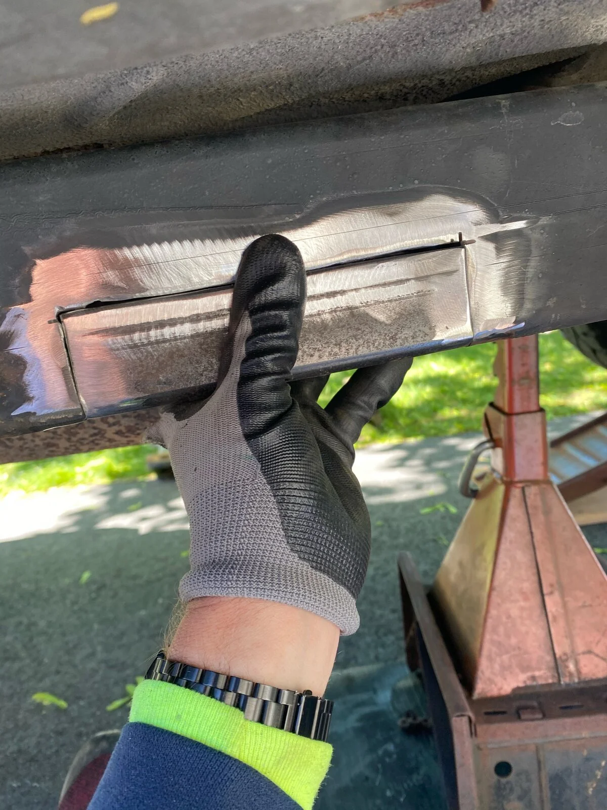

Went with repair of just the bad trans Mount section.

y'all do repairs like this y'all need to bevel your weld edges create a valley the weld can fill ..if you don't and you grind it clean you just removed most of your weld. or you put a strong back or fish plate inside.
Is there a desired/preferred angle for the bevel. I've been told this before and it makes perfect sense. What I wasn't told is how much bevel is enough?

The rest of the frame was not bad. The rot started at the trans Mount bolt. I cut this section out till I had solid frame. I am not a welder by trade but with metal this thin, I figured the gap would be help.
About 2/3 the thickness of the material.1/3 each way if going from both sides, will be enough.
Your weld is your bridge, and the bevel offer's more surface to penetrate and more room for a solid bridge.
