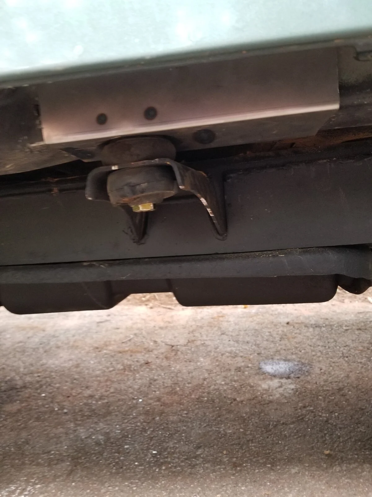

Hopper
Dec 28, 2018
822
Georgia
Here is a pic before I tack welded and painted. Drove like 2 weeks like that before tack welding. The middle frame sections you can also see in the pic.

OP
robo512
robo512
Jan 11, 2021
6
NW Indiana
Looks solid! I'm in the middle of taking the body off the frame now. I'll assess what I need and order it all from pocono
