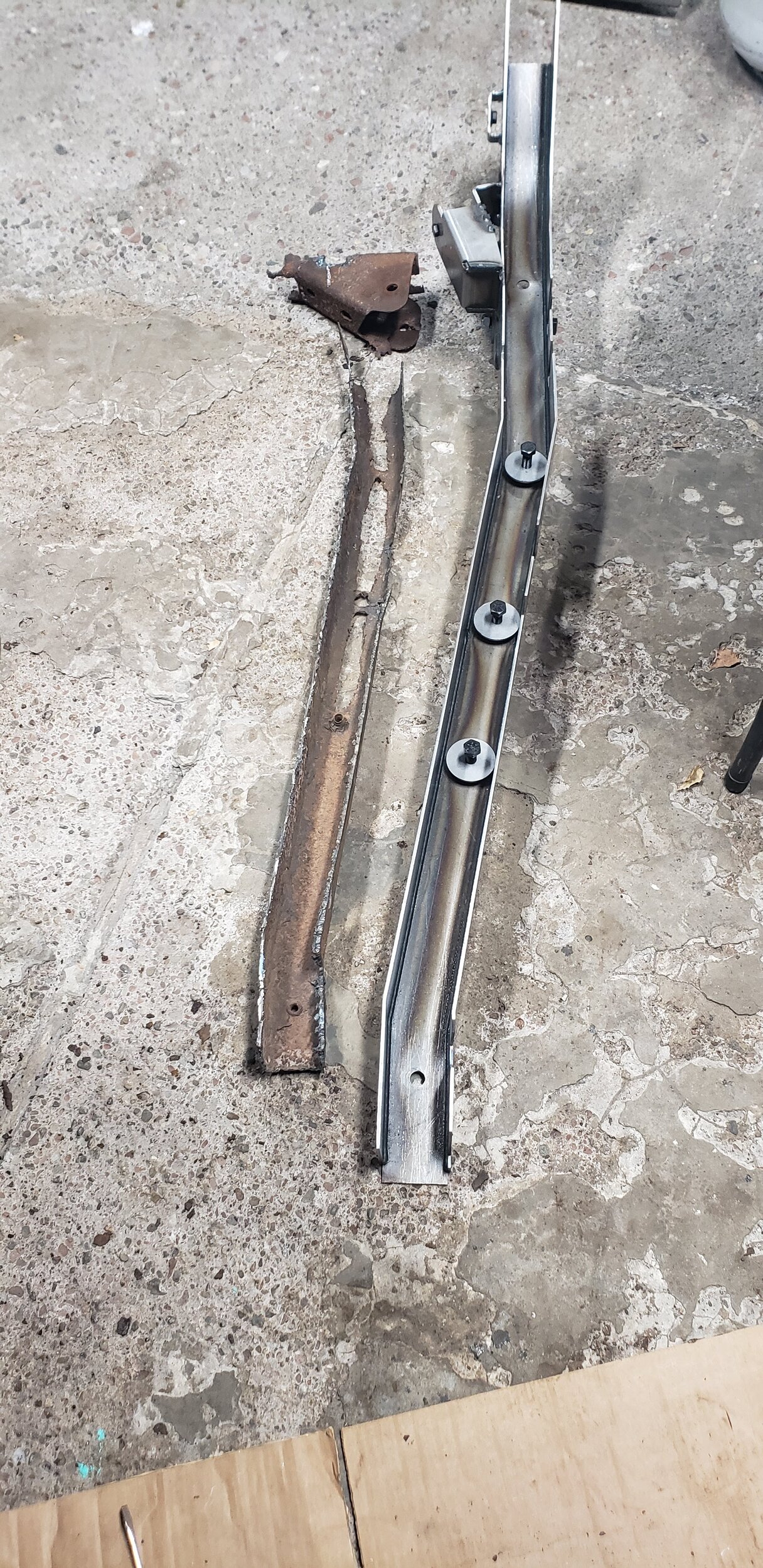

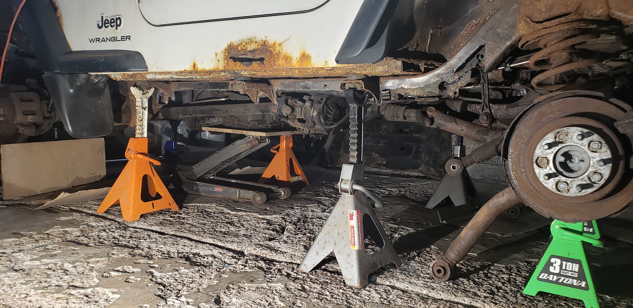

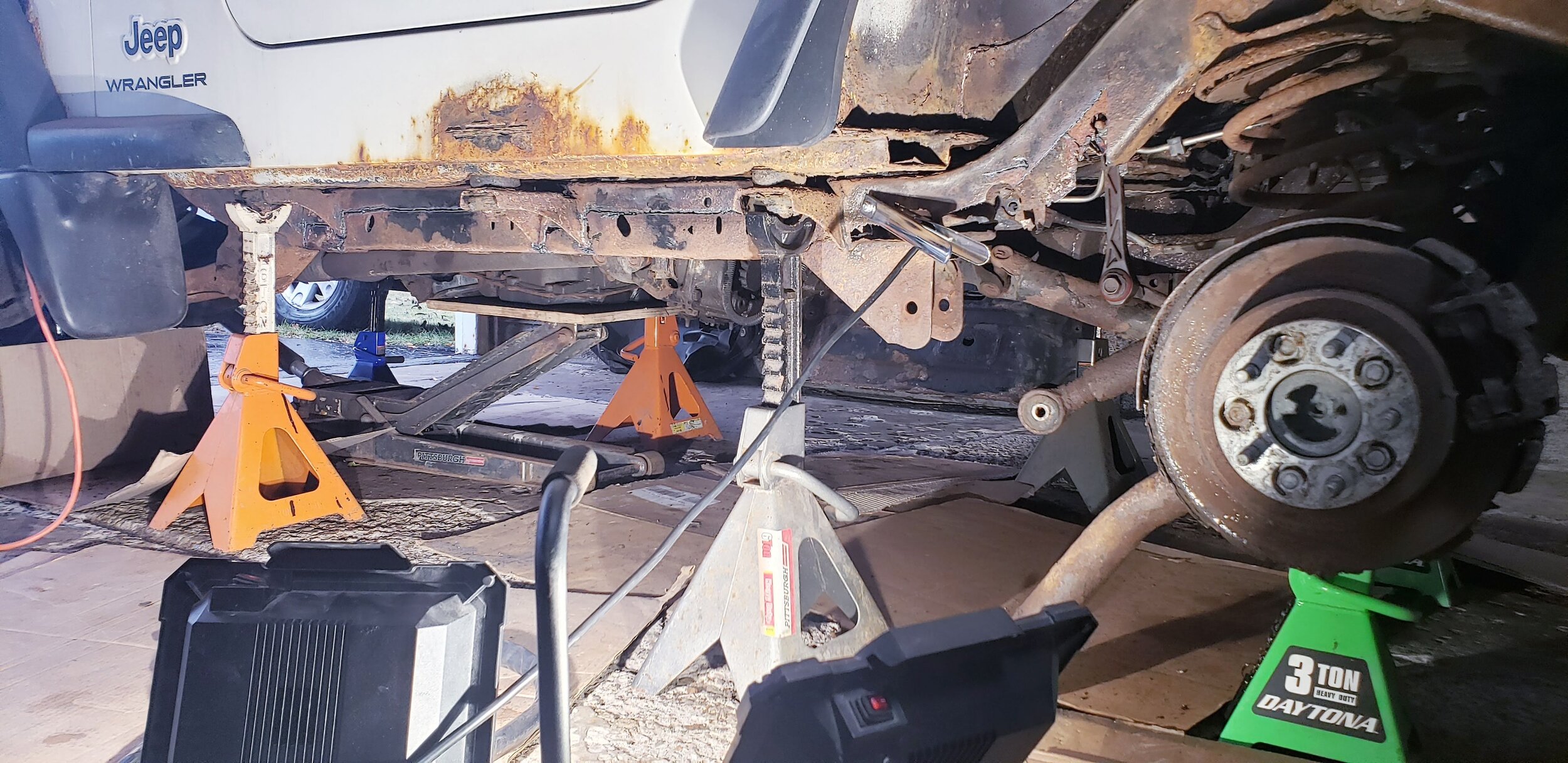

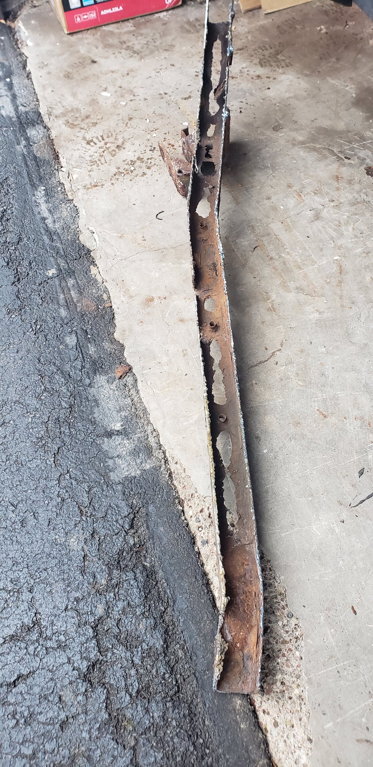

Making progress. things are going okay and I am halfway through the drivers side removal.
PS
If you don't have a plasma cutter, you need one!
