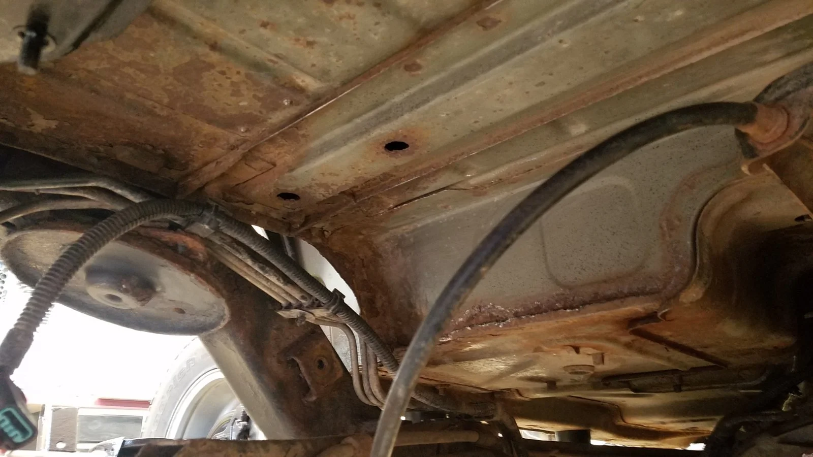

Crawl underneath and look. Areas of concern would be just ahead of the rear axle where the floor transitions to cargo area. It's kind of in line with the front of the rear wheel wells. There are a bunch of panel joints there, and if the tub is starting to rust, it well start there.
Here is an example from my Jeep. See how the rust is around the edges, but not so much in the middle of the panels? Those are the seams and the rust starts there due to the welding. Welding Burns the galvanizing away and the seams are open enough to allow water and salt in. They start to rust, and it's a downhill slide. If your frame is rusted through, and the tub is going, kick the project to the curb. If the tub is solid, then it might be worth it.

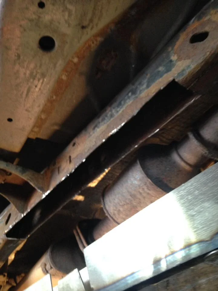

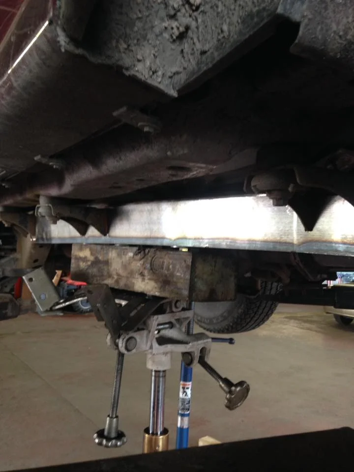

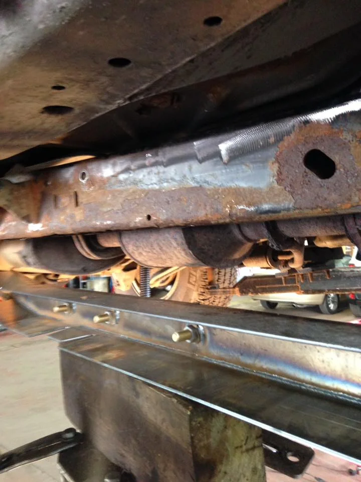

A local dealer near me just got a TJ in from a trade and when I checked it out the frame was shot. I dont think it was as bad as yours but it was bad enough to need fixing.They cut out the rusted part of the frame and I saw they ordered a long channel section that was in one piece. It slipped over the original frame and they welded it up. When it went on the lot the sale price was under KBB value by $3k but it looked like a nice fix for a rusty frame. I know the mechanic from the dealership. Here are some photos of how it was done.

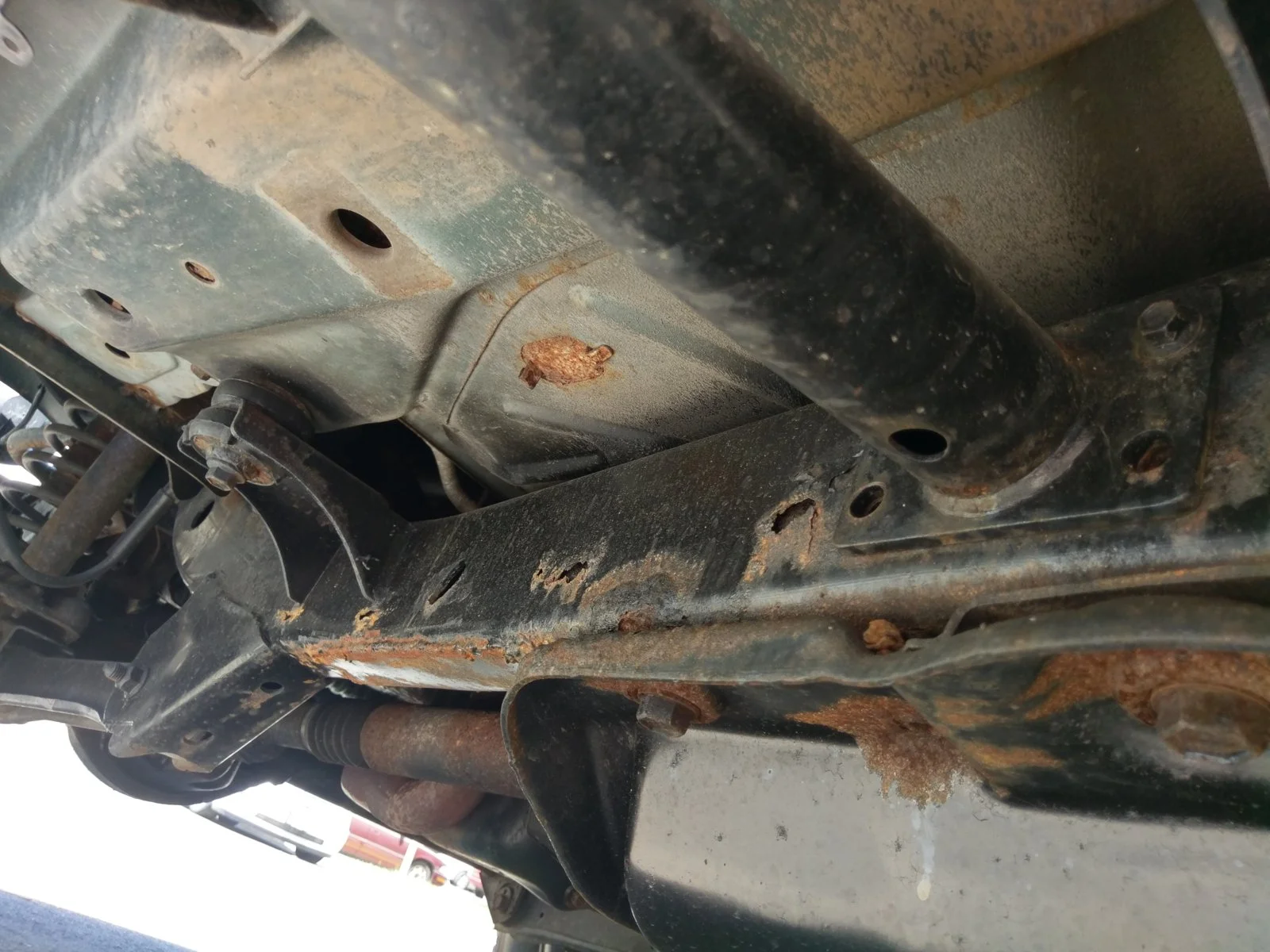

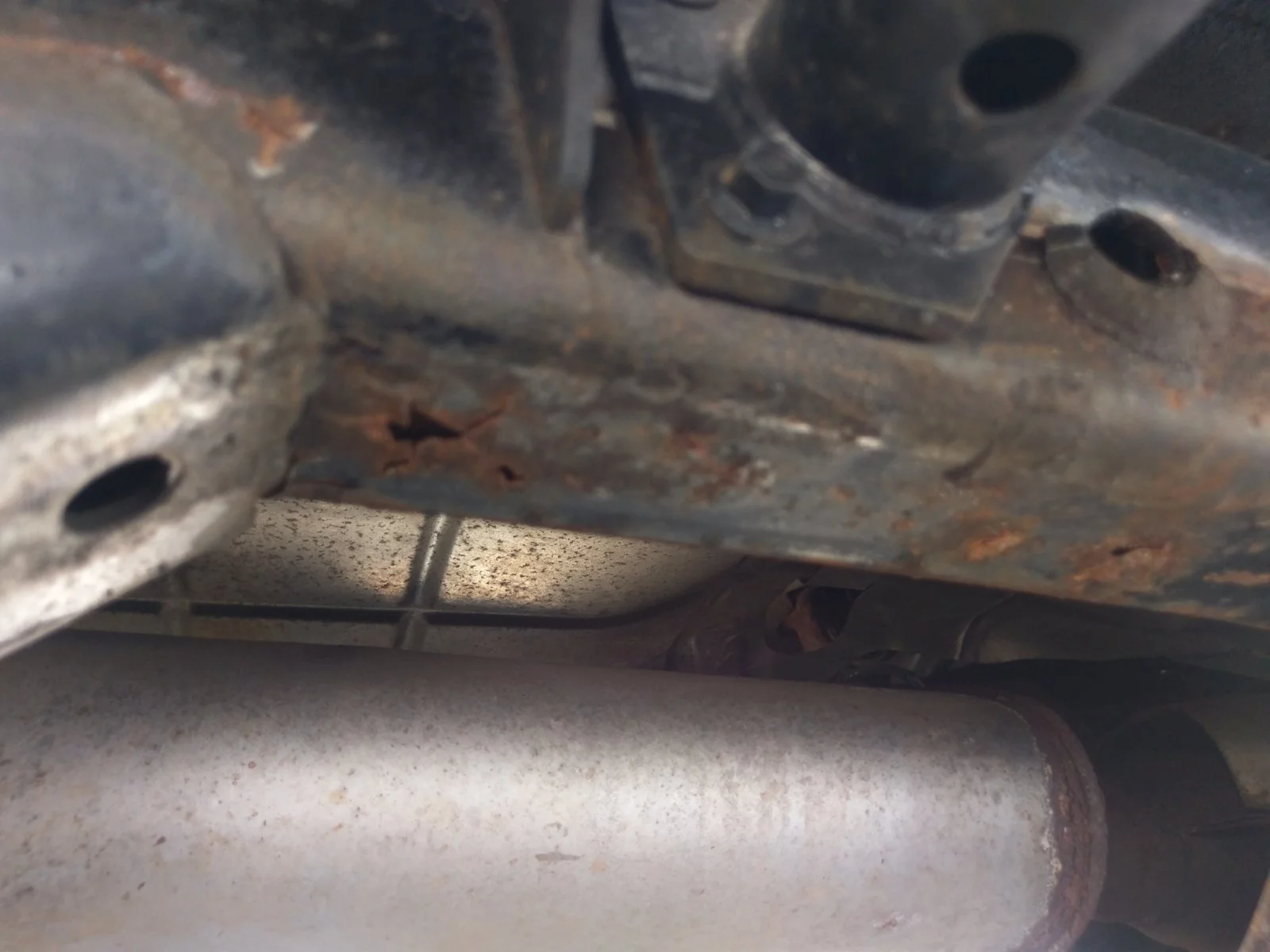

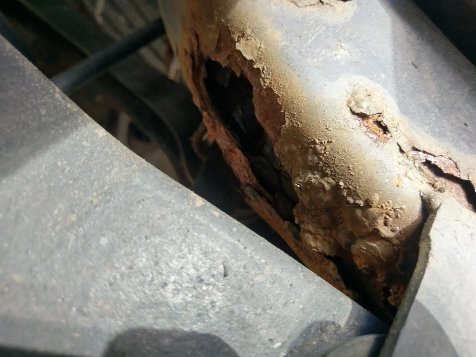

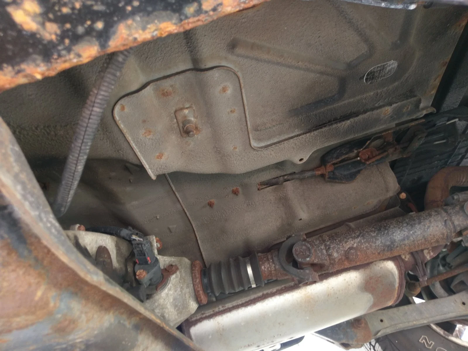

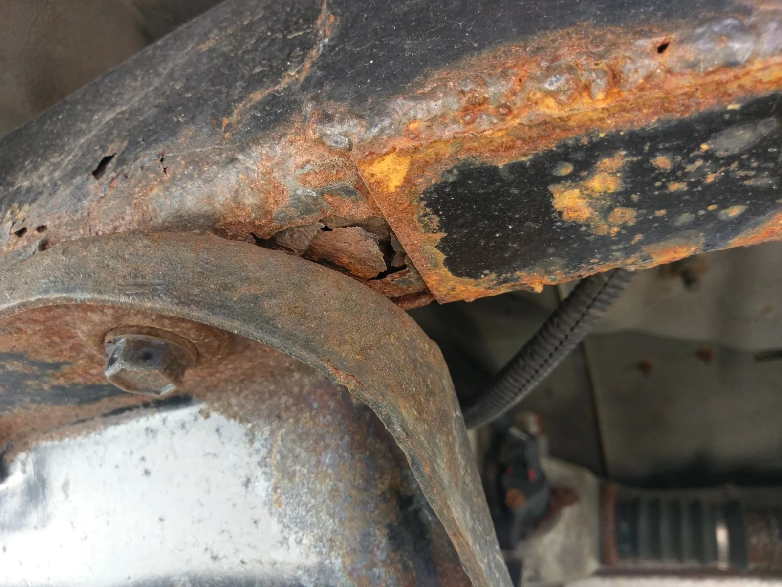

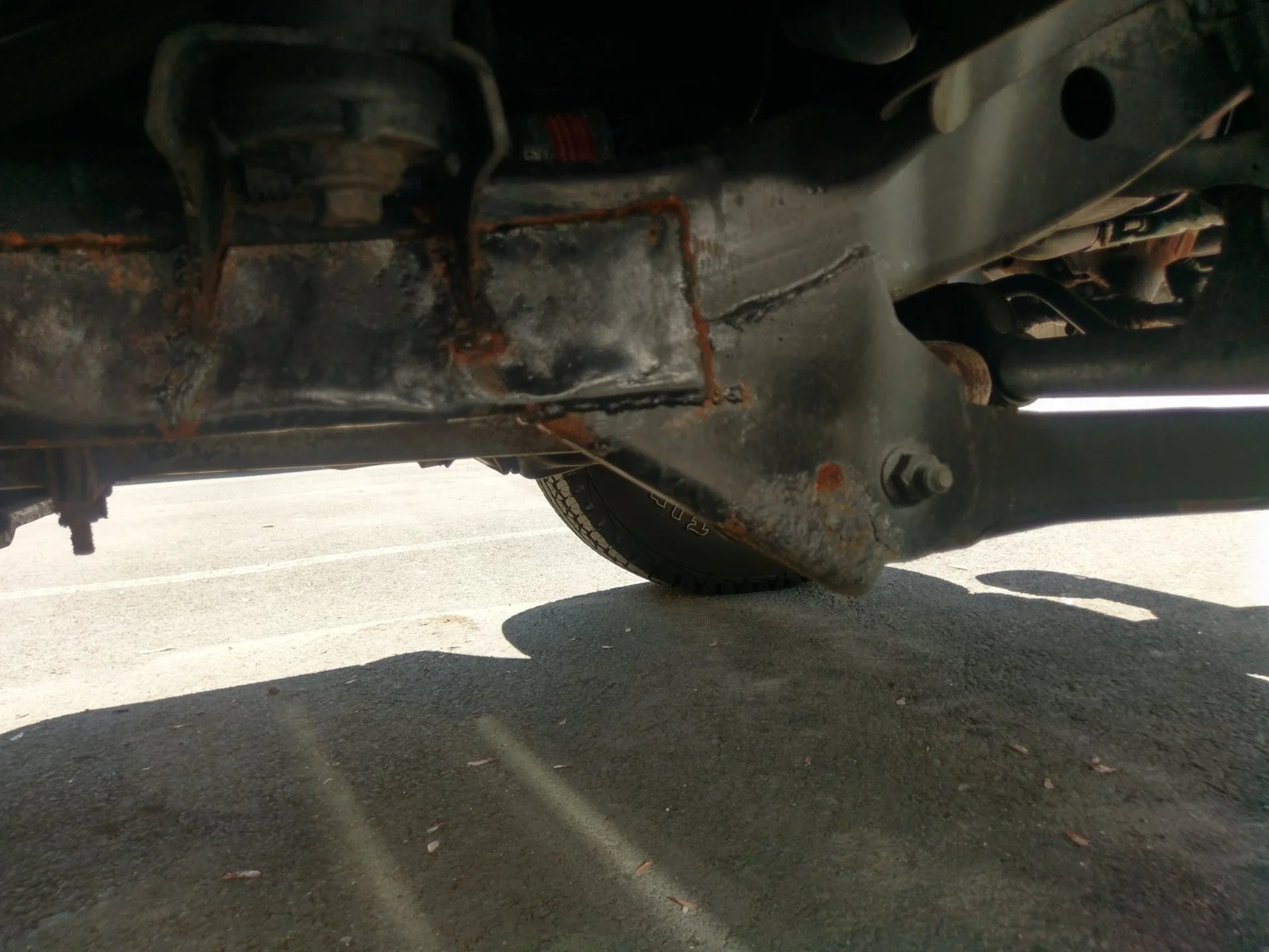

I took some more pictures of the other side. From what I can see the tub looks decent, but the frame is shot in so many places:( It's really weird that it wasn't obvious before. How could they have disguised this level of rot?
I found a 4cyl 5spd for $7500 with no rust...they're out there...I wouldn't pay that much for one...especially not a 4cyl...but it might work for you.
In my opinion, a frame swap would not make financial sense as you and many others have said. The previous repairs that were done are half assed at best, really just there to cover up the rot (not structural). If you want to keep the Jeep, then Safe-T-Caps are the way to go. They are a good repair (stronger than the original frame if done properly). This is the set that you would want:
This set would replace the whole rear arm mount as well as the skid plate mounting area (both rotted in your pics). I suggest showing these to your welder and getting a quote for him to do this to both sides. My guess is that you will be right around your $2000 mark.
Also, if you want to sanity check the price that you get, call Auto Rust (401-944-4444) in RI. The are the makers of Safe-T-Caps and I believe they also have a shop where they do repairs using them. They should be able to tell you what they typically charge to put any of their parts on so that you know if your welder is being reasonable.
