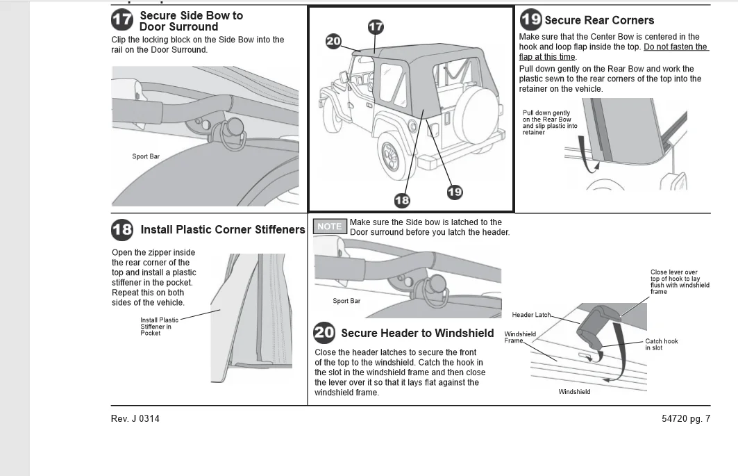

Not sure what stiffeners you are referring to.
The
After posting my story, all I can say is I really have no idea. When I was driving around with only one strap attached I didn't even notice the top was somewhat crooked until the first time I was putting it back up. I almost just disconnected the other one and hoped for the best. I'm also not sure how important the big plastic corner stiffeners are. I'm temped to pull them out because I think it would make it easier to lay that top along the tub when lowering it instead of removing it completely.
My guess is that both those things are somehow related to coil springs.:p
The plastic panels in the rear provide additional structure and help the top remain taught.

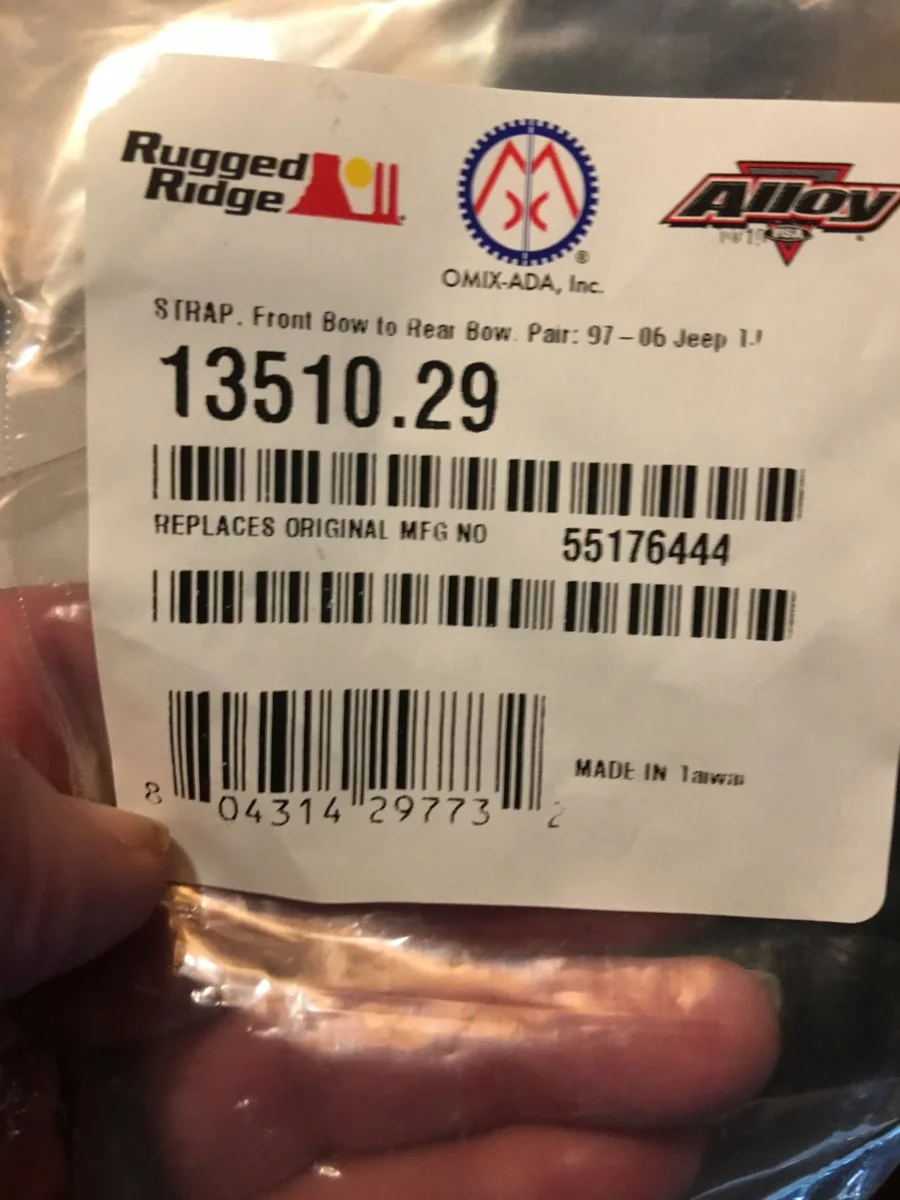

Could you post a picture? I ordered the straps from Amazon. Will post when I put them on.

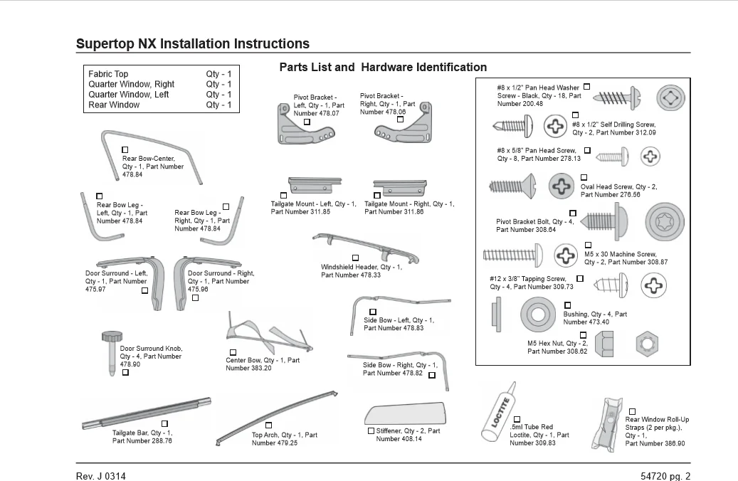

I don't have actual pictures and the wife is out and about with the Jeep but here's a couple pages from the Supertop NX Instructions.
It's the item in the center of the bottom of this page:
And how it's installed in step 18 on this page:

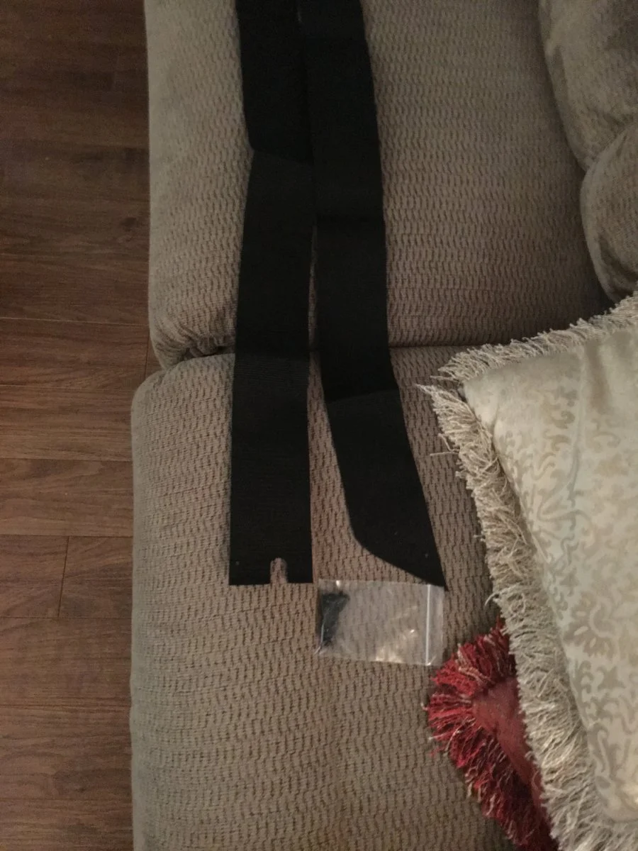

Thanks much for the info. Does anyone know the measurement between the bows where the web straps attach? I'm making new straps but I don't have the original straps or a template to follow. I'd be good to go if I just knew how far the bows should be from one another, measured center-to-center at the strap attachment point. I believe I read 32" somewhere but I can't find that post again. Thanks for any help!
I believe they're meant to keep the spacing between the bars to allow the soft top to open. might also keep the material above the window from sagging but not sure. No worries though, I just went and bought new straps.
