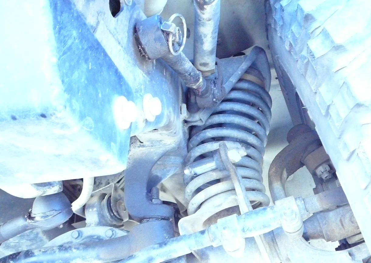

Disconnecting highly recommended. I made my own. No problems and literally takes a minute. No need to tie up sway bars, just rotate and rest them on top of upper spring perch. They won't go anywhere.
