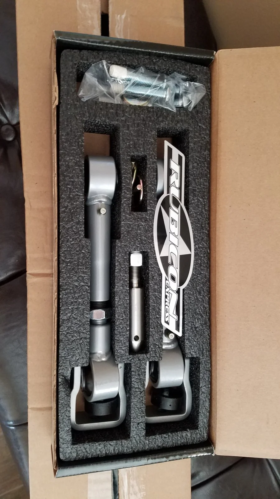

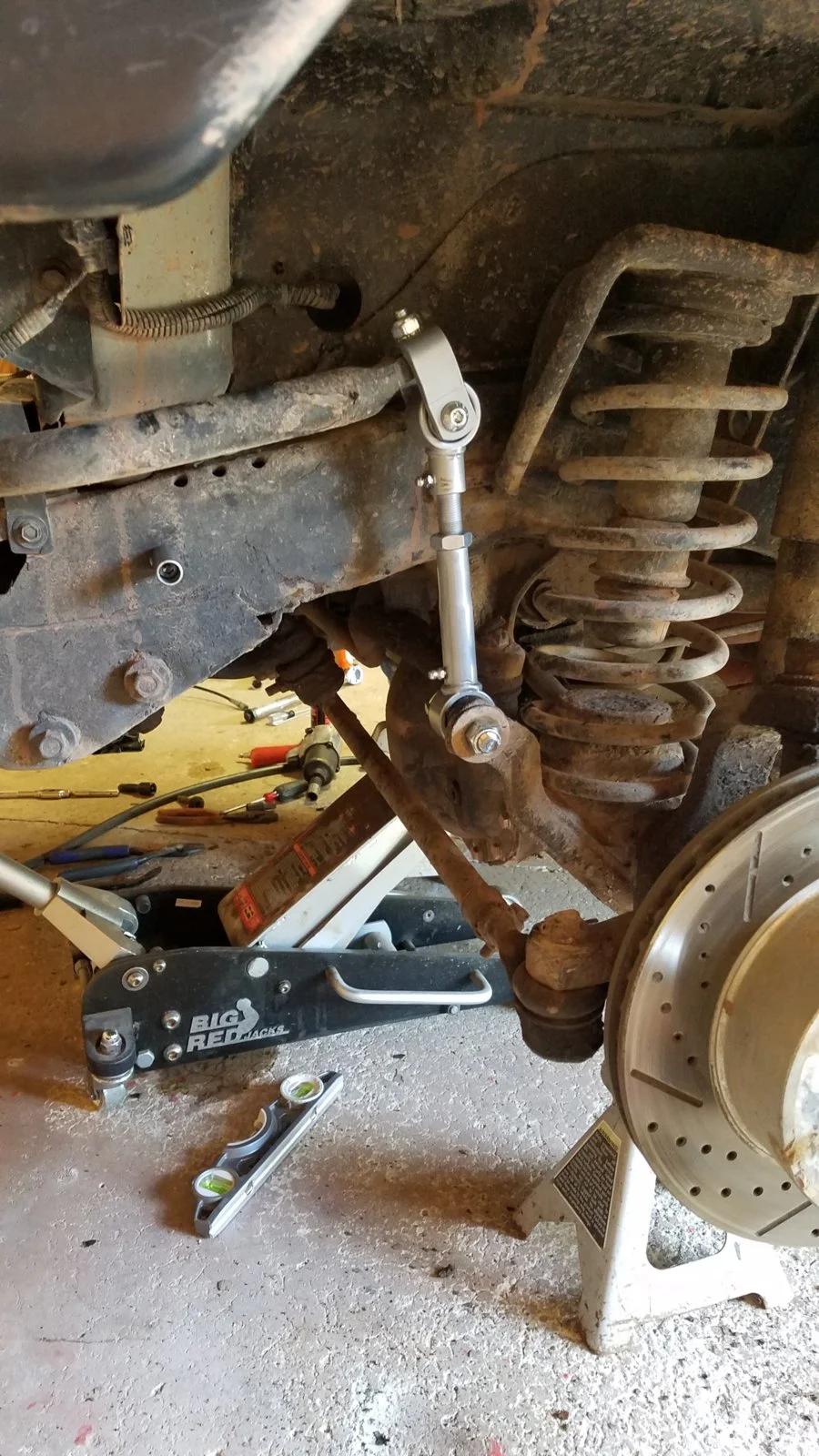

I'm running the Rubicon express version. They do come with extra pins to control the loose bars when disconnected. They are stout units. The fit and finish isn't quite as good as JKS...I had a couple of paint touch ups to do before I installed them. The threads at also raw steel, so take them all the way apart, coat them with anti seize, and thread them back together.
The JKS ones have yellow zinc plated threads, so rust will be better treated. Both have decent bushings, and are very easy too reconnect.
I was impressed with mine...
