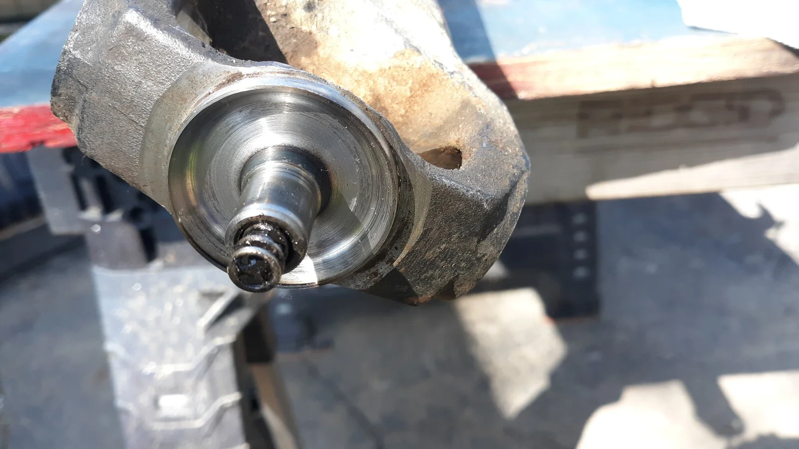

I had sparrows, so I pulled the front DS to mess with the DC joints.

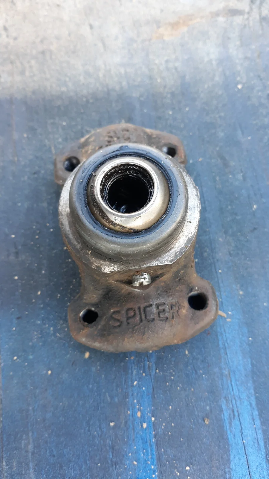

Turns out, mine is greasable. No problem, except it is.

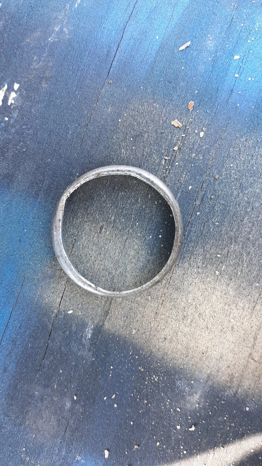

The driveshaft side ring that the ball of the cardan yoke settles in is deformed. Any ideas for a replacement?
All the parts in the DC look good except that ring. Am I looking at a whole DS?
Thanks

Like I said, all is good except that small...retainer ring? Swivel cup? Is deformed
That ring looks to be a part of the rubber boot that is pressed onto the outer edge of the centering stud. I dont recall any ring around the CV centering ball/bearings.

If that is the only issue can it be straightened? Are those thin sheet metal?
Thick metal. A vise and channel locks just deformed it more.
No rubber boot on the greasable joint
That ring is the dust deflector for the greasable pin yoke vs the boot that is used on the non greasable pin yoke. While it is a bit of a bummer that it is damaged you can assemble the cardan back together without in and it will operate just fine.
I kind of did that. I'm still looking for a new one, in the meantime, I'll just have to be more religious greasing that stupid needle zerk
