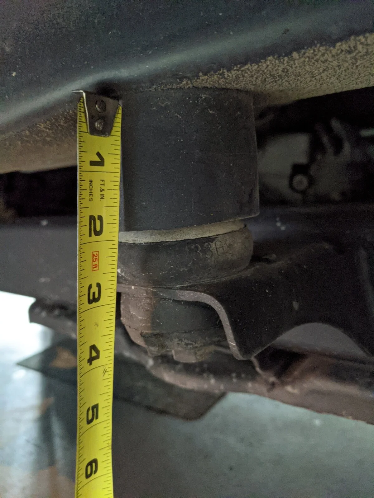

Front rake question
Will any of the ride comfort change if I remove the BL and put 2" springs? Essentially, I have a comfort ride equivalent of stock right now. Or am i just thinking waaay too much on this subject

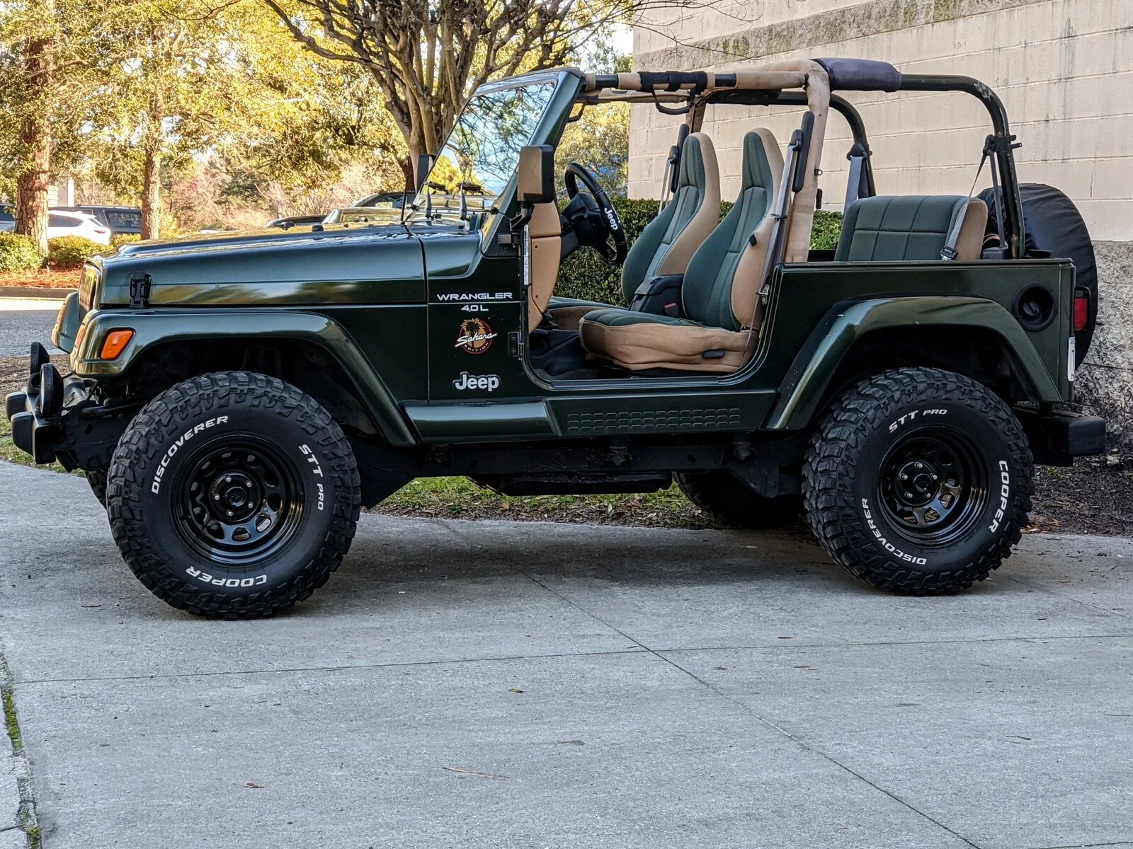

I'd leave that alone. I wouldn't try to level it if you ever use the hard top.
ya kinda my thought. I just need to enjoy the jeep for what it is instead of wanting more. Coastal NC weather is all over the place 6 mths out of the year. Yesterday 82, today 50. So I'll use the hardtop quite a bit. It's on a hoist in garage, so easy on easy off.
I don't really feel like dealing with Shocks, cprings, bumpstops, adjustable track bars, a SYE (Slip Yoke Eliminator) , rear upper and lower adjustable control arms, and a DC driveshaft. I just want to enjoy a simple stock ride for a couple years. I've already replaced all the axle ujoints, ball joints, tie rod, track bar, dampener, and some other bushings since NOTHING had been replaced on this 230k jeep I bought.
Then again, I guess I could just do a transfer case drop and skip the SYE, adjustable control arms, and DC driveshaft🤷
You seem to understand that one mod leads to another. If you are happy with your current ride and tires, then your plan of refreshing the stock set up seems smart.
