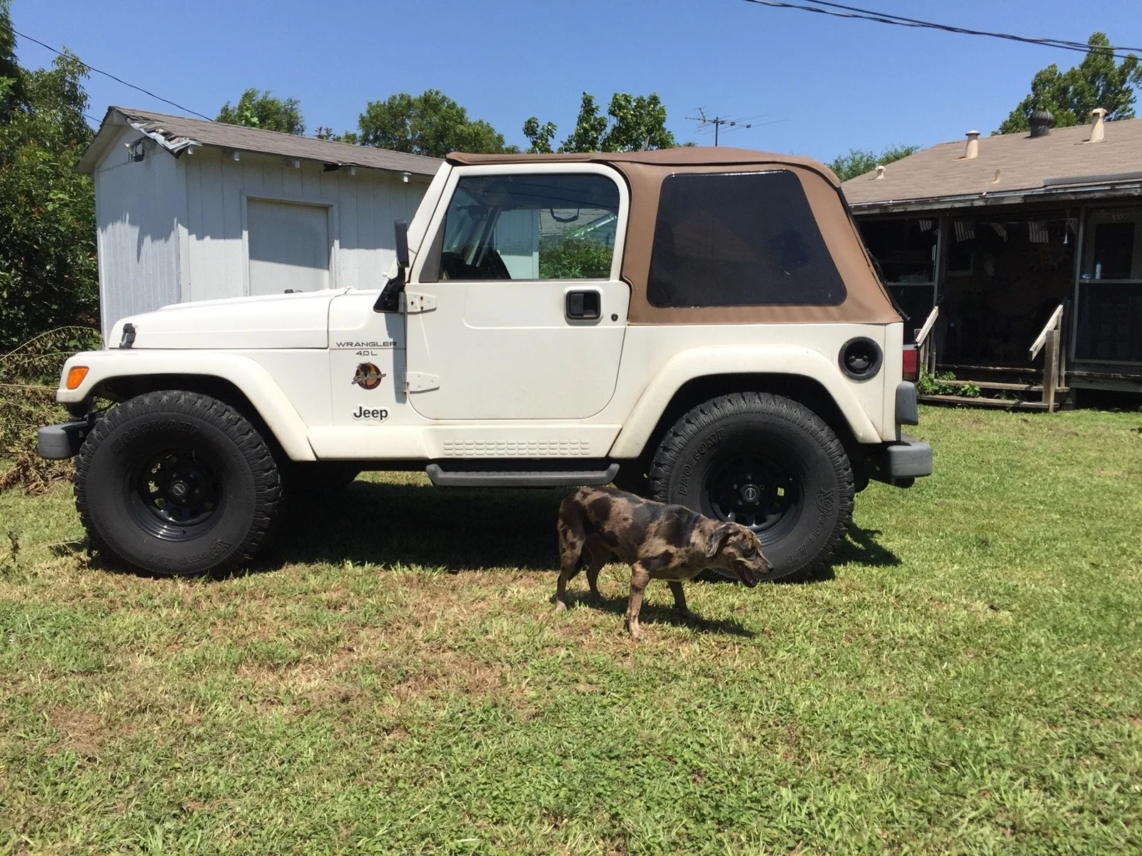

Would this be considered better than a body lift? Can’t afford a real suspension lift so I was looking at these spacers for all four corners. Your comments on the Pro and cons.
98 4.0 auto stock
Daystar, Jeep TJ Wrangler 1.75" Front or Rear Lift Kit, fits TJ, Cherokee XJ and ZJ 1984 to 2006 2/4WD, all transmissions, KJ09100BK, Made in America https://www.amazon.com/dp/B001GH5OCA/?tag=wranglerorg-20
Budget boost lifts such as the one you listed is common, not ideal, but a common way to gain some altitude. You'll need to address your shocks as well. They'll need to be longer.

Unfortunately, budget boosts like you linked to will give you none of the benefits of a spring lift, while still giving you all of the drawbacks of a lift. Many people use them for tire clearance on the street. They work reasonably well for that. Like @bobthetj03 said, you will still need new, longer, shocks. Make sure to check your bump stops and adjust accordingly. You don't want to put the springs into coil bind after installing the spacers.
A small body lift is perfectly acceptable. Say 1 - 1 1/2". That's another can of worms. Lifting the body puts things like the transfer case shifter linkage and cooling fan out of position. Those things can be fixed.
A body lift (~$130) will lift the body/tub away from the frame, giving you more room for bigger tires. It will require you to relocate your fan shroud by 1", a rather easy and free task. You may also have to fumble with the adjustment on your TCase linkage (the device under the handle you use to change from 2WD to 4WD), or get an aftermarket replacement like the Savvy TCase shifter (~$169)
A suspension lift with spacers will also work. It will require you to get longer shocks (all in all ~$250).
Either solution will work. I prefer the suspension lift route, but you may be able to get by cheaper with the body lift only and some minor adjustments, if your up for a couple hours of work.
