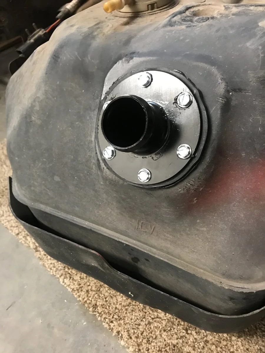

In order to install the body lift from JKS and my new rear bumper I had to drop the fuel tank. While doing that I noticed a crack on the filler inlet piece.
In order to avoid a whole new fuel tank I did a modification I found on this forum which you can see below. The backflow valve was removed in order to make it seal properly due to it being molded to the filler neck. I used the GM hose in order to add add a valve back. Nothing else was modified with tank or filler.
When I reinstalled the fuel pump I am getting either a lack in fuel pressure or something similar. The jeep runs great but cranks a little longer than normal on start up and a couple of times I have lost acceleration while driving at speed. Starts to miss and drops to 25 mph. Here’s what I’m thinking…
A. Fuel pump/sender was on its last legs and by removing/installing I’ve killed it.
B. When I drilled the holes to attach filler neck (below) a piece of plastic clogged the pickup line...
I don’t have any check engine lights or codes yet...I think I need a new pump/regulator. Do I need the whole Bosch module or just the pump?

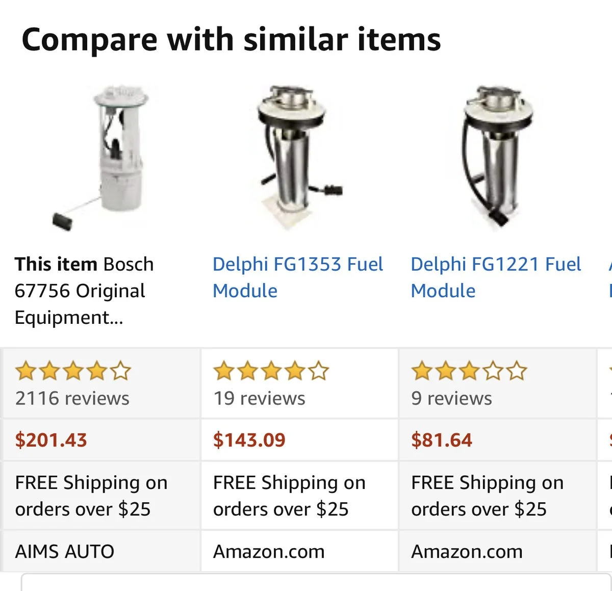

Thanks Chris. Below is a snapshot, are these the correct part #’s?

It doesn’t have the regulator on top like the one I have now, is it just a little bit of a different set up than the stock one?
Bummer, I was totally wrong! That fuel pump is for the 2005-2006 models (which has the same top), I just verified this on Bosch's website.
According to the Bosch website, model 67726 is the correct unit for 2003-2004 TJs, in which case Amazon has none in stock, as they too have been discontinued.
If you can find any in stock somewhere else as leftover stock, I would snatch one up.
Snap! So back to the Delphi FG1353 as the next best alternative?
