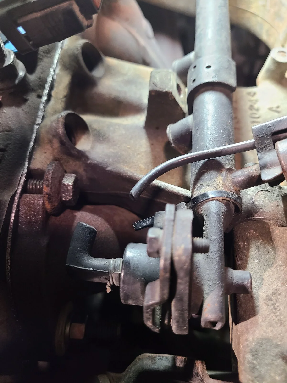

Previous owner had this line disconnected that goes to this elbow. I haven't had issues but noticed gas on my first injector and that I had a leaking o ring. Now I instead think this line is dripping fuel. Is this line important / should it be connected to the elbow?
*I thought I had a leaking o ring but now think this hose was the culprit
The hose goes down to the intake manifold/throttle body area.
That is the vacuum line to the fuel pressure regulator. If gas is coming out of the regulator, you need to replace it.
Thanks JKP! I opened up the fuel pressure regulator and changed the o ring out. No more leak! Did this a long time ago, but thought I would just add this reply to wrap up the issue in case anybody else runs into this.
