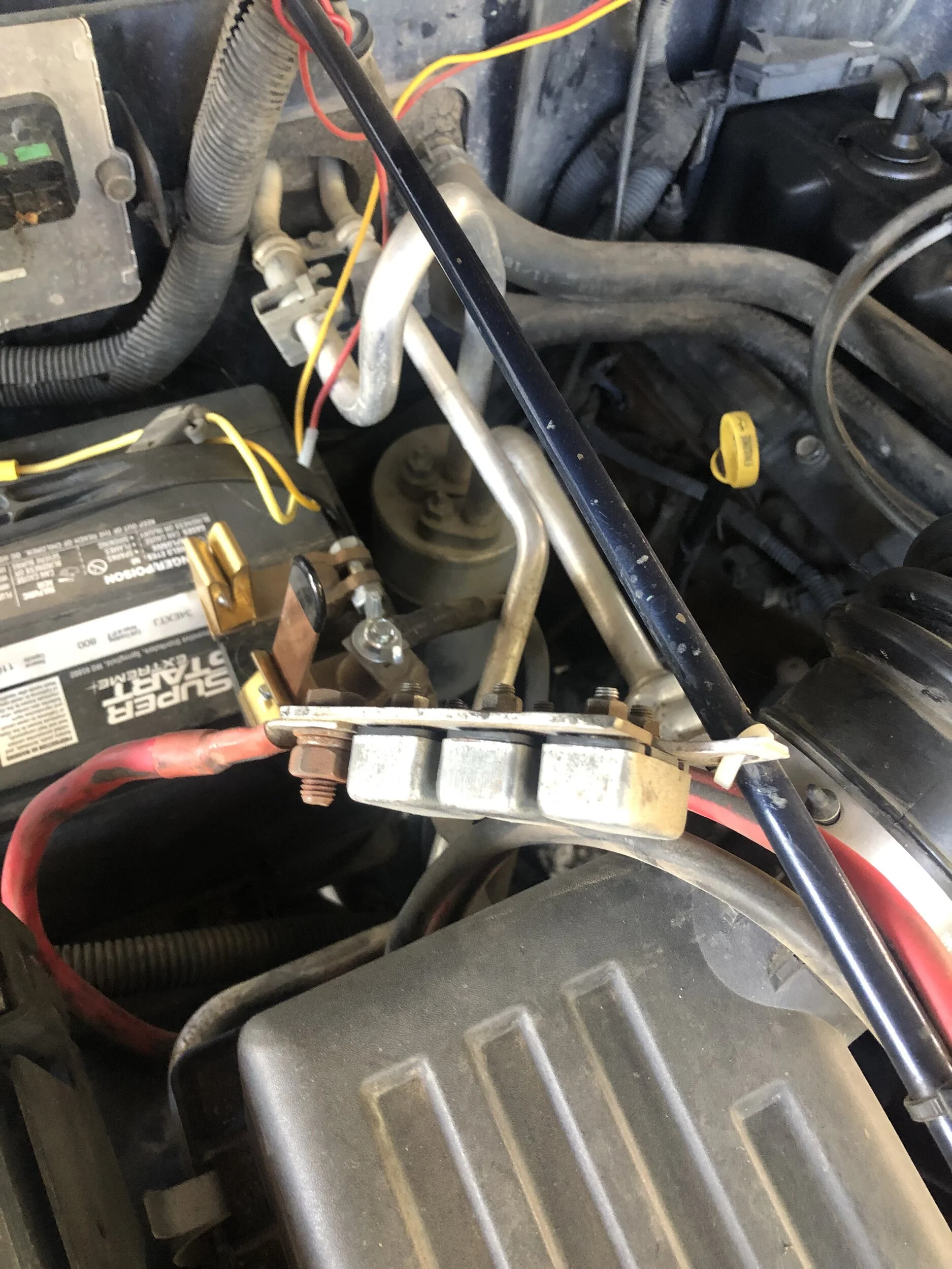

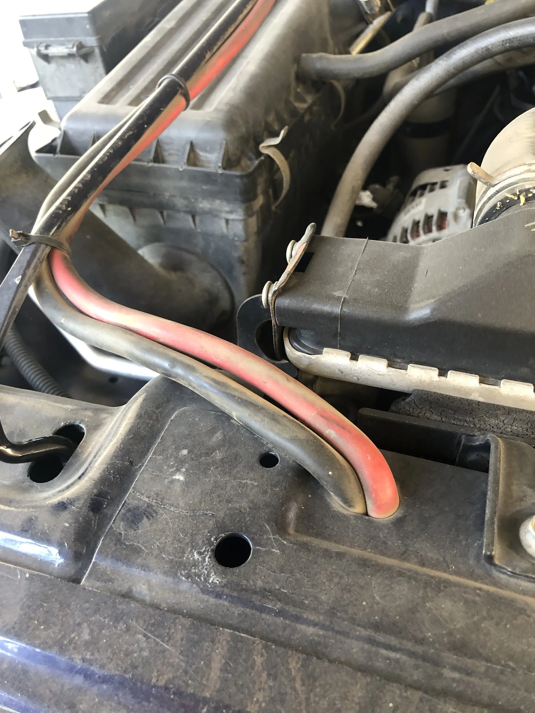

PO put circuit breakers on my setup and I keep it disconnected from the battery until needed. Mr Blaine would cringe if he saw how PO routed the cables through the sheet metal. Reroute is on the long list of things to do in the future.
