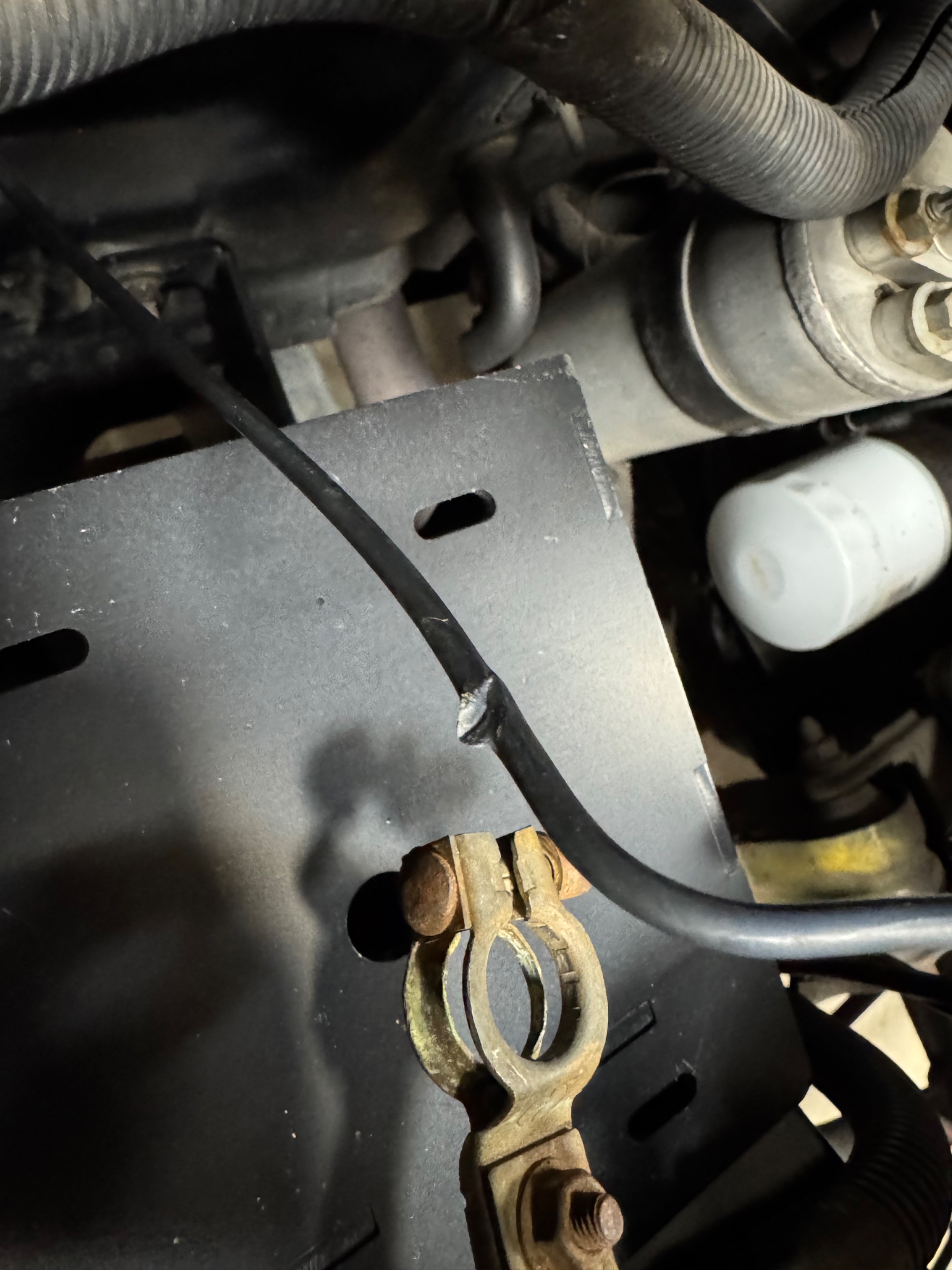

I’m doing HiLine’s too, so I’ll be following your thread now to see what you do with everything. Mine are GR. I didn’t catch what yours are. What are they? Sounds like you love cutting the hood. LOL. I broke my vacuum line too, over by the CC. It literally just snapped when I went to move it. Time for more tubing all around. Ton of little projects, but in the end should be a big improvement. Yours is looking good.

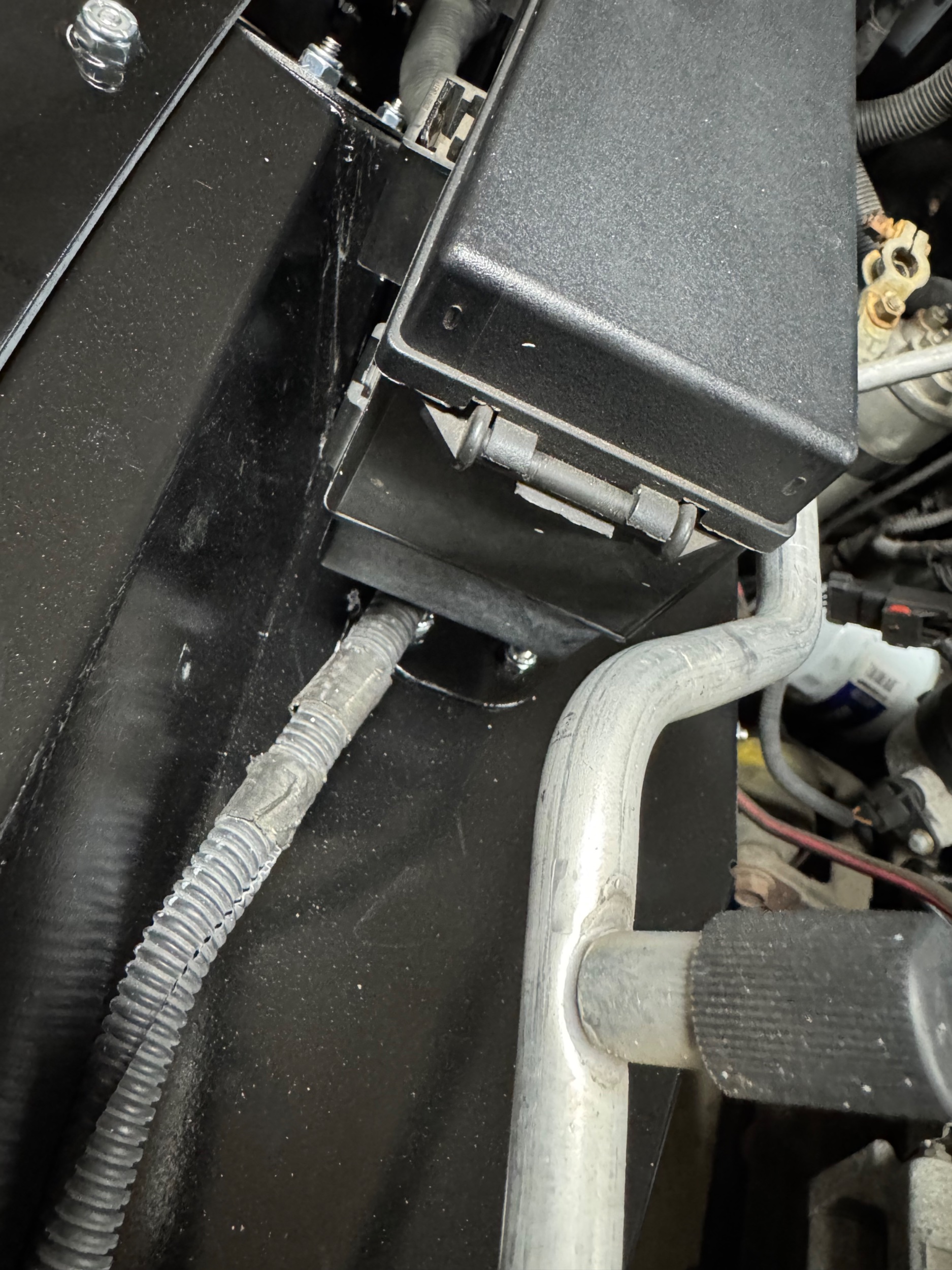

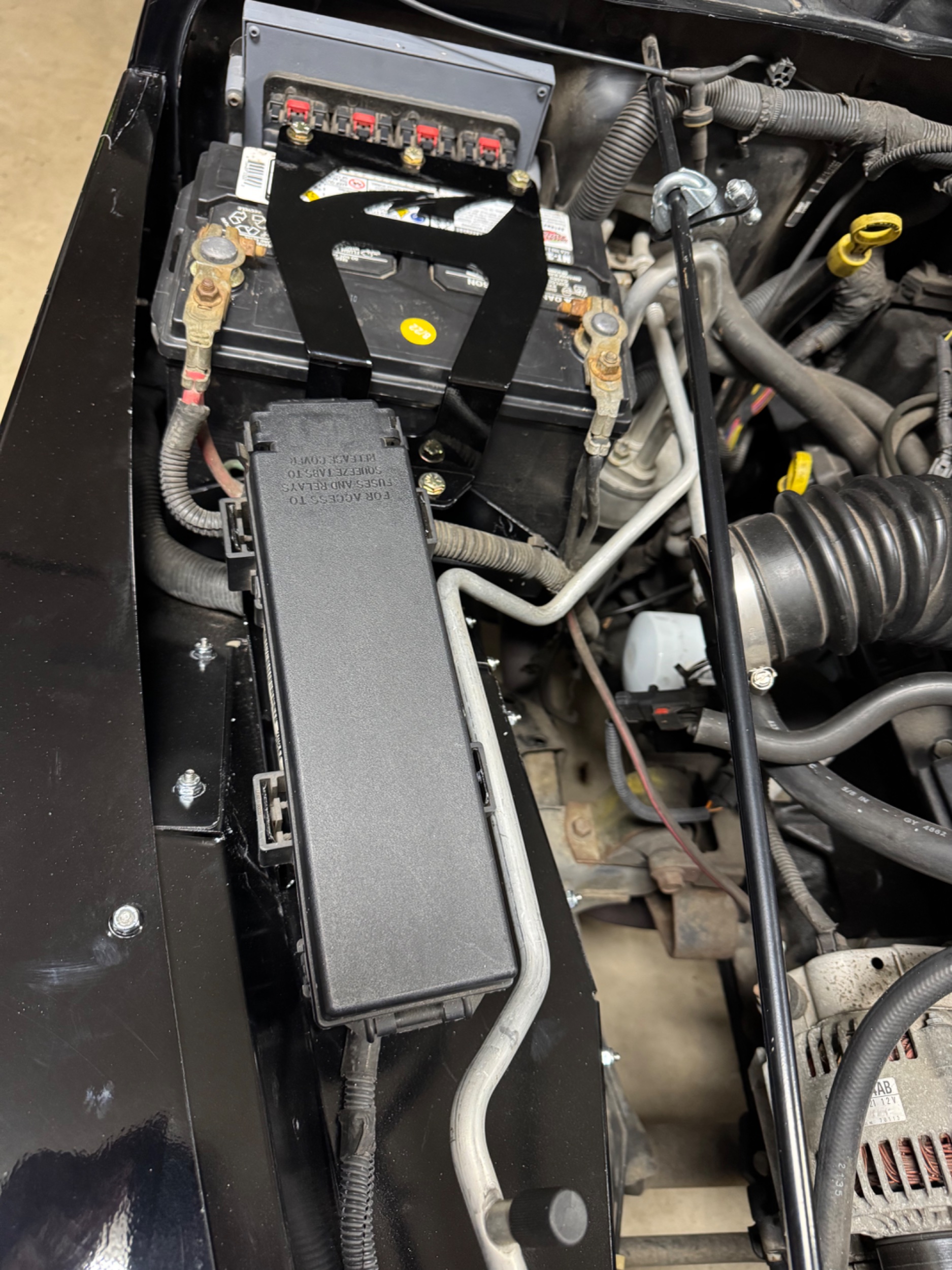

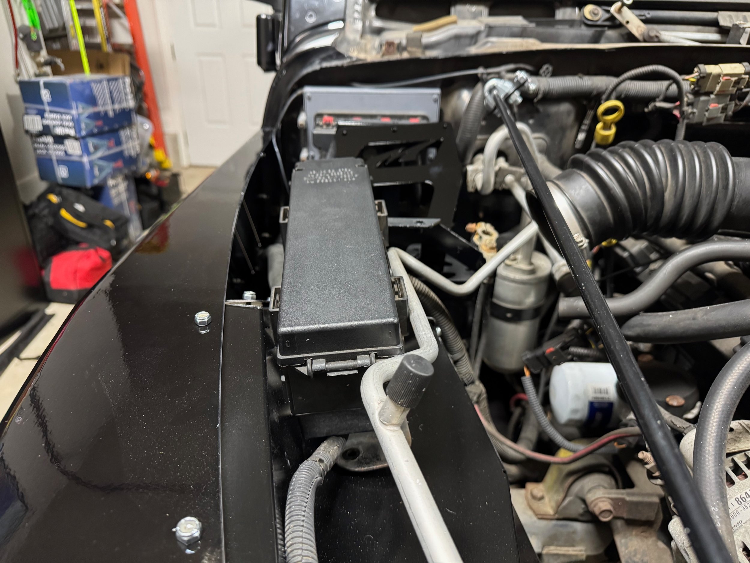

I think I have the PDC figured out, I pounded the legs flat, and cut off the rear one. Paint was still drying last night, but should end up like this:
These are the Motobilt Aluminum 0"s.

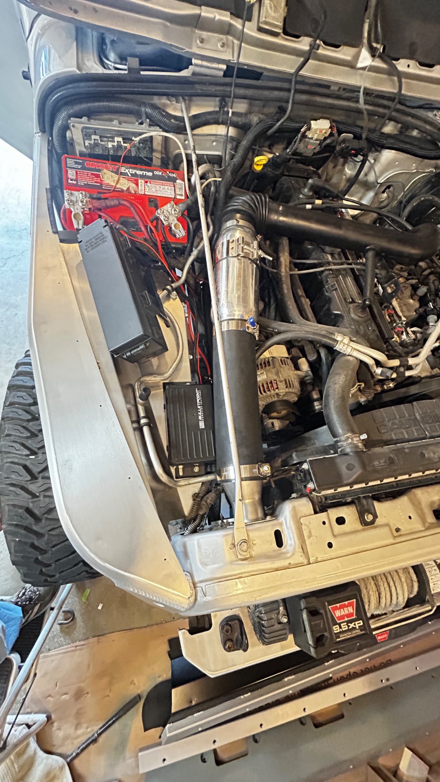

Similar but slightly different than what I did. Either way, it works, though I fiddled with my AC lines and now they look like crap! I’m re-working the entire battery area now, so it won’t be all jumbled up. New cables, moved the PCM up and back on the firewall. I have some more room now between the battery and the PDC.
