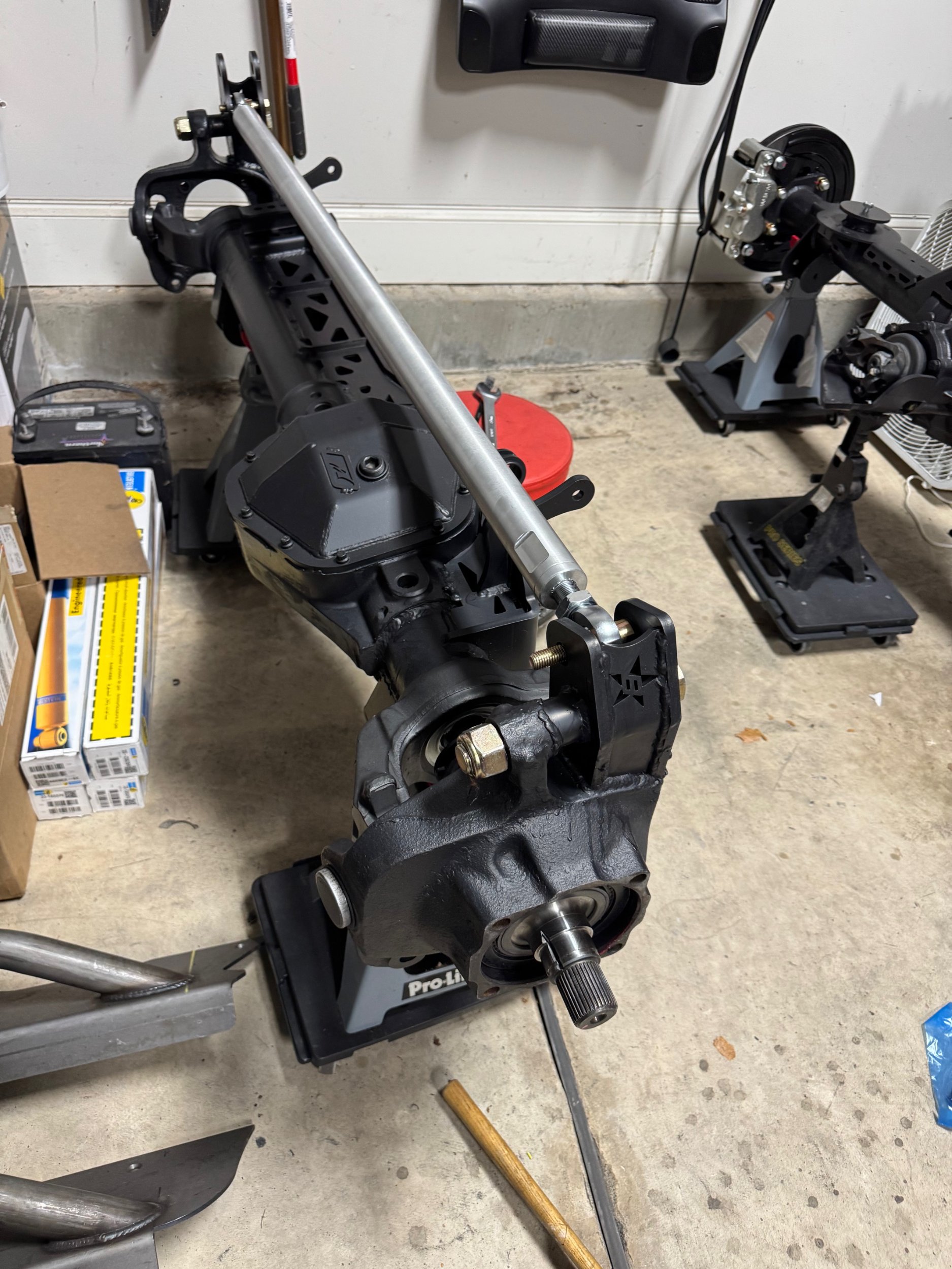

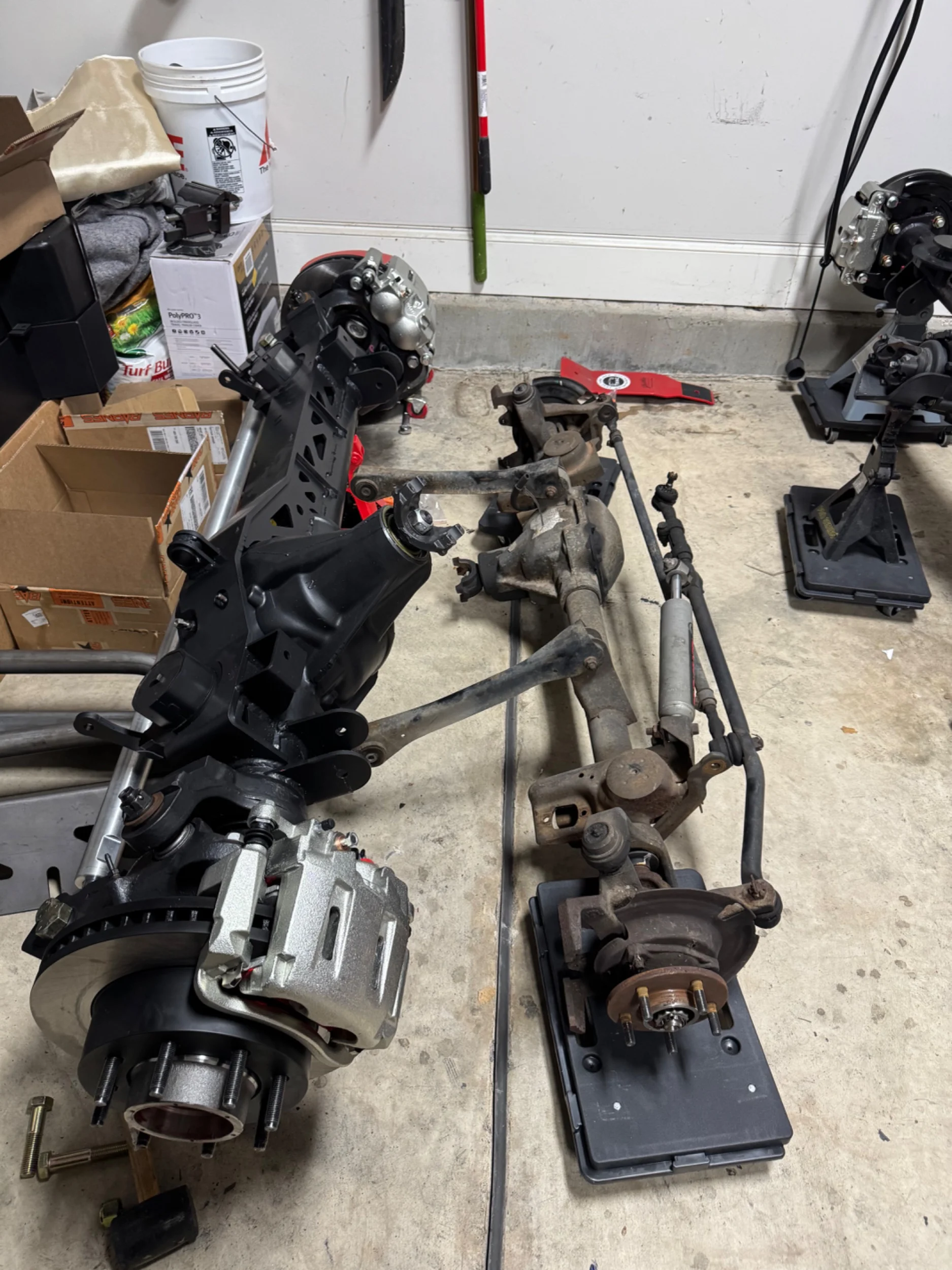

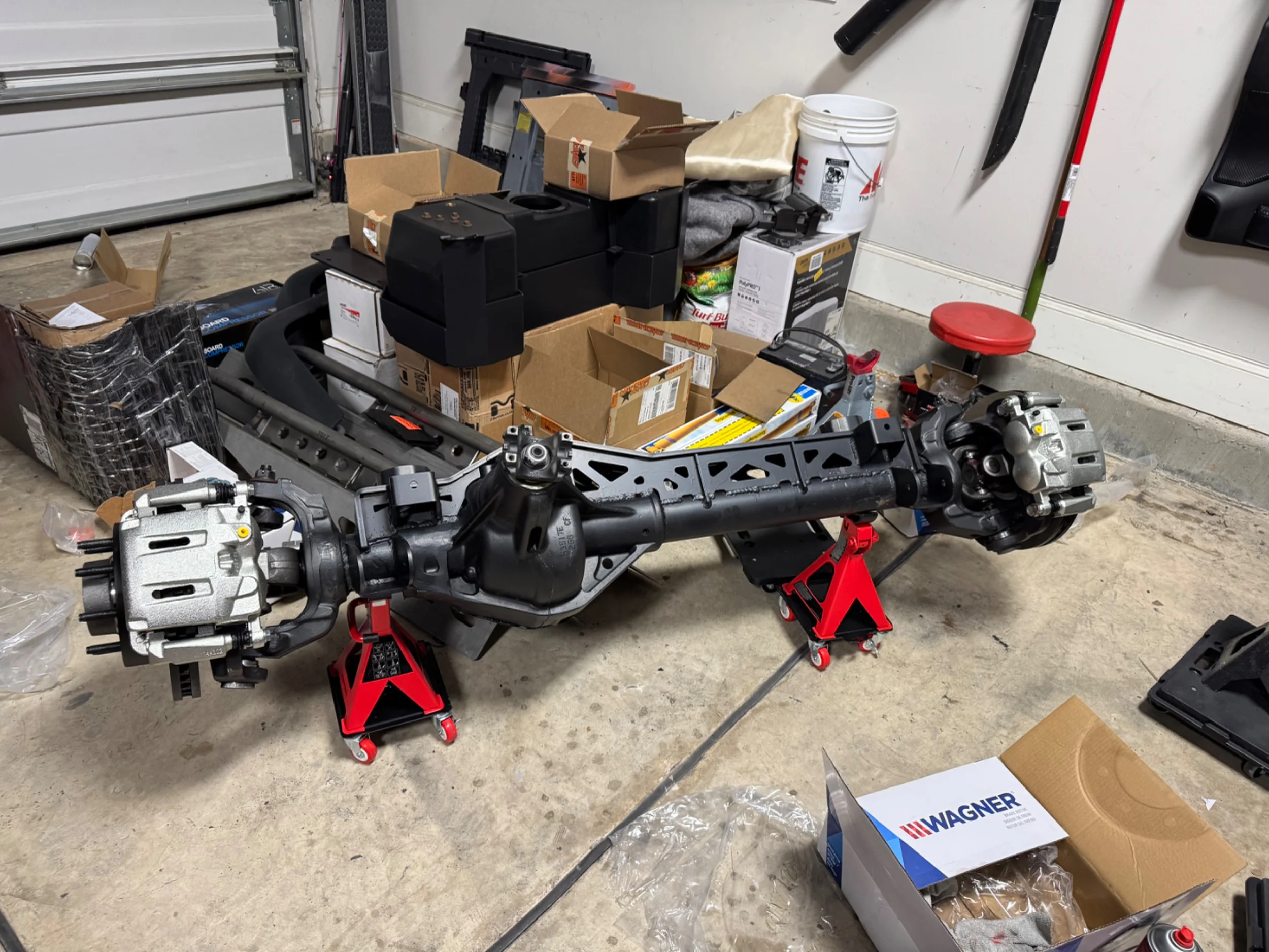

Here's how the front axle ended yesterday. Got frustrated trying to stab the driver side shaft.

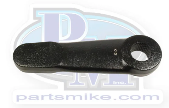

Who makes longer pitman arms? I don’t think I have enough throw for the high steer with the stock one.

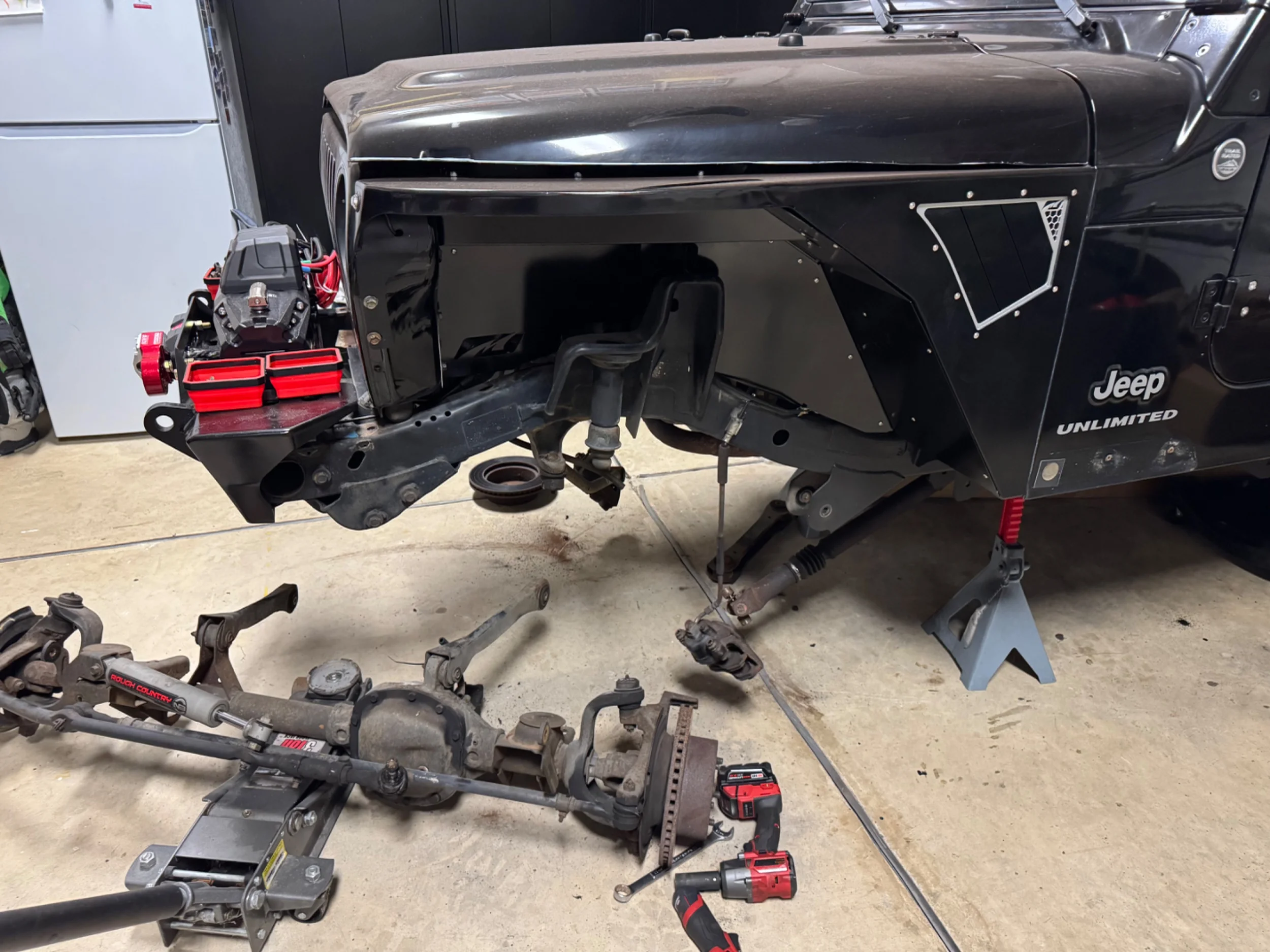

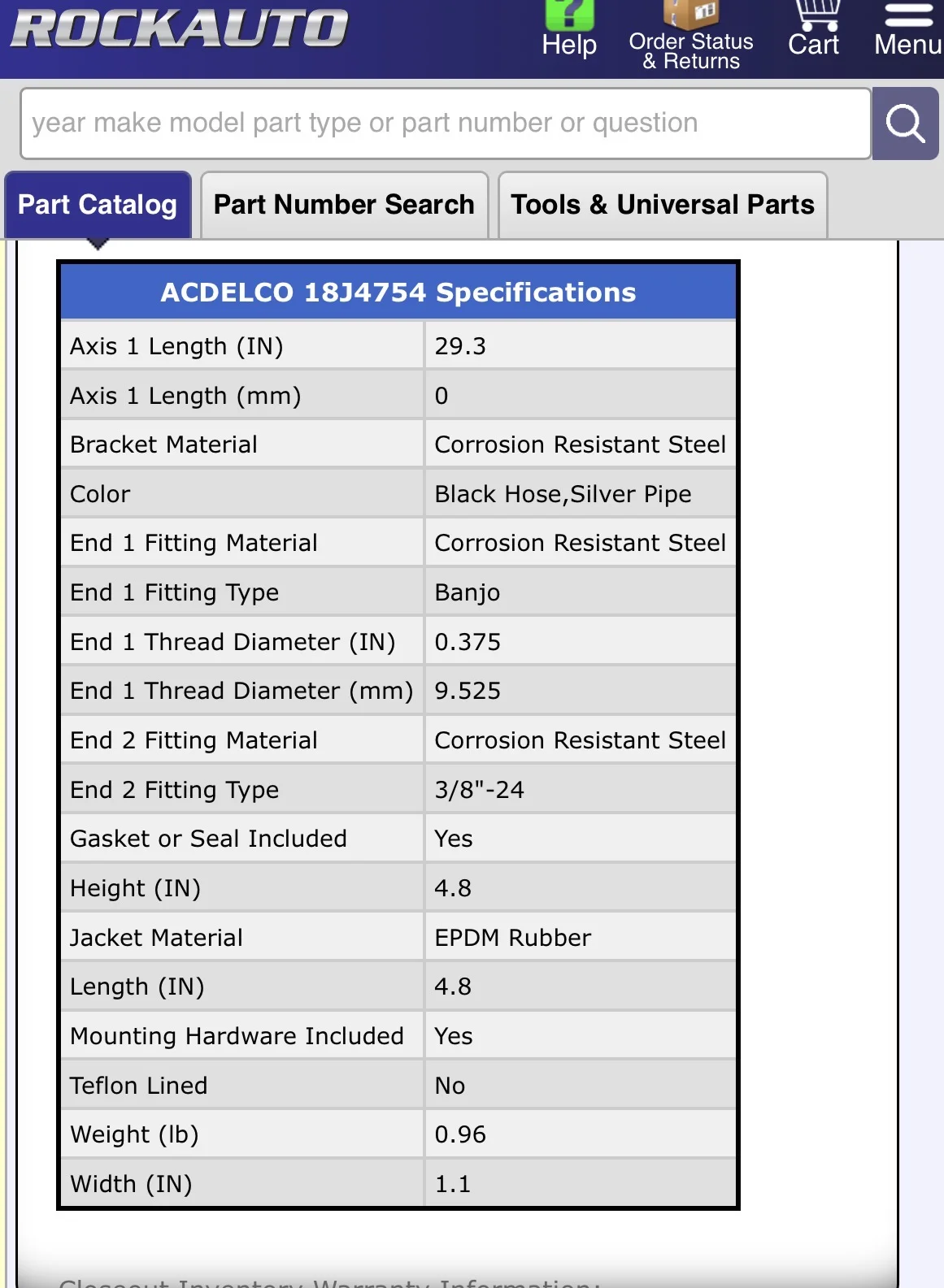

I'm gonna call that 1 brake line down! 🤣

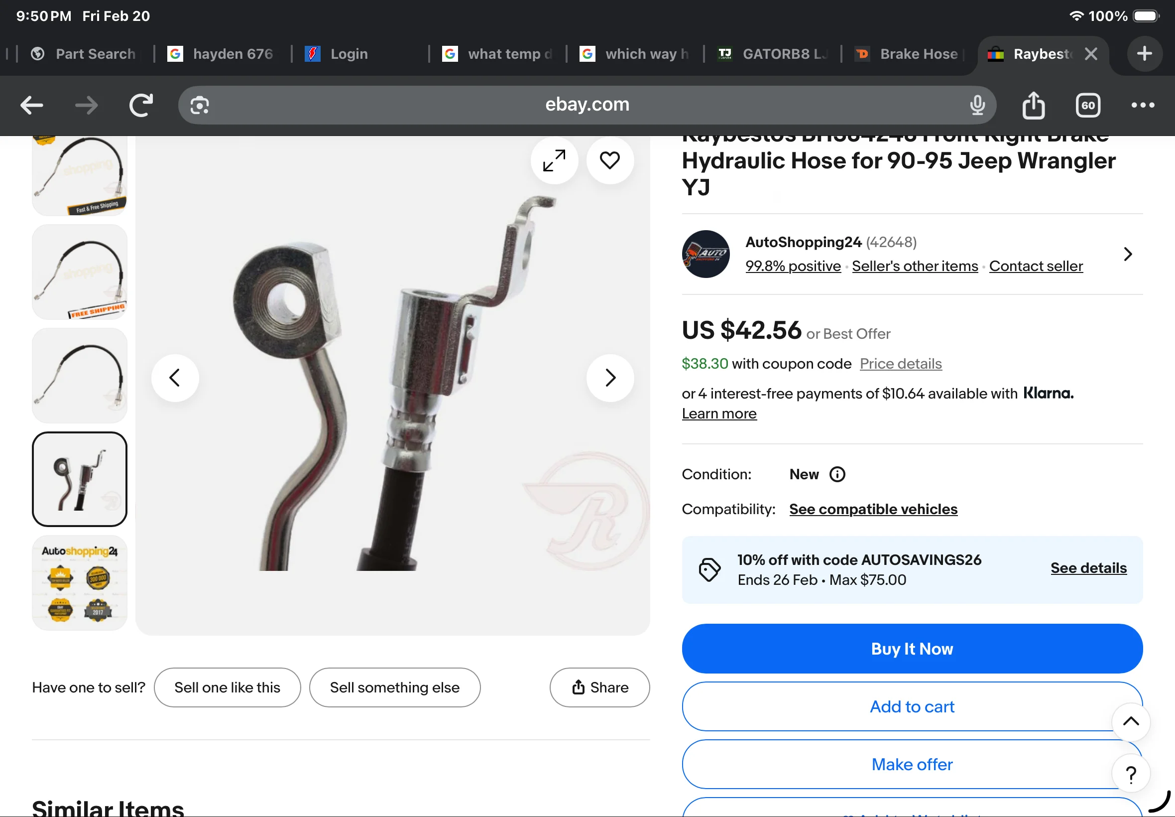

Dorman has some good lines for 4" lift. Don't do the YJ lines!
Haha, these would never make it anyway. I figured this way I don’t have to clean up brake fluid right now.

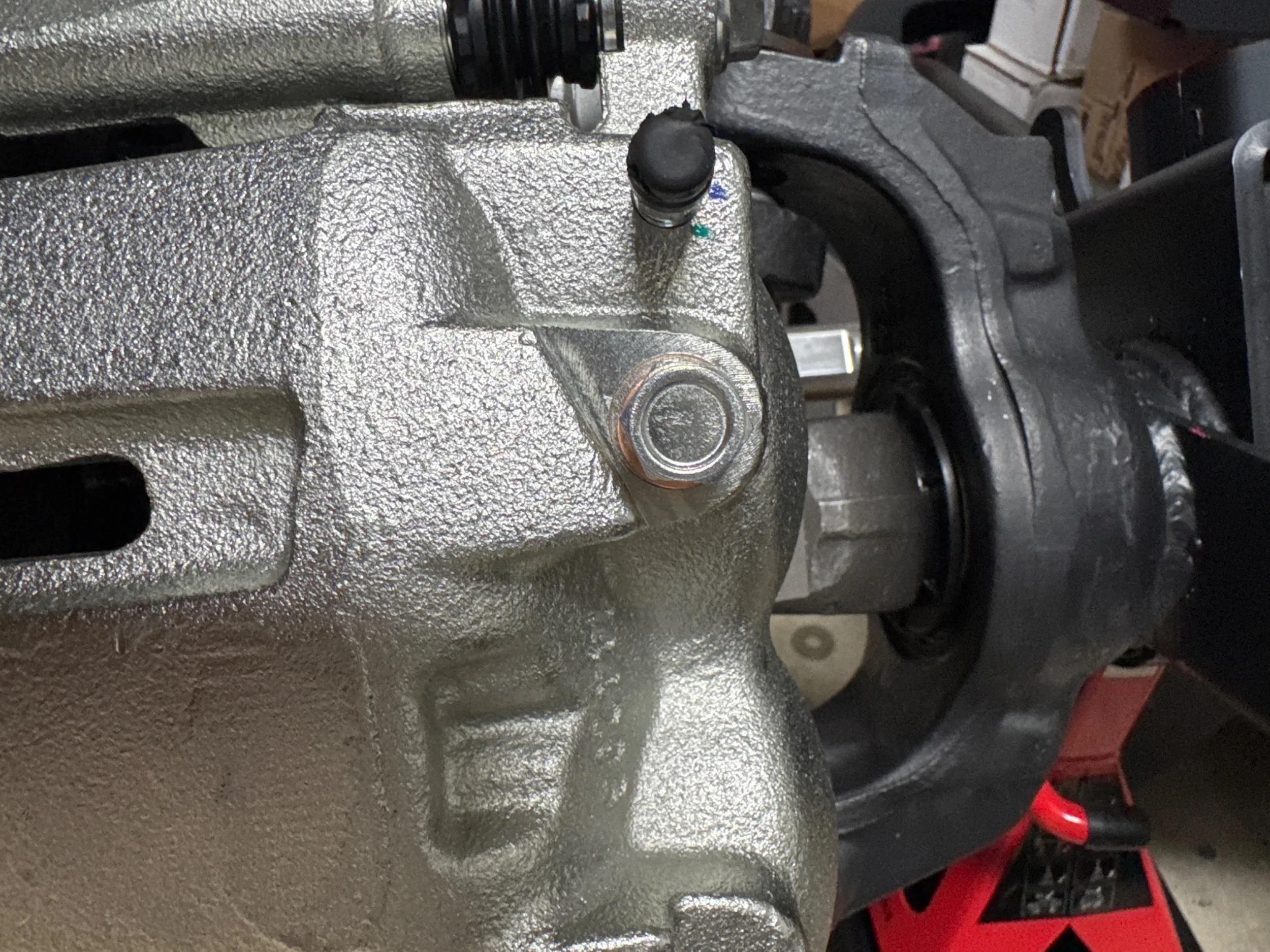

I would imagine different banjo fittings on the caliper ends too... I had mine custom made when I built the Jeep the first time.
That is what I was thinking. I’ll be at Oreillys tomorrow, hopefully they still do them.

Yet another drill bit on order, 5/8 for the cavfab TB double shear. To be honest, may have been easier to just get a weld on.
Also ordered a 3/4 to drill whatever pitman I end up with.

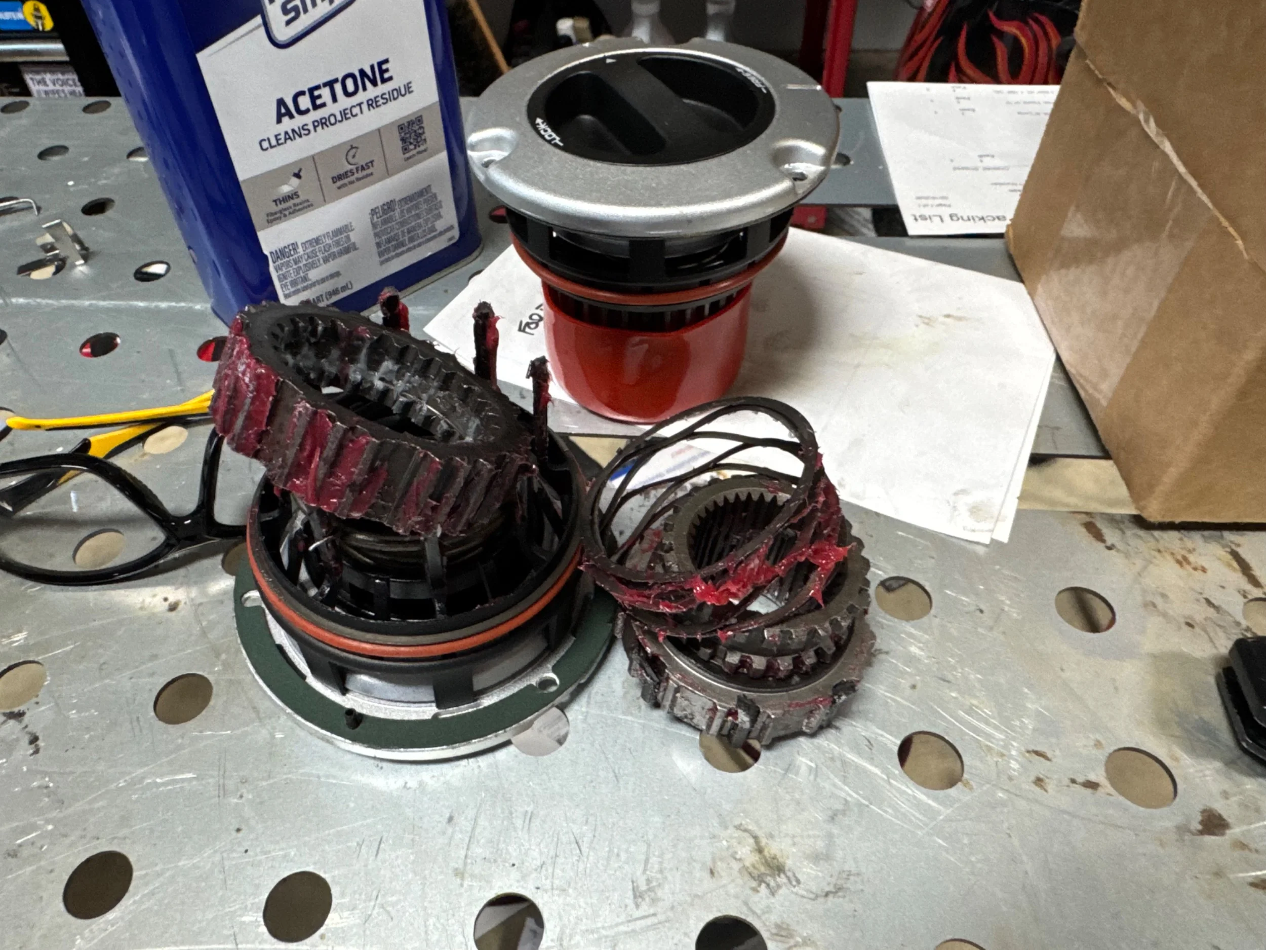

BTW, tried to save money on hubs, cheap ones didn’t survive install. Bad idea. Picking up mile markers tomorrow.

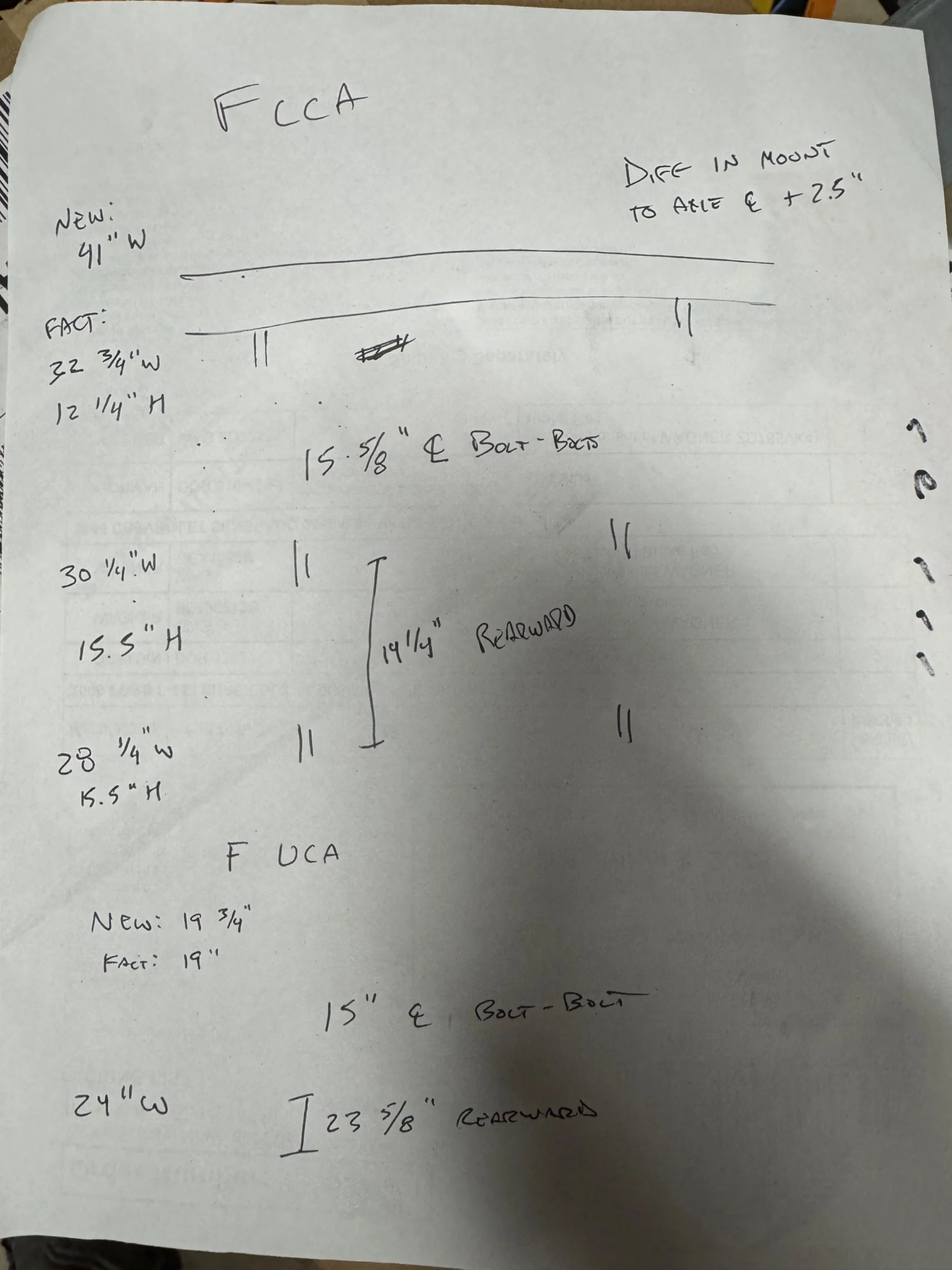

without rollers, I can’t really set the front axle on the angle I want it. Gonna have to do some refreshing math to get some decent baselines for the front arms.

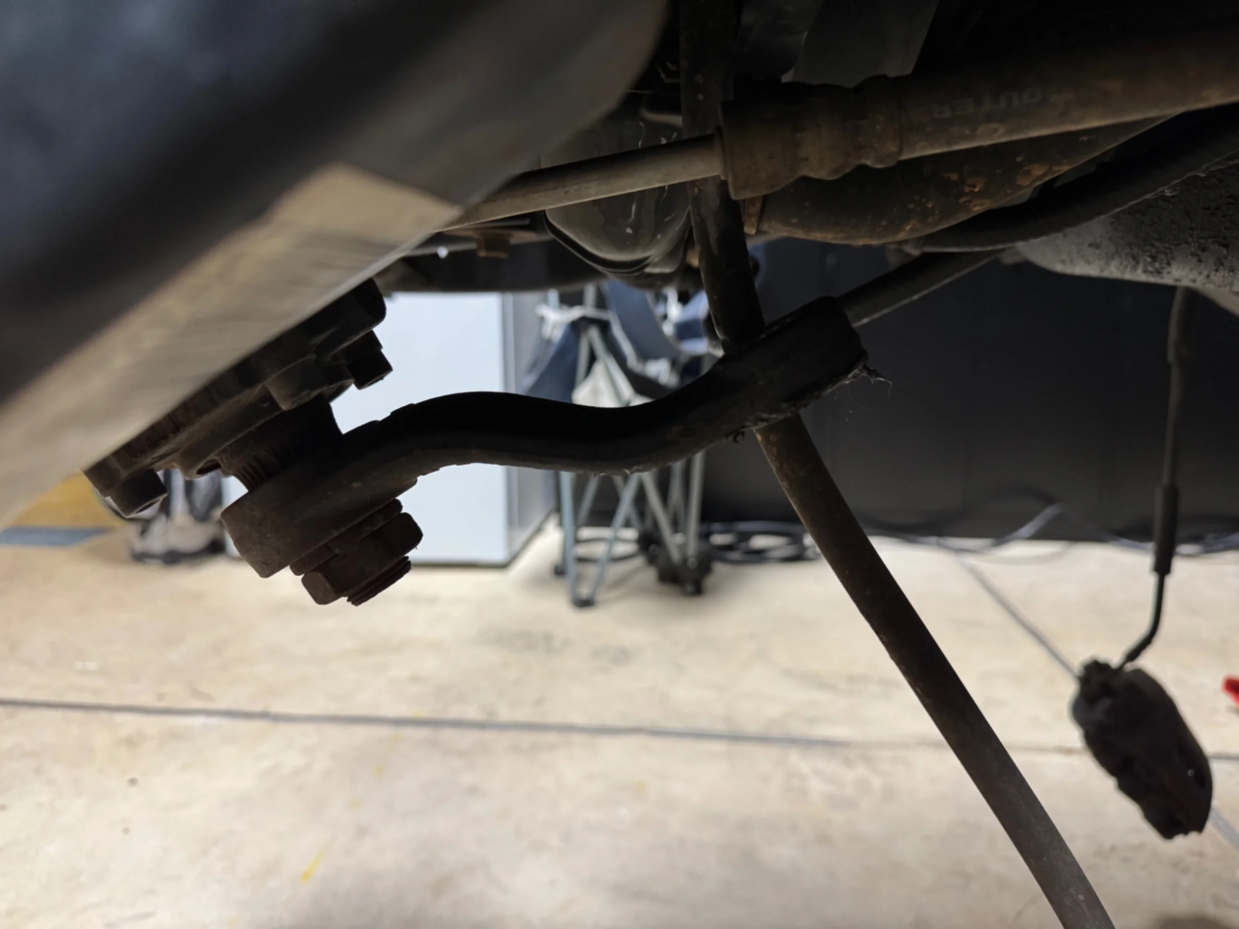

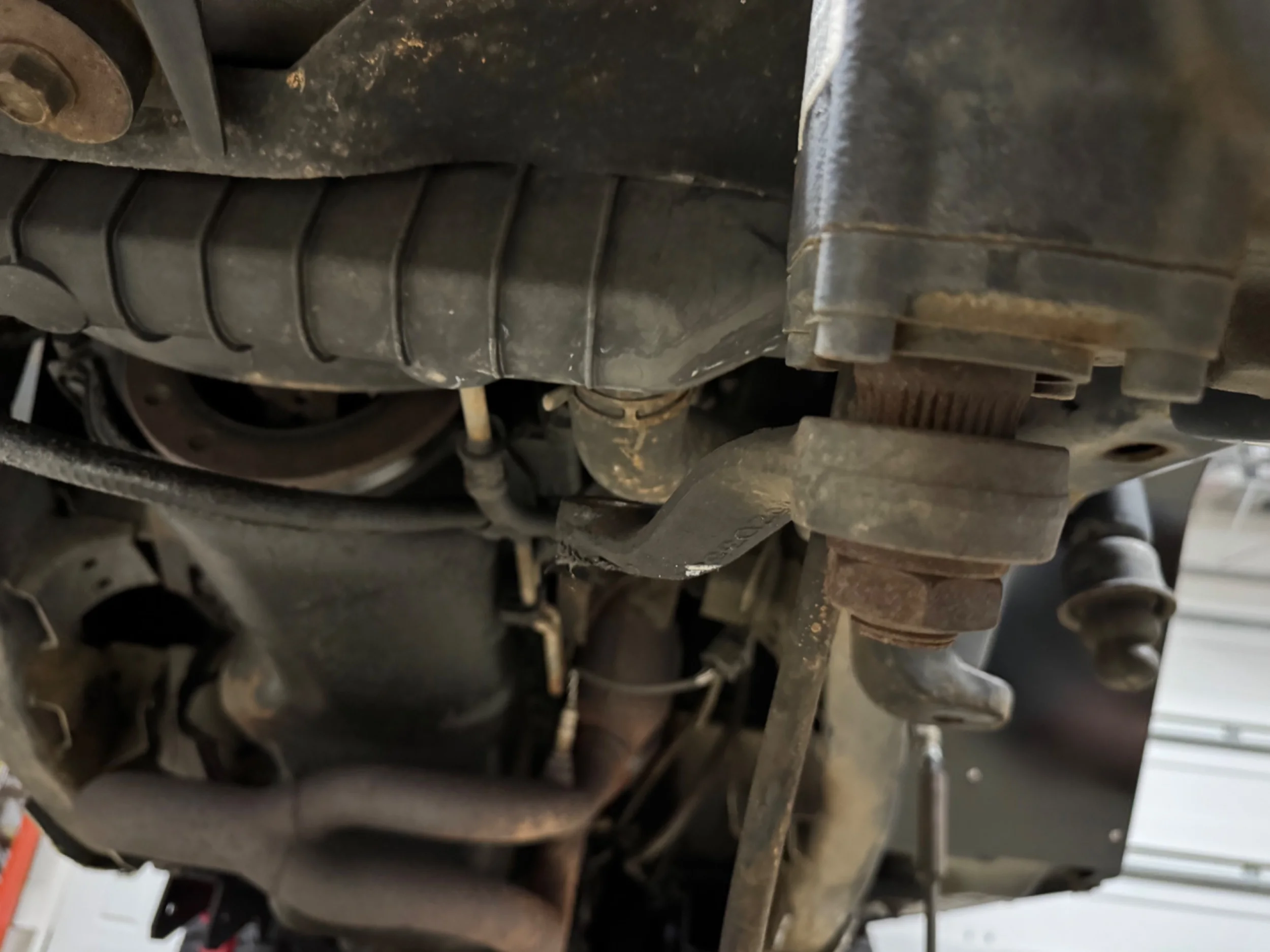

The YJ lines are clocked so they only mount in one position. I had to shave down one of the round sides so I could put them in the orientation that worked best for me. That’s why I recommend the Dorman H622065, H622066.
This pic shows the problem with the YJ. It can be fixed, but why?
Reactions: GATORB8
Interesting, the F250 calipers are keyed also, may work.
