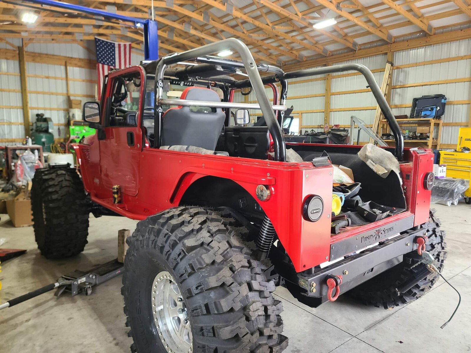

In other news, Willie mounted my fenders and inner fenders today. He works nights so he tinkers in the shop a little during the day. Can’t wait to go play in the rocks! So close!

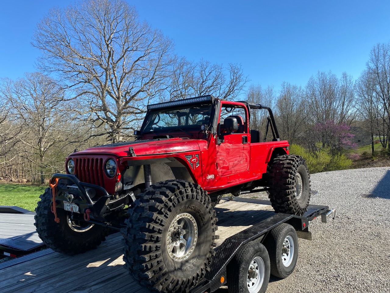

Well, it started. First time it’s moved under its own power since October.
Hustled today to get all the hard stuff done so I could take it come. Biggest hold up was the tailgate hinges I have won’t work because the armor isn’t cutout for them. I’ll get some flat cast hinges for it. Roll bar painted, seats installed, lights wired up (headlight, taillight, turn anyway), vents on tank and both diffs, loaded all my junk up and borrowed a trailer. Gets a muffler Monday, sounds like a derby car right now. It’s open header. Quick run around the neighborhood, it’s stable, rides great, locks up the brakes but at 3/4 pedal. Might need a bigger master. Still need to put the finishing touches on it. Hitting the trail in a couple weekends. So happy it’s home!

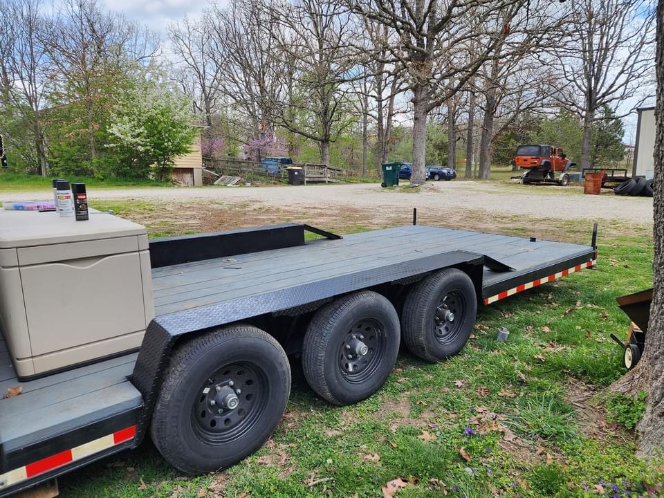

While we’ve been finishing up, I dropped my trailer at another buddies house who has a plasma table. He’s building me some drive over fenders. Should be done today.

Also picked up my trailer for a buddy who built drive over fenders for it.

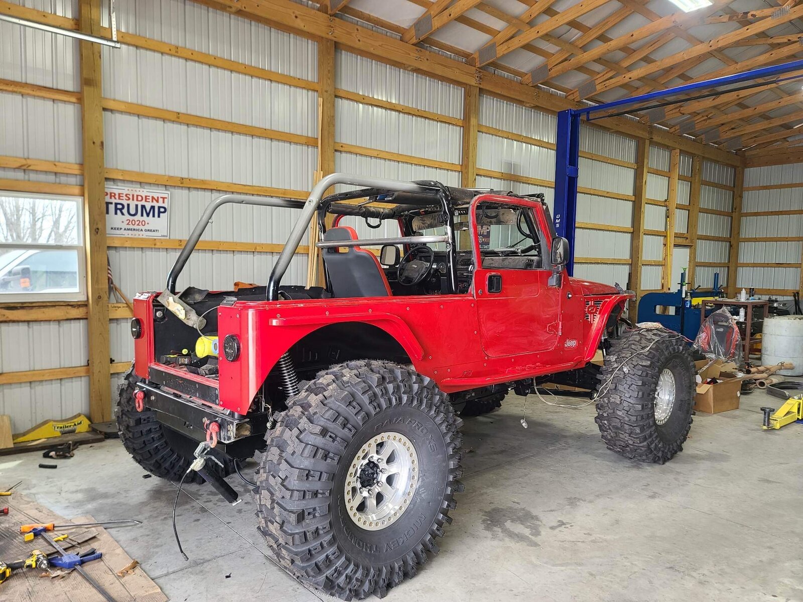

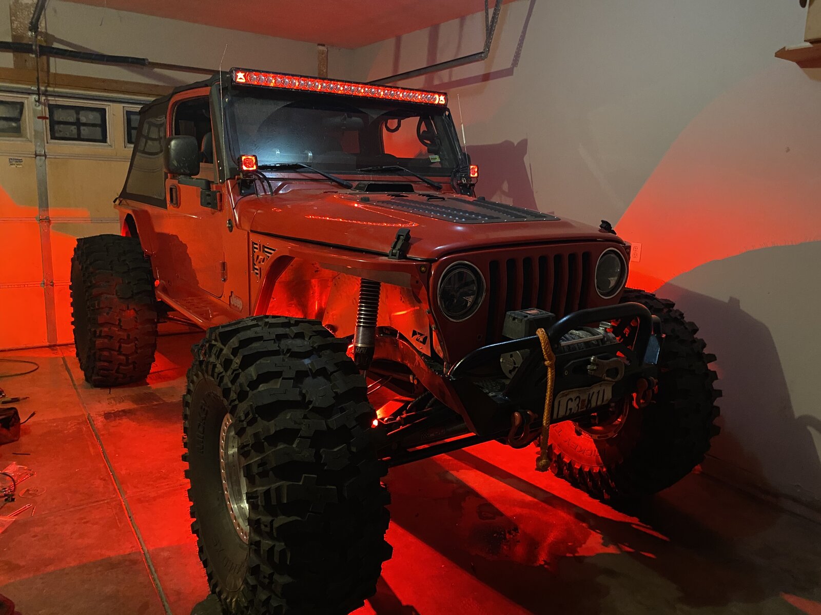

Almost there. Got the SPOD installed and the compressor mounted in the rear on the fender well. Ran wires, hooked up rock lights, cubes, light bar, compressor, started on heated seats. Replaced air filter and did a quick fluid check.
Power washed floor mats and soft top, vacuumed interior, reinstalled carpet and top. Still need tailgate hinges, should have them tomorrow. The list grows short.
