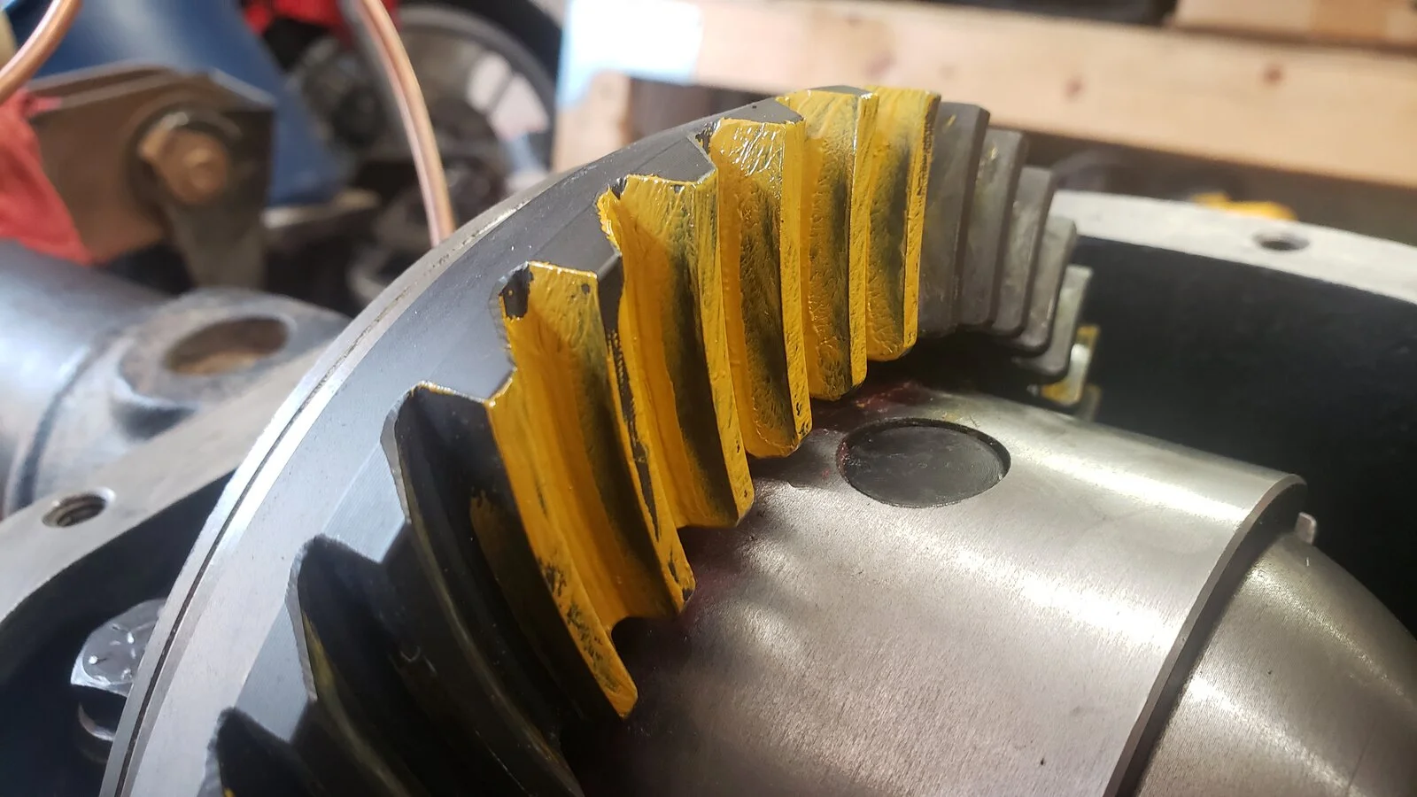

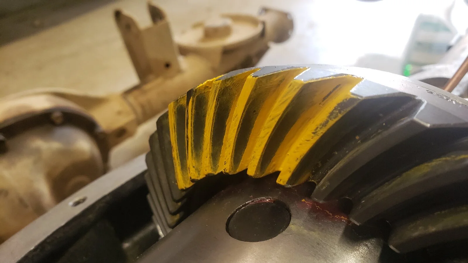

danleym New Member Joined Feb 10, 2019 Messages 12 Location Colorado Jun 16, 2021 #1 Anyone able to offer some feedback on this? Dana 30 front out of a TJ. I'm thinking about adding 0.005 to the pinion shim? BL is 0.006. Thanks!
Mrhp TJ Enthusiast Joined Dec 24, 2020 Messages 291 Location Michigan Jun 16, 2021 #2 Yes, needs to get deeper in the tooth Reactions: ColoJeep
