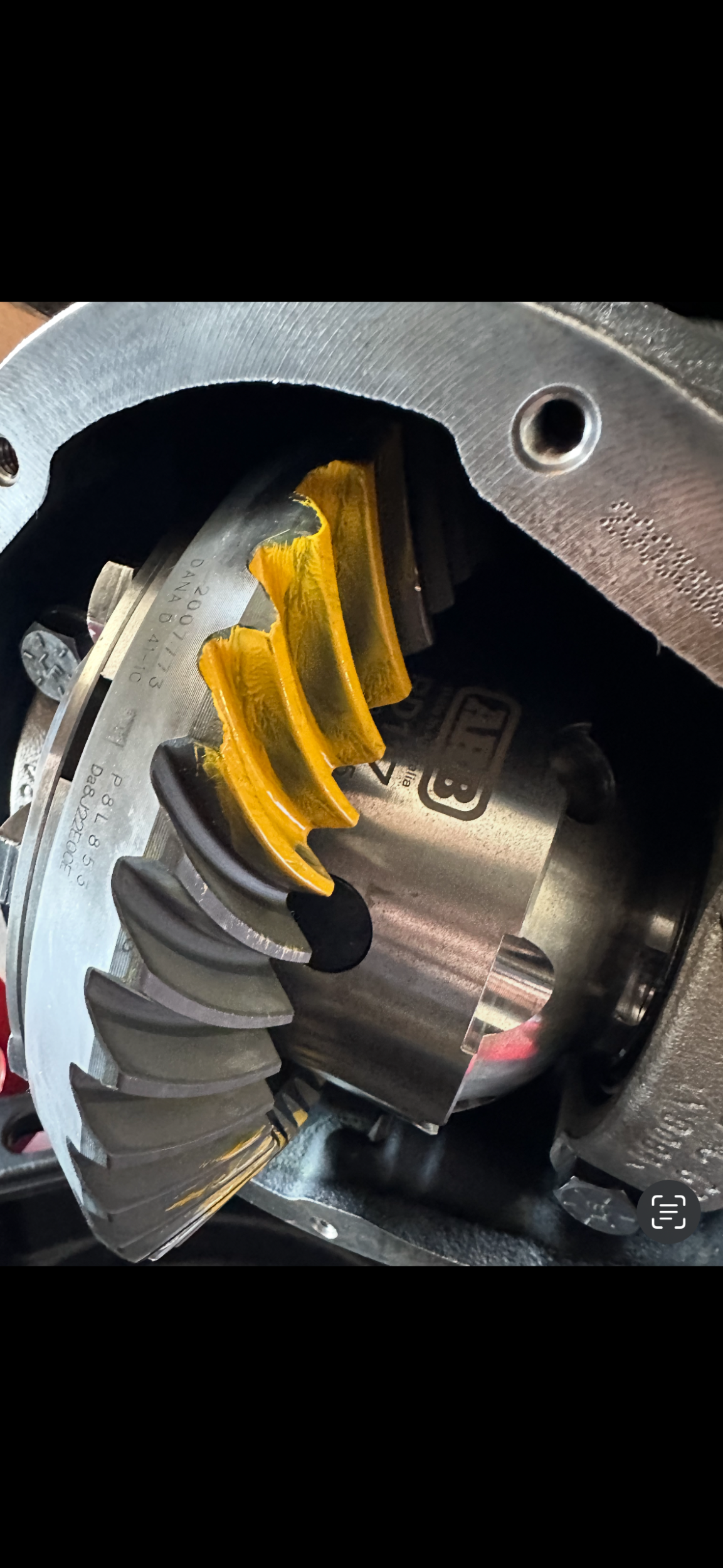

I tried multiple different setups using new set up bearings changing pinion depth and carrier preload and this is the best pattern I have been able to get. Was curious if anyone else who has setup Spicer OE gears has gotten a pattern similar to this. Not very pretty compared to the Gear pattern chart spicer offers.

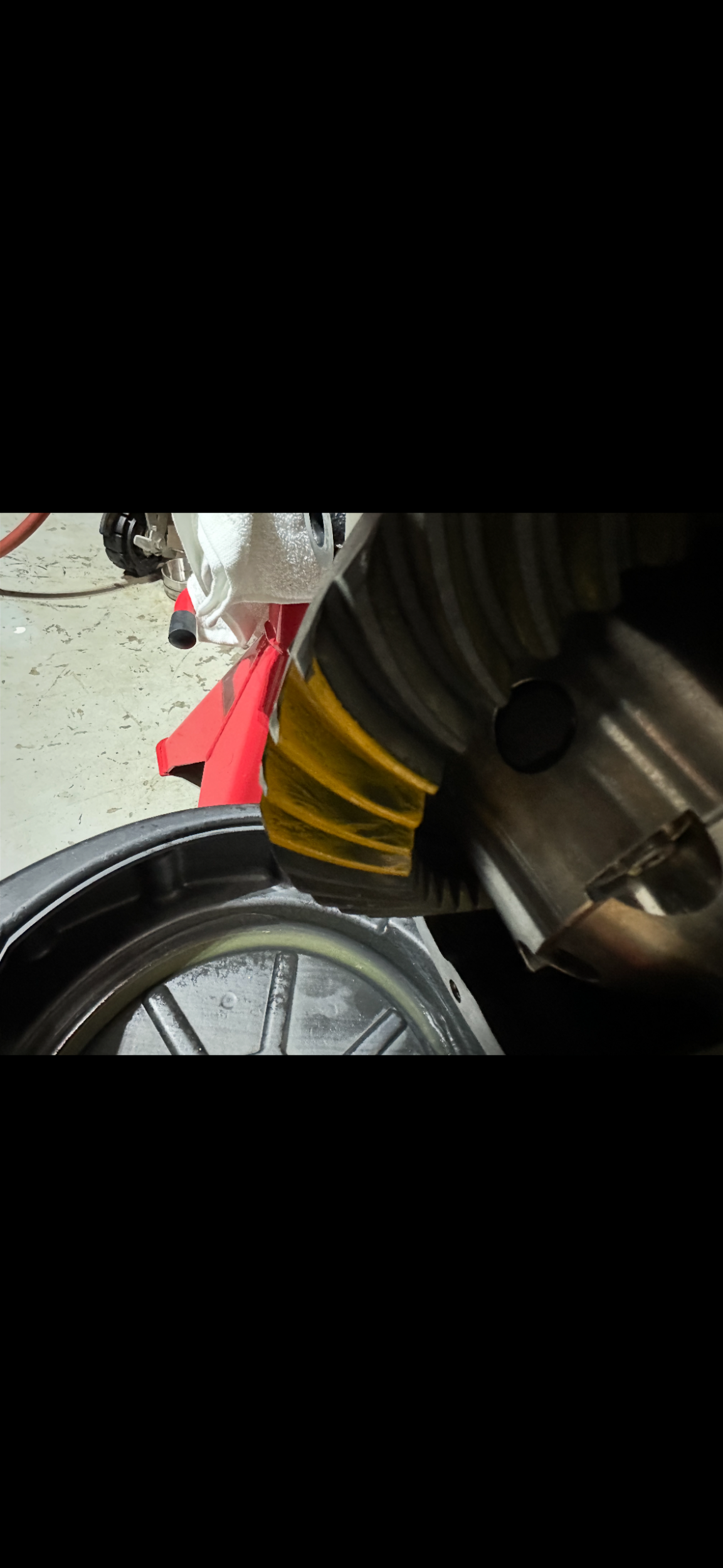

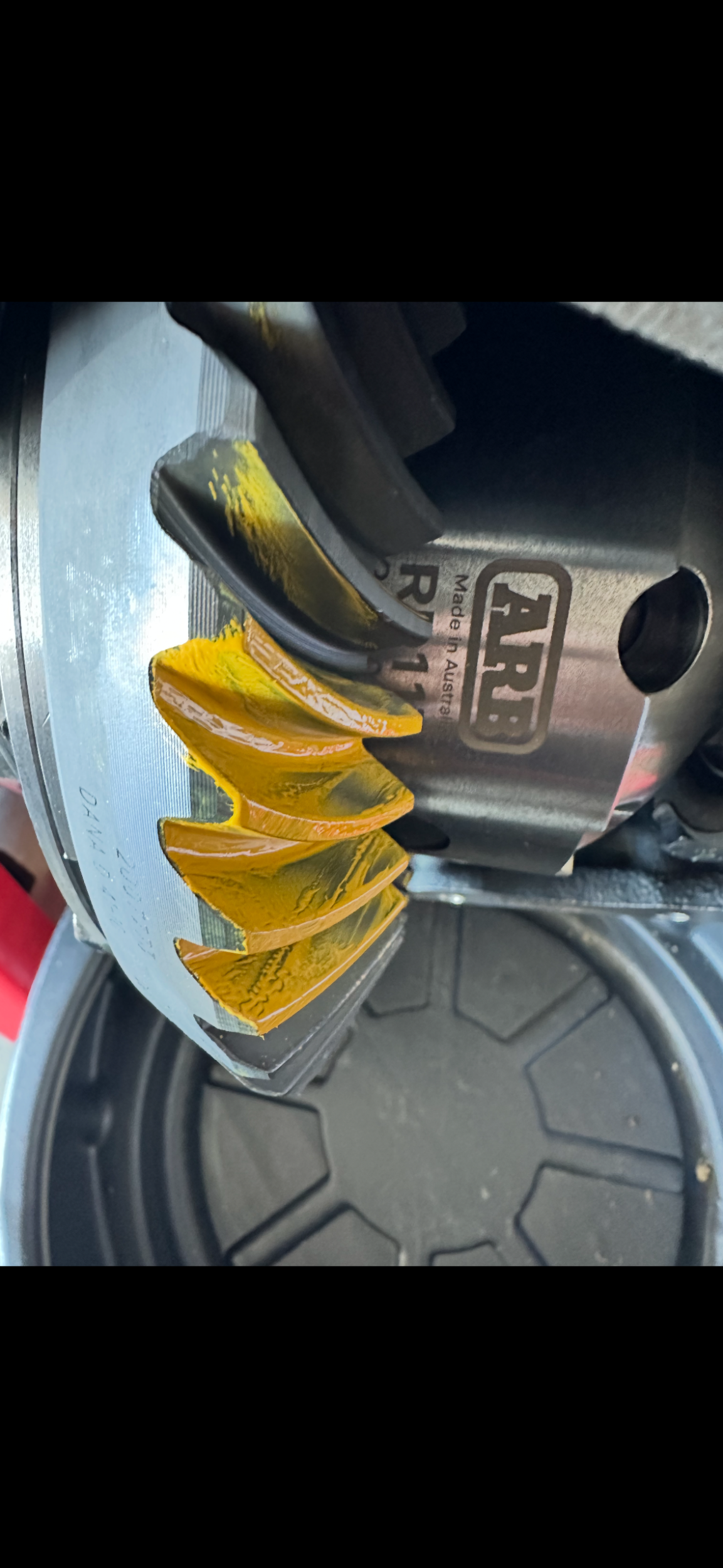

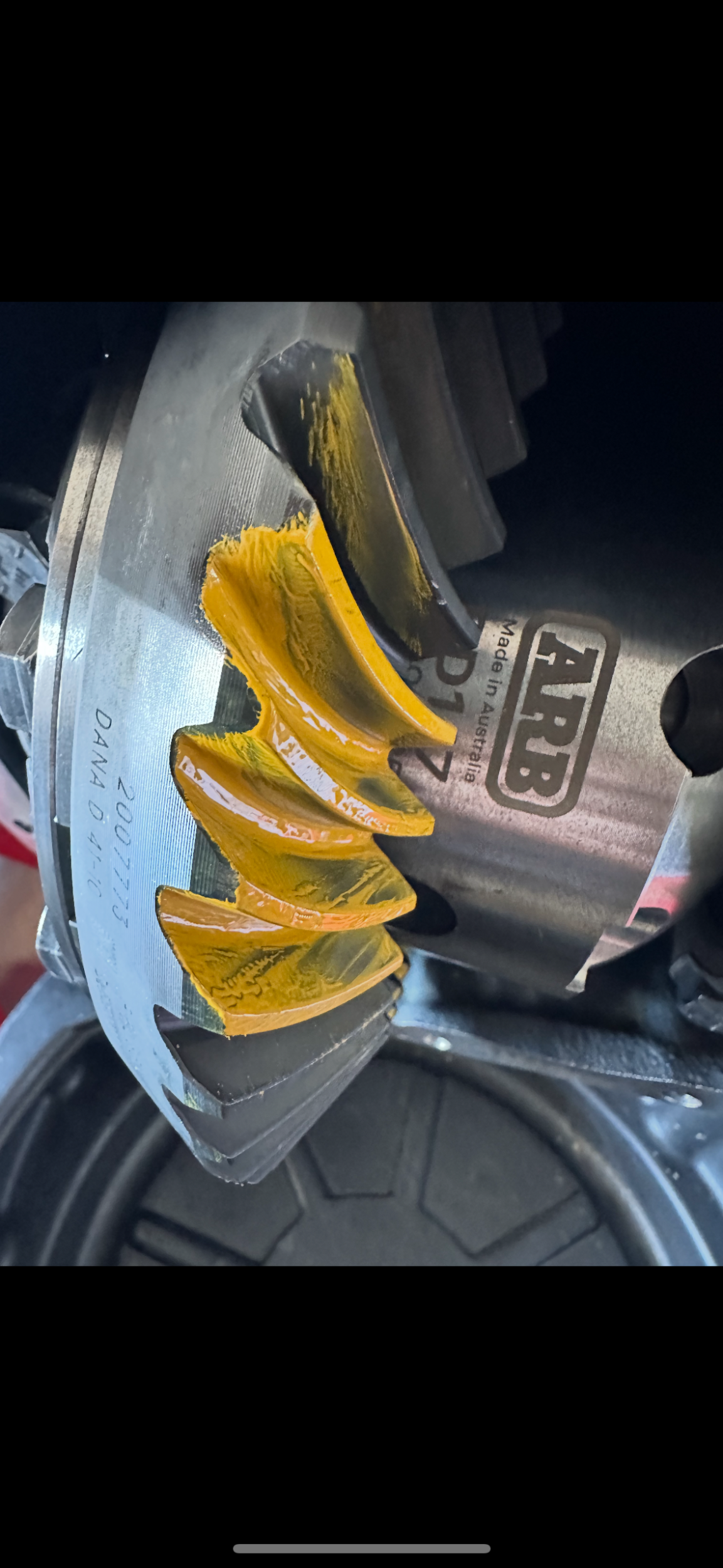

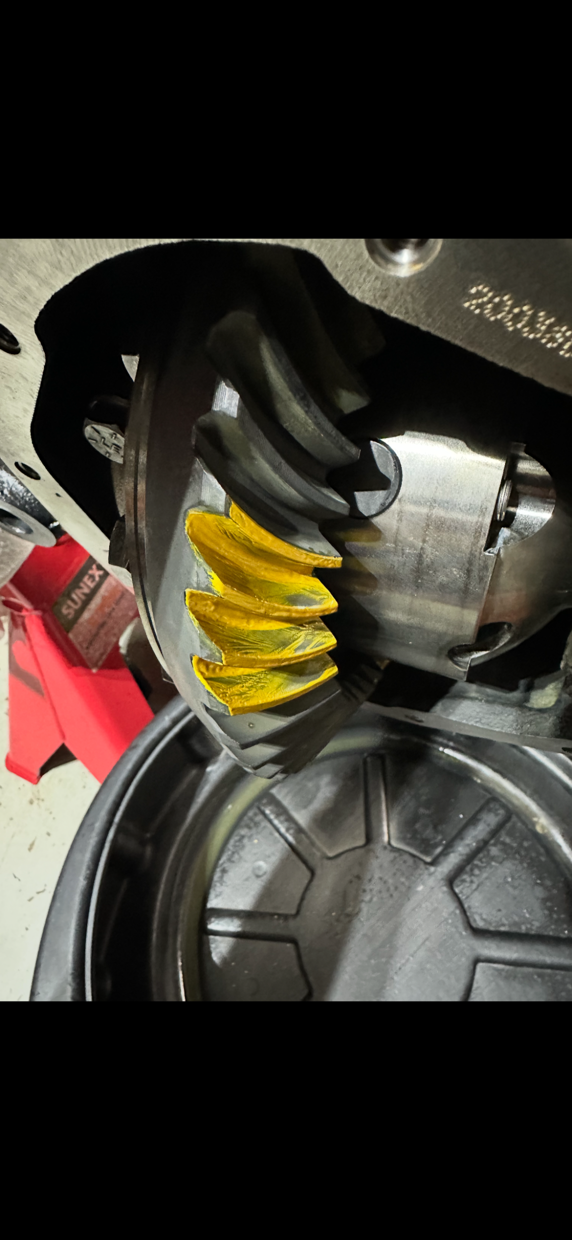

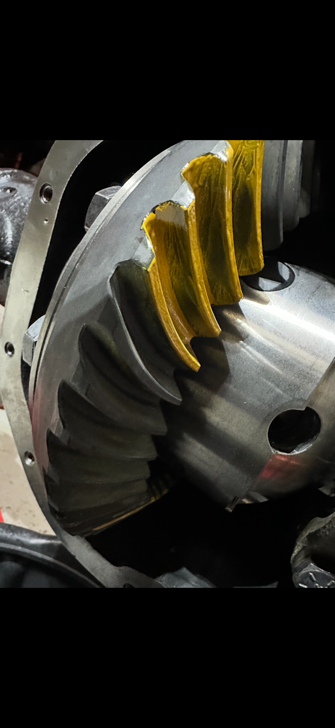

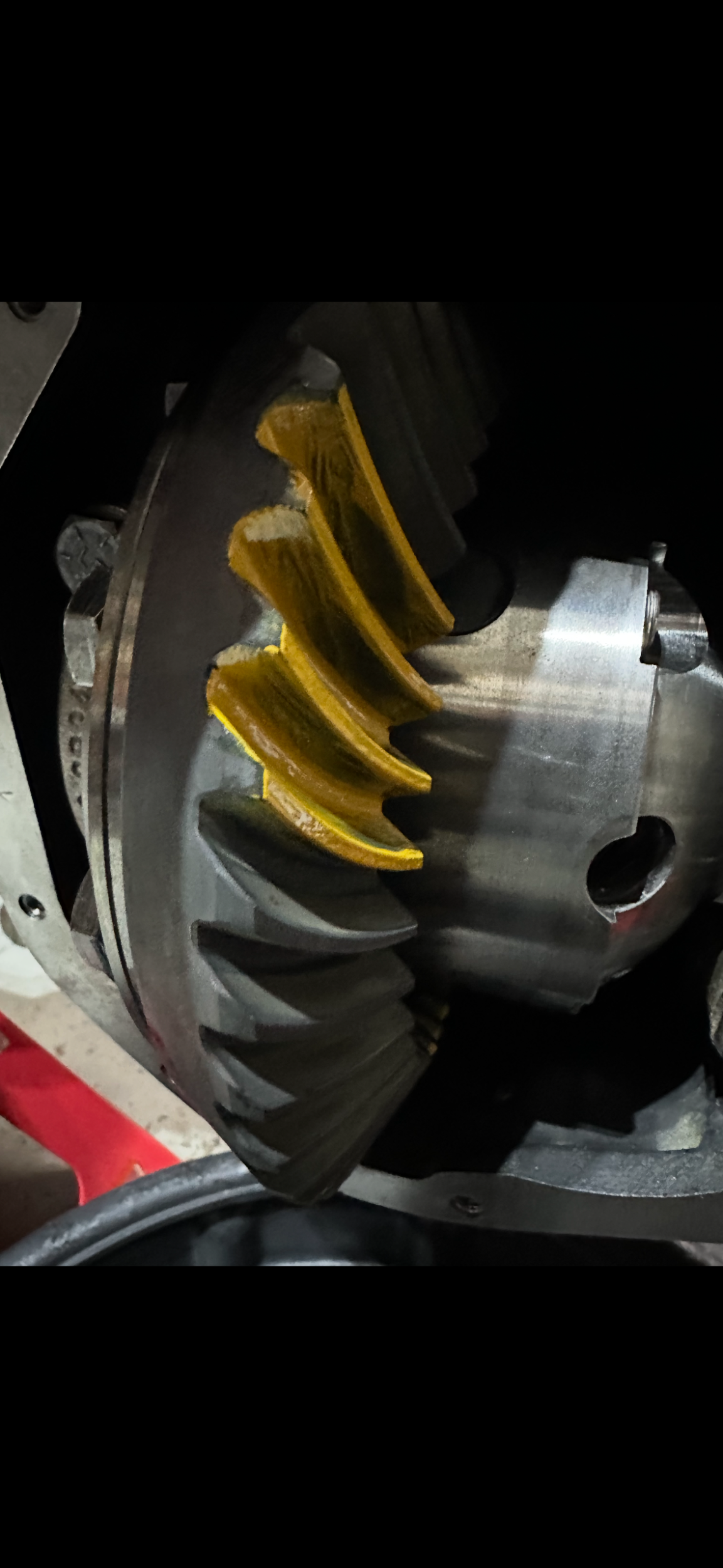

Thank You for the reply. Here are somethings I forgot to mention in original post:
First off I started with all new set up bearings and did many different mock- ups with various different pinion shim thicknesses. I landed at the 0.048 Pinion depth because that is what seemed to have the best pattern ( but like I stated still not anything like the spicer gear pattern chart.)

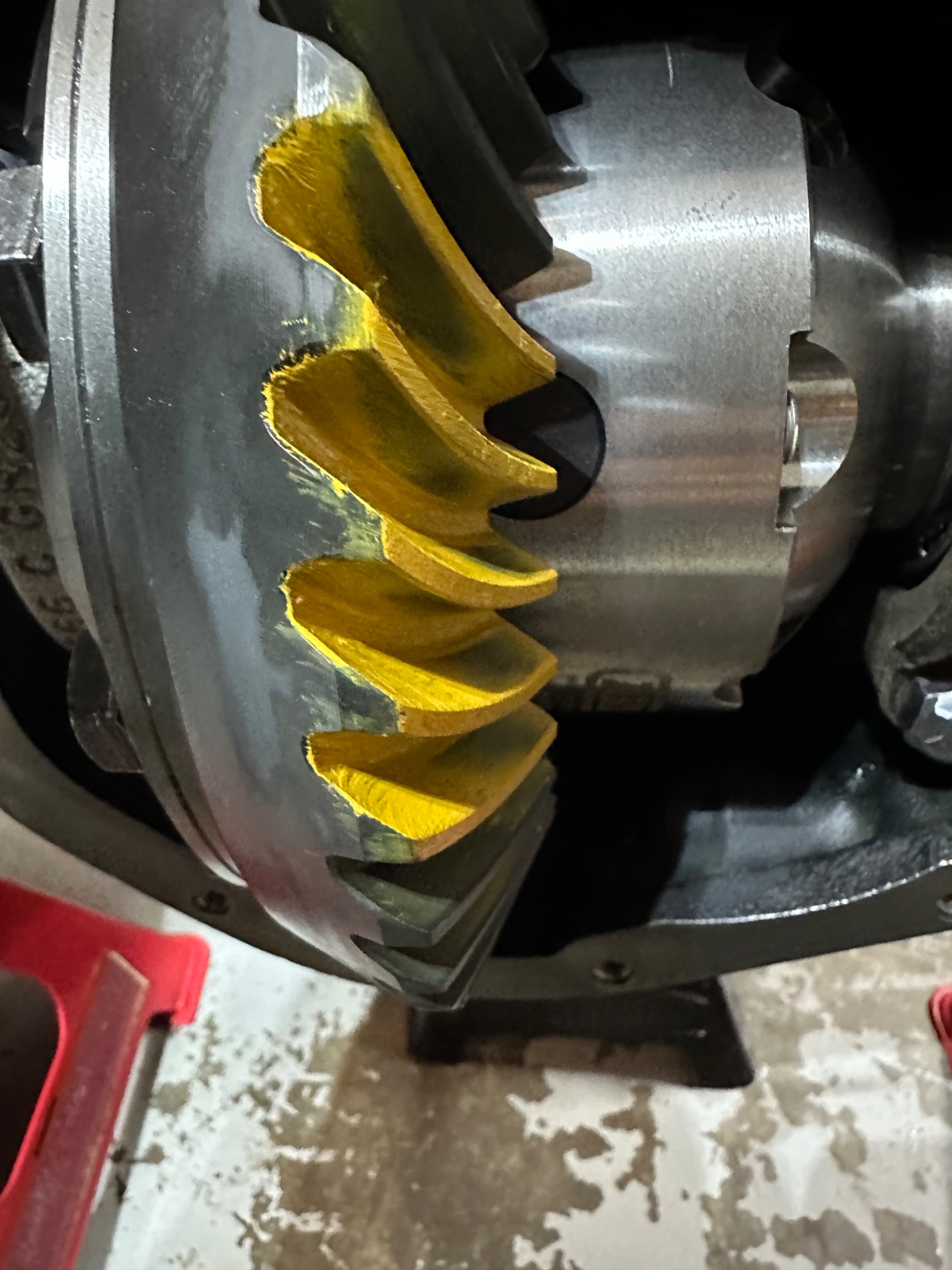

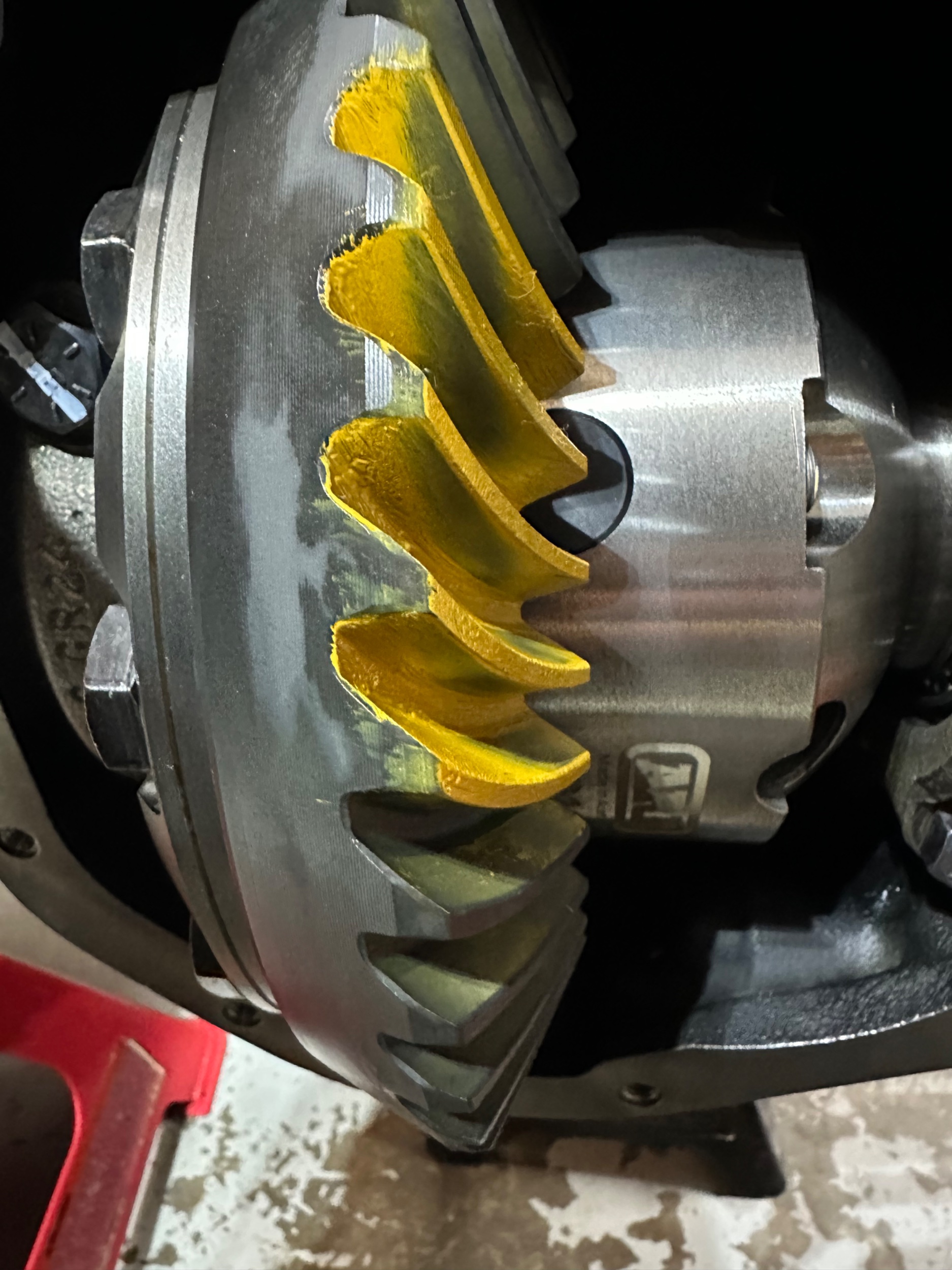

In these pictures I was going for my final install thats why crush sleeve eliminator was installed. All New bearings and races have been installed the only thing that is old here is the ARB seal housing and thats because I wanted to run a pattern with the old one I have without copper line so i didnt chance breaking the new one. Housing was cleaned thoroughly no shims were bent or out of place i confirmed that. And yes i did use a deadblow hammer along with the case spreader to confirm carrier is fully seated in housing.

Ok good. The carrier bearings just get pressed on, no need for setup as they don't need to come off. With the method you chose, the only set up bearing needed would be the pinion head bearing. Sounds like you have a handle on it then.
With the pics you have posted, the two patterns are distinctly different in size and shape. That doesn't mean they are bad, just different.
Looking at your coast side first, the pattern is over toward the toe, but it doesn't run off which is good. It's more round rather than oval, but you can see where it wipes paint off toward the center of the tooth which is good. The coast side pattern has good diffusion but it looks slightly deep to me.
Looking at the drive side, it looks more oval and it also has nice diffusion. The pattern tapers up toward the top heel, but not off of the heel which is good. The right side of the pattern has the nice roundness on top and bottom which tells me the depth is good.
Since a low pinion rear axle uses the drive side of the gear, we want to favor the drive side. Luckily your drive side is the better of the two patterns. With what you have shown me, I would say this is an acceptable pattern to run. Anytime somebody asks me to read a pattern, I always ask for the shallow and deep patterns to ensure we are where we want to be. Anytime I see a weird pattern like yours I always want to ask the questions I did before commenting on the pattern to ensure all variables have been accounted for. Good job.

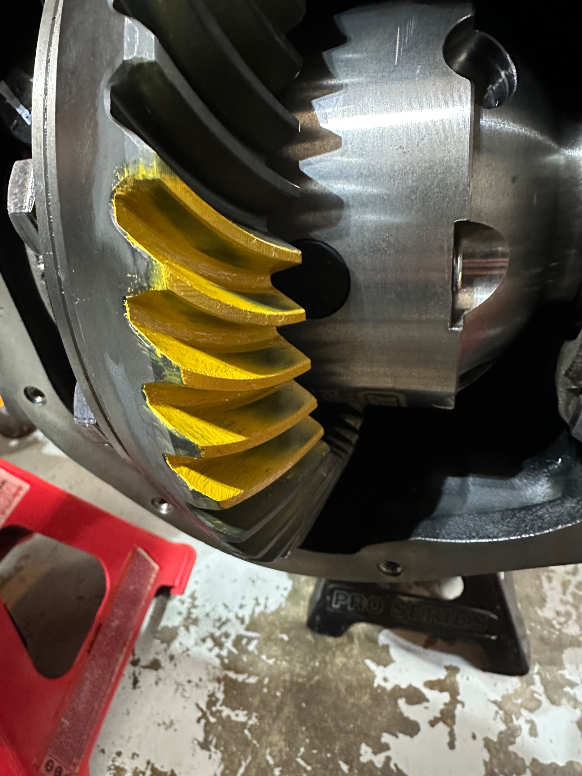

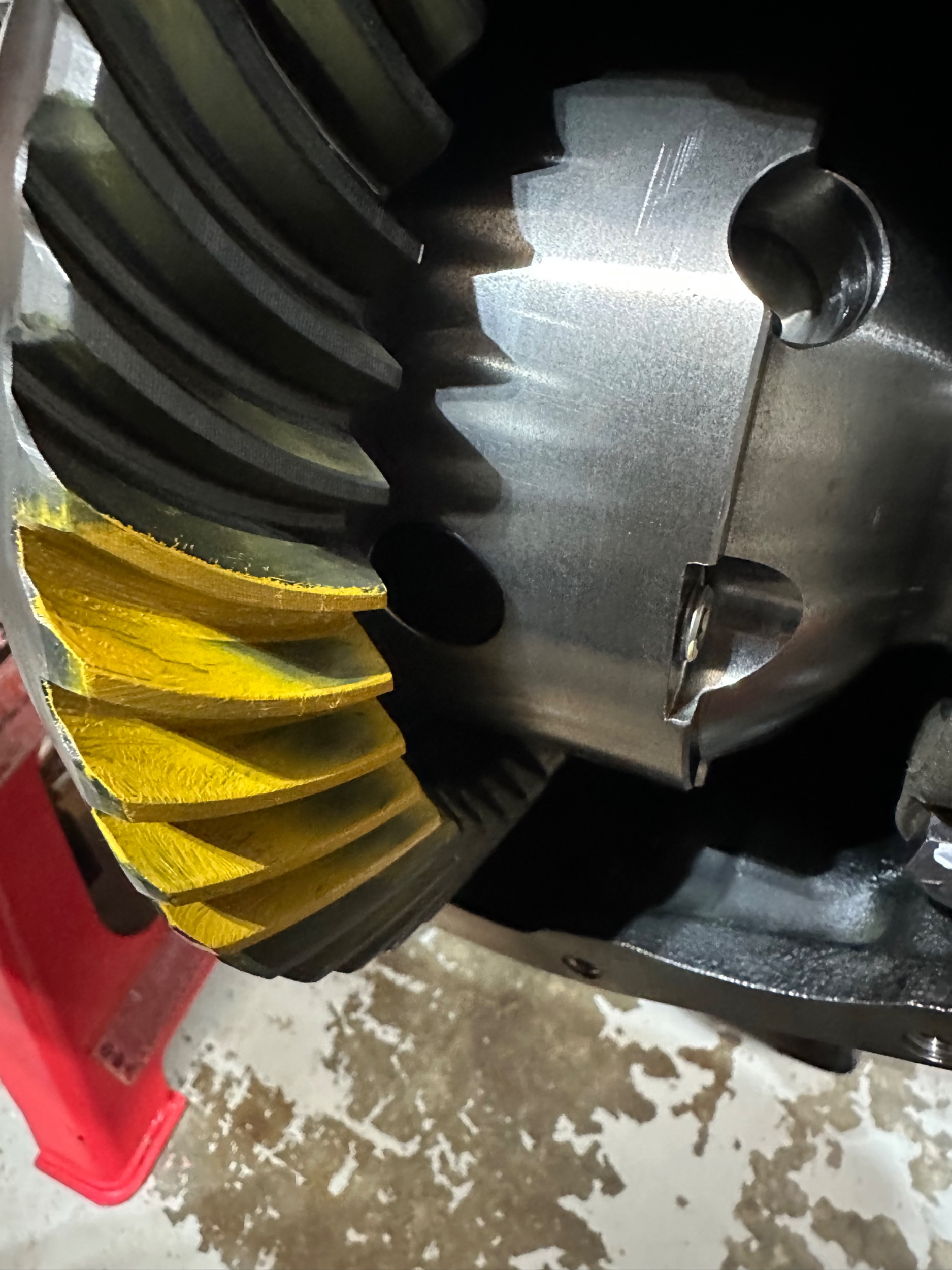

Thank you for your help sir. I was just going back thru some of my trial setup photos and wanted to include them.
Pinion Depth:0.049
Carrier shims were the same
Backlash:0.005-0.006
I know marking compound was a-little to thin in these was still learning the compound to gear oil ratio!

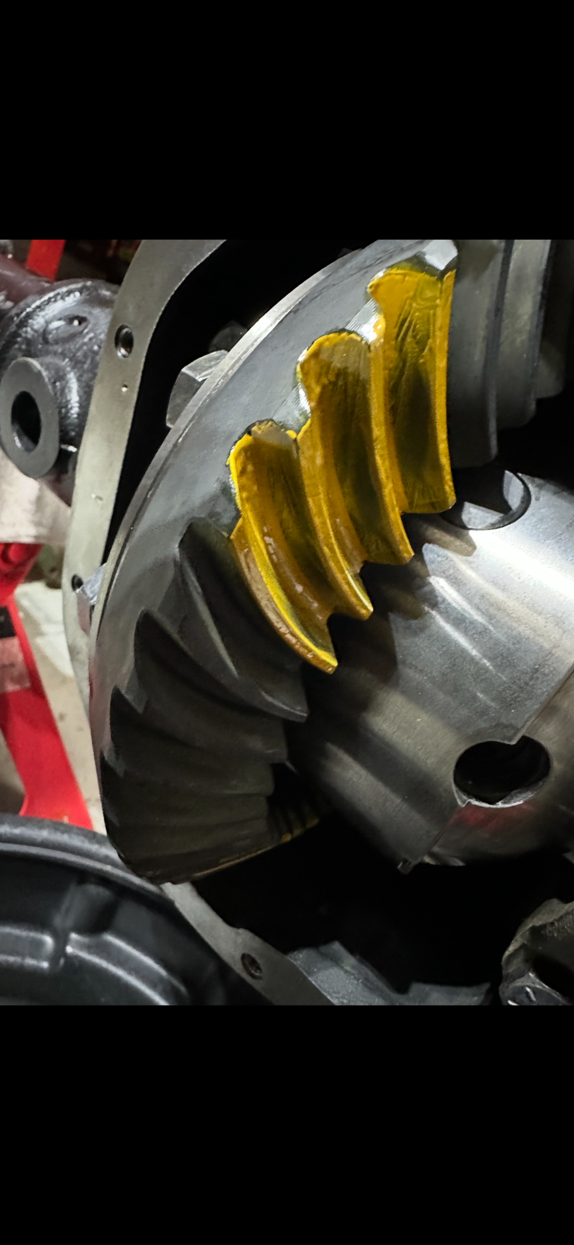

Here was another setup:
Pinion shim 0.045
Backlash:0.006
Yeah I think you're good to go 👍
Thank you for your help. Pattern still seems off where it should be to me being that it appears the drive side is closer to the heel of the tooth. Almost looks like it runs off heel on first tooth.Pattern just doesn't seem what one would expect with all new parts and OEM quality spicer gear set.

Ok So any idea on what would be the cause of of the weird pattern? Gear quality? Issue with the housing?
Sometimes that's just the way they set up. In a perfect world, patterns set up right in the middle of the tooth. Rarely does that happen though. Spicer gears are usually pretty consistent, but yours isn't on this case. Doesn't make it wrong, just not what you had hoped for.
