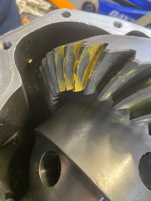

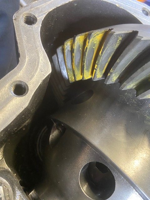

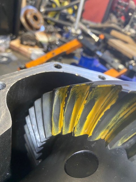

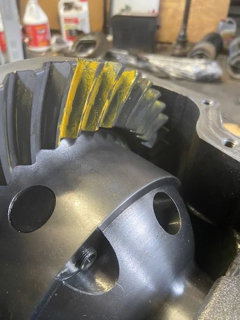

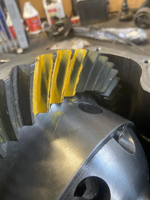

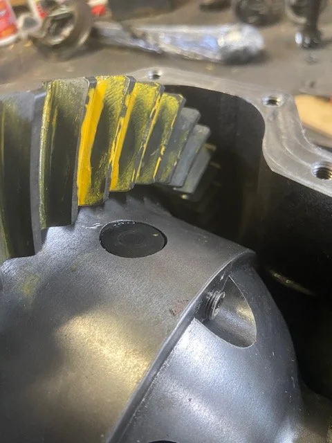

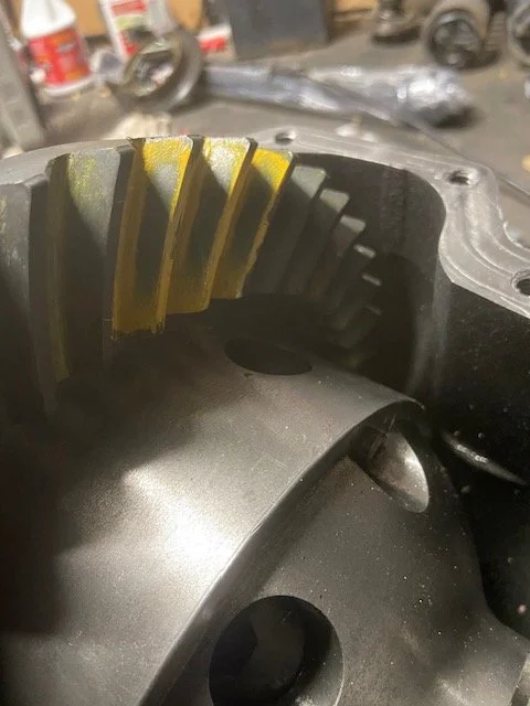

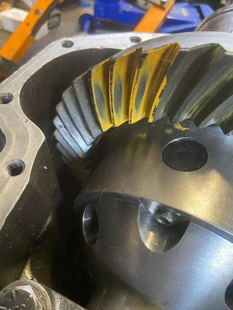

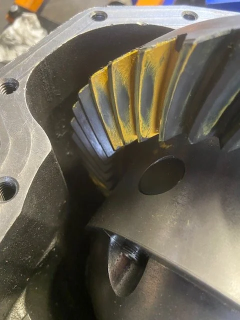

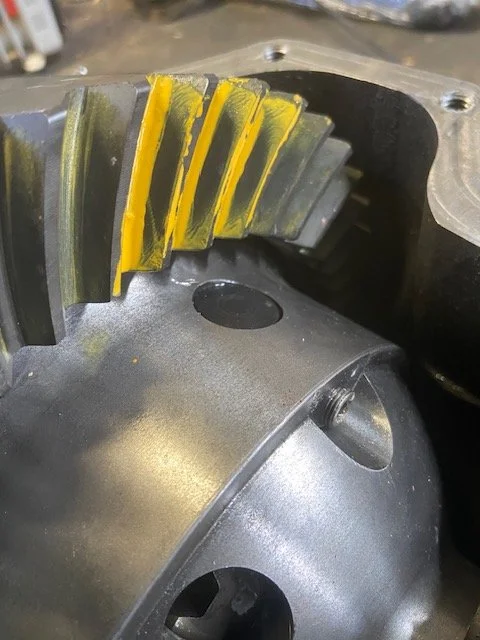

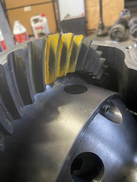

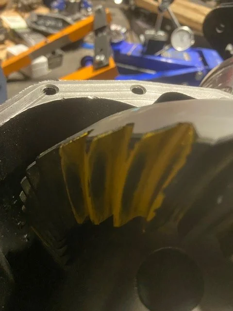

Pattern 1
ECGS Rear Dana 60
ARB Locker
5.38 Dana Spicer gears (new)
Pinion Depth = .055 Depth Shims under the bearing race.
Pinion Preload = 17 inch lbs. and .060 preload shims
Backlash = .004 (I know I need to open it one or two thousands)
Can you please provide input on the first pattern for this set up?
Thanks
