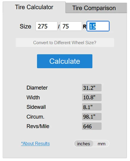

According to every thing I have seen that is the metric for 31”
That is incorrect.
