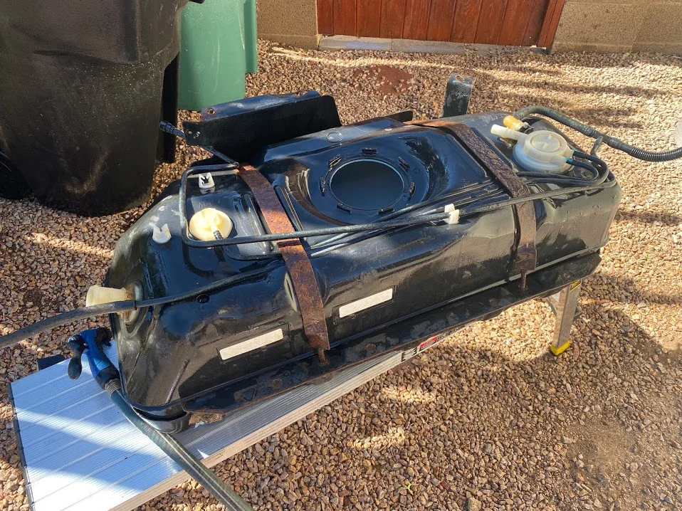

Decided to work on the 2005 gas tank today and get it cleaned out. I figured it would be good to get it prepped and ready, plus even though I have all the openings covered up the best I can, it still stinks a little like gas near the tank and I'll be happy to rid my garage of that smell :)

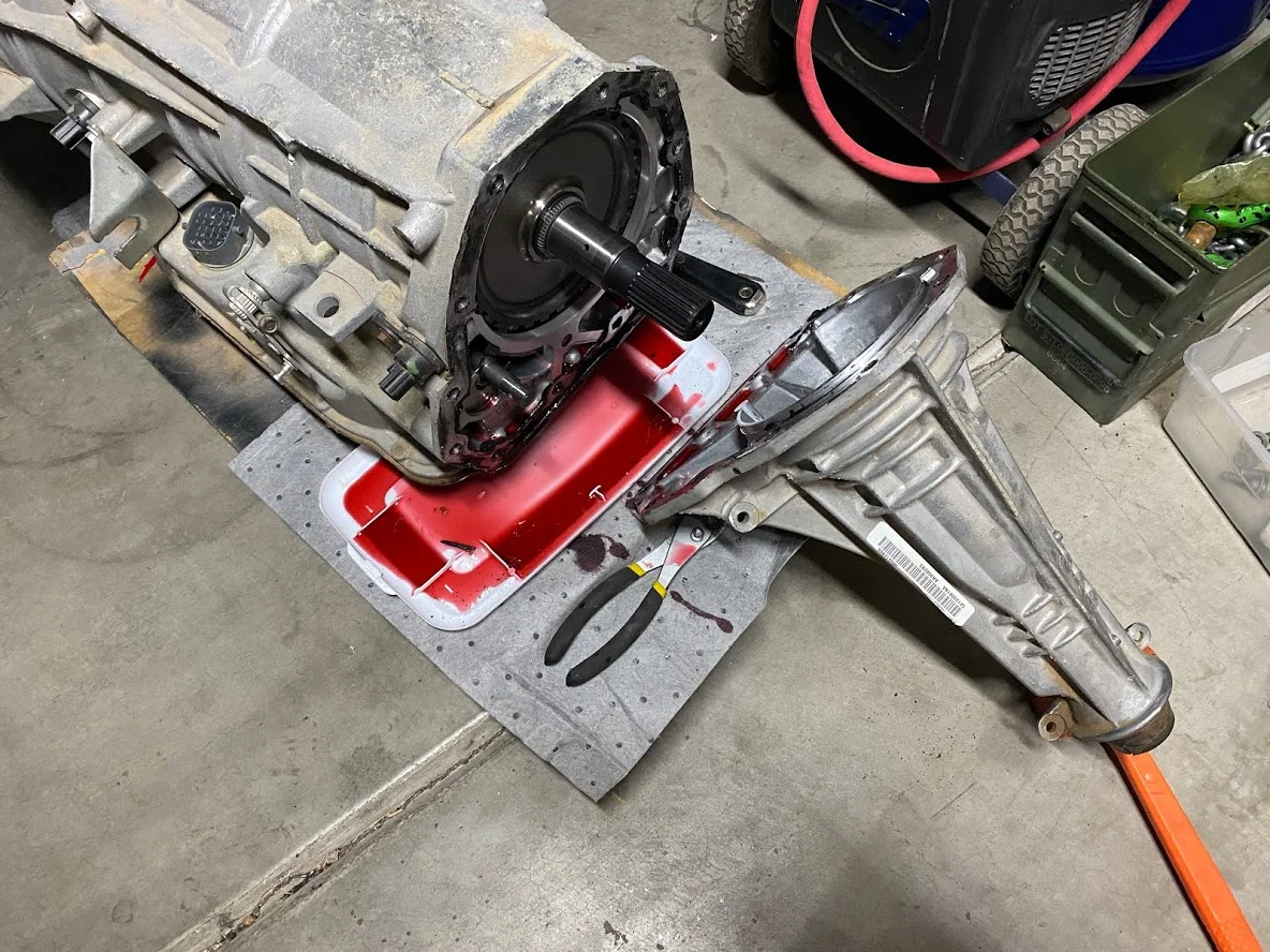

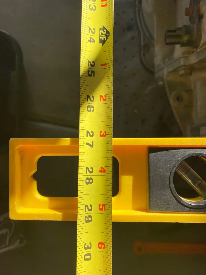

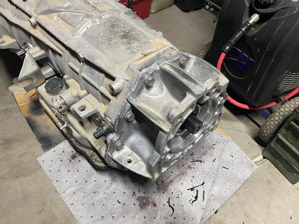

In case you missed it in the earlier post about it, the 545RFE and 65RFE are considered "modular" transmissions. While most transmissions can be converted from 2x4 to 4x4 configuration, many needed to be disassembled in order to do so and many needed new/modified output shafts. The 545/65RFE is different; going from 2WD to 4WD is simply a matter of bolting on the correct tailshaft housing/extension.

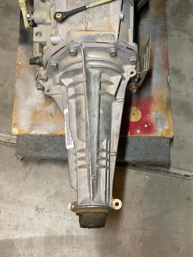

[Factory 2x4/RWD tailshaft of the 2012 65RFE I'm using for my swap]
[Removal of 2WD tailshaft extension]
Removal requires nothing more than removing the 15mm socket bolts around the perimeter of the adapter, then using a small rubber mallet and a putty knife to break free.
[4x4 t-case adapter installed]

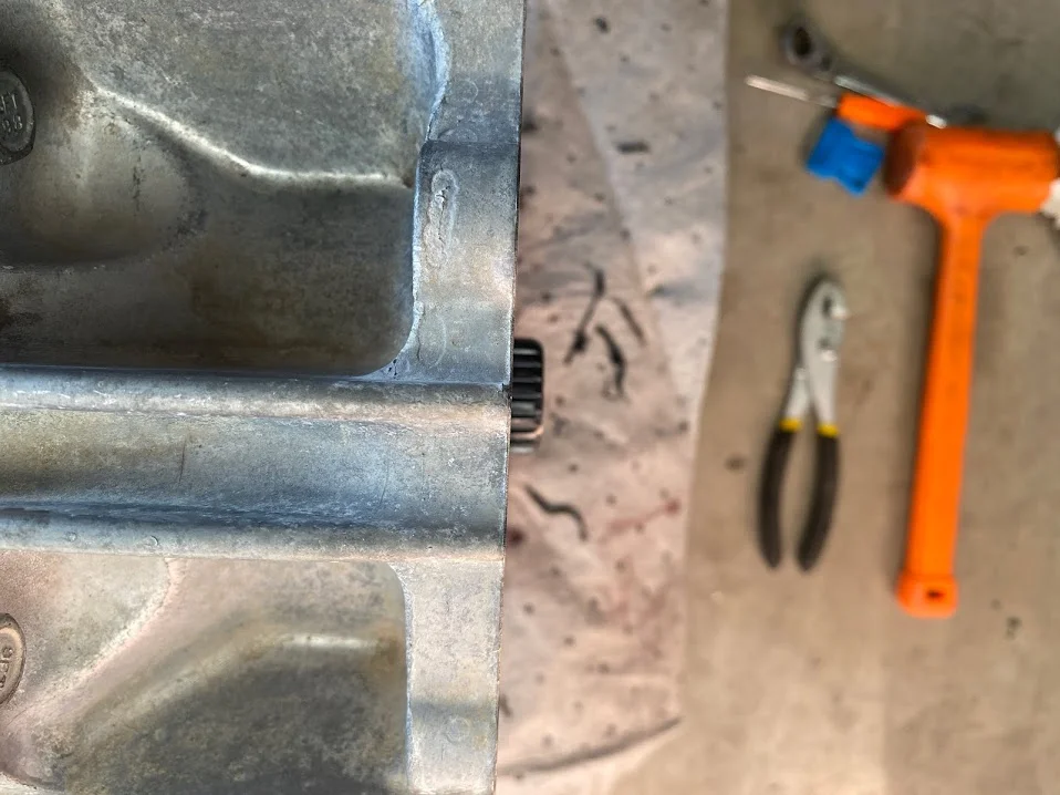

Both the 2WD and 4WD extensions are installed with Black RTV. My transmission-rebuilder friend (the one who gave me the extension for free) suggested "Ultra Grey" since the black will sometimes weep. When a trans rebuilder for 20-years suggests something, you do it! :)

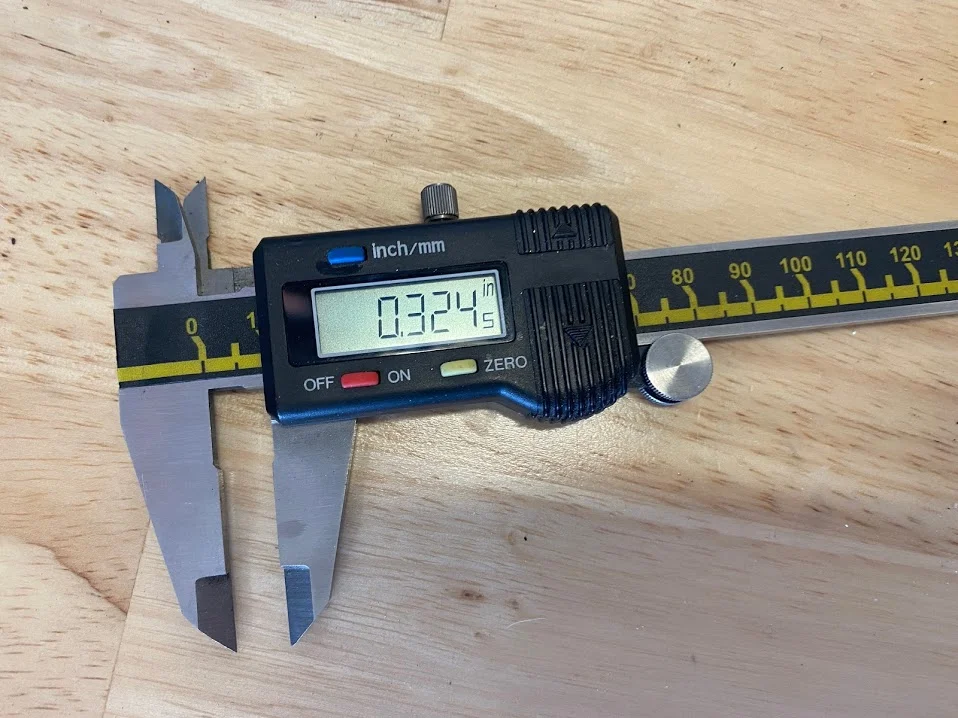

[Output shaft stickout w/t-case adapter installed]
[Output shaft stickout; edge of shaft to t-case mounting surface]
[New overall length of 65RFE w/4WD t-case adapter installed - nearly exactly 27"]

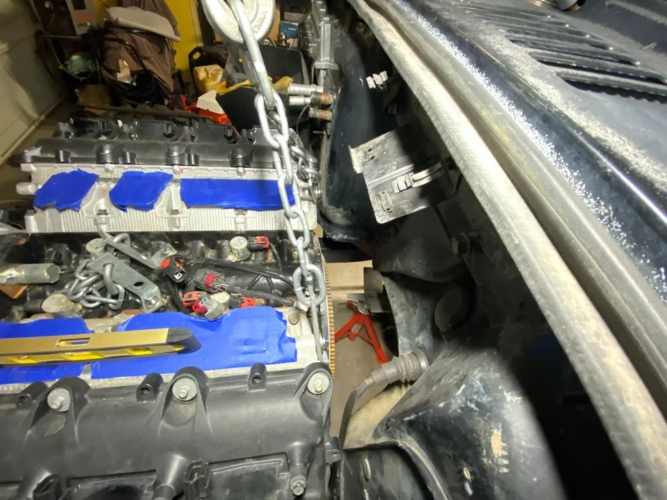

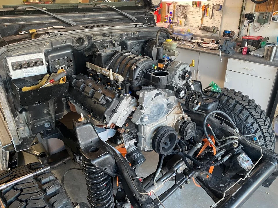

Got the motor set in the mounts...
It's tight, so I definitely want to get the trans bolted up today or tomorrow to see how it fits. As you can see below, there is a good bit of space in front of the firewall to reach down from above to get to the bellhousing bolts.
You can see that the firewall is clearly meant for a narrow motor, so it's deep in the center but the sides (in front of the driver/passenger footboards) do get close to the valve covers).

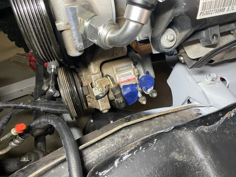

The A/C compressor outlets are close to the frame - hopefully I can make something work there!

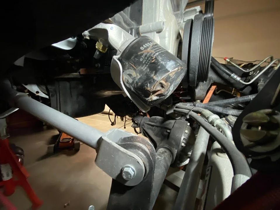

This motor came with a 45º oil filter adapter. I think it has to go as it is already close to the upper control arm mount on the front axle. I wonder if a standard straight-down filter would work. If not, I'll look at a remote filter kit...
You can clearly see above why the Ram manifolds won't work for a Jeep swap...

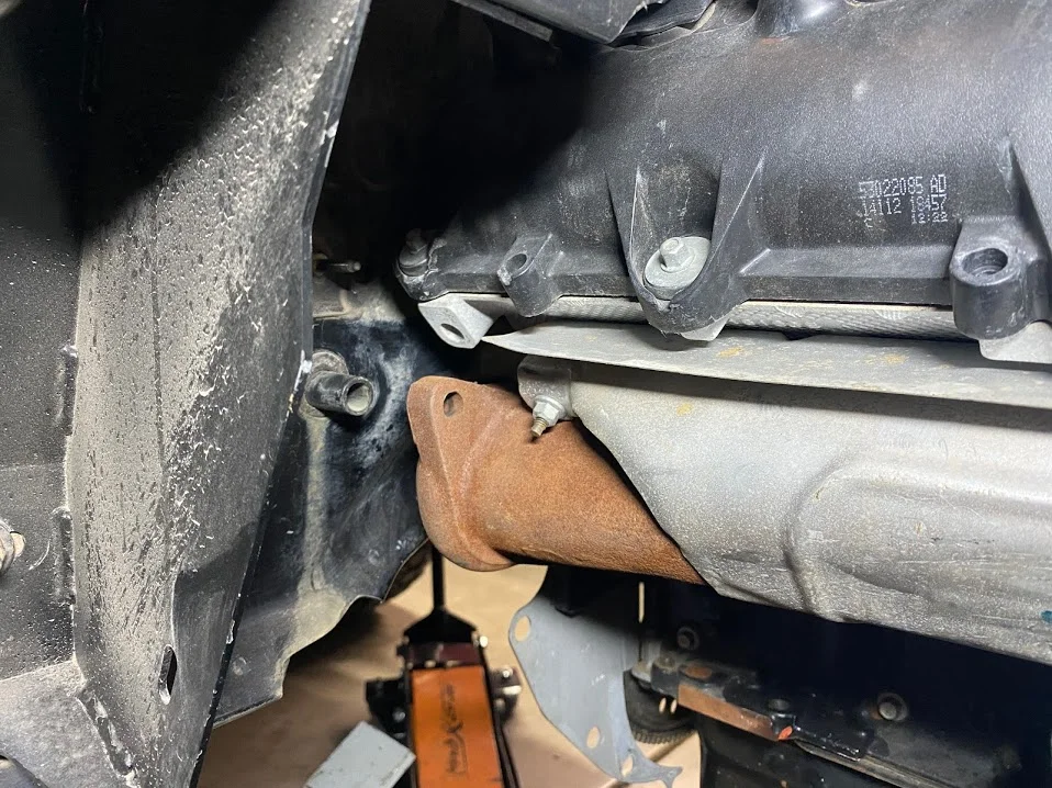

I ordered these - it's a set of the factory newer 6.4L SRT Jeep manifolds that are also sold under Mopar Performance Kit #77072462 - these are supposedly damn near perfect and will match my Eagle-headed D-shaped exhaust ports. These handle 707hp in factory form, so I suspect they'll be just fine for my 400hp NA motor.
