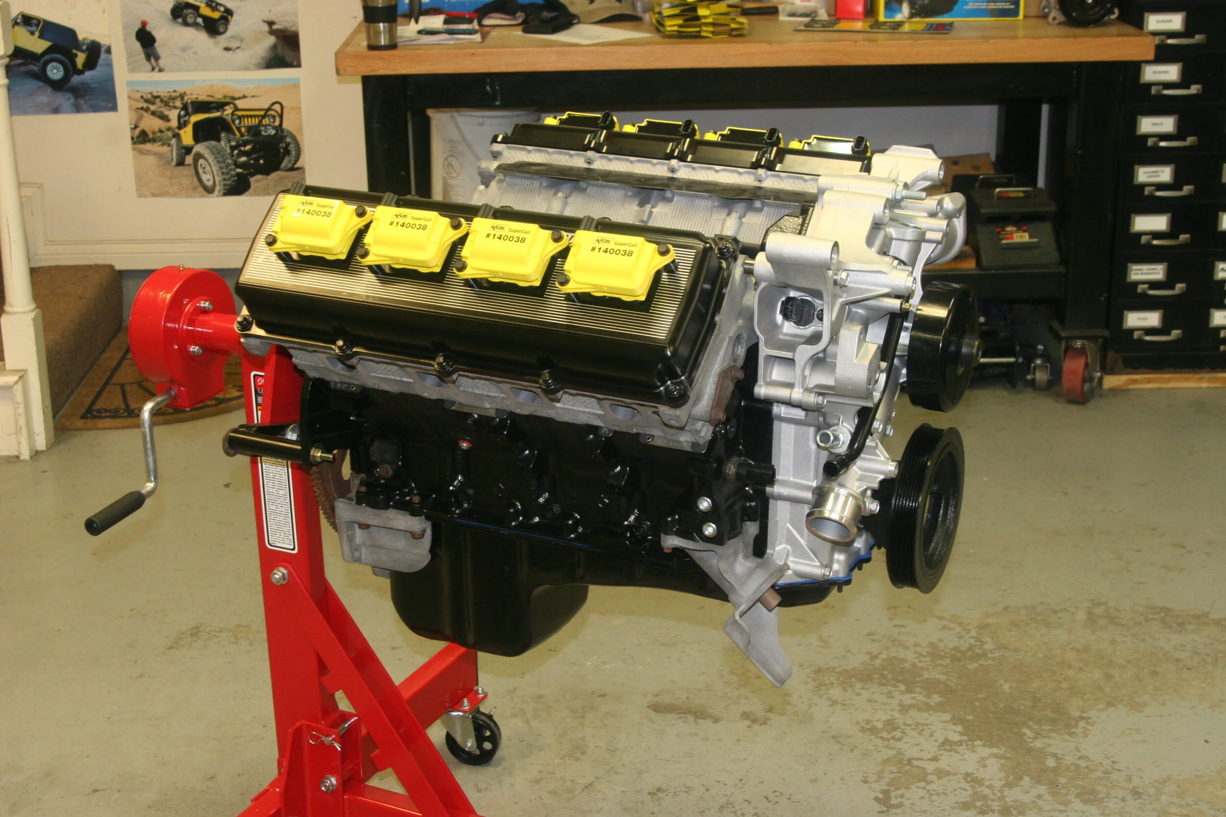

I don't have a shot of the header flange, and this is the best shot I have of the ports. I'm pretty sure they are the square port. Can you tell?
I'm not a expert on the Gen III Hemi but yes they look like the square ports. There have been people who ported their old style headers to open them up as much as possible.

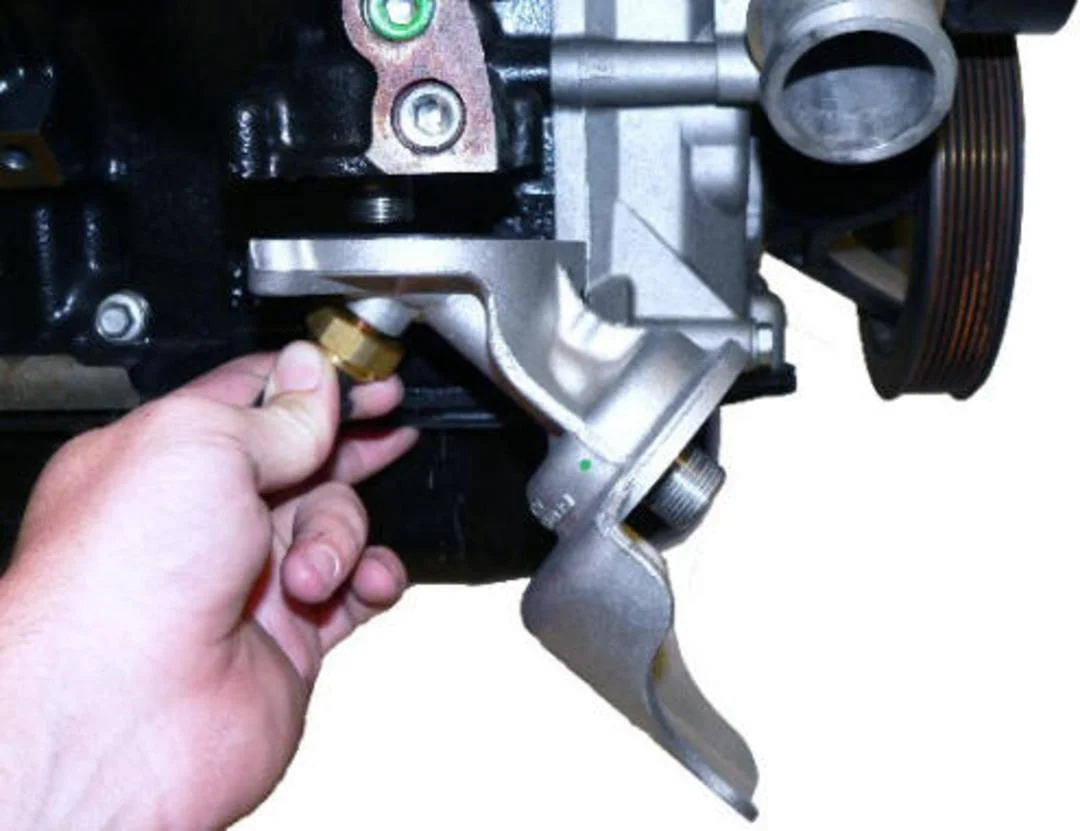

Just to let you know that angle mount filter kit would not work for my application. It actually would have made it worse for me. That's why I used a remote location kit and mounted the filter up front behind the bumper. I've got the write-up and pictures on my thread.
Yes I'd seen your remote mount and had looked at that idea also. I figured I'd order it now (off Amazon) and then if I can't use it I'll return it. Since I have a 3 link front I don't have a upper control arm on the right side to hit it. But we'll see how this all plays out as time goes on.
