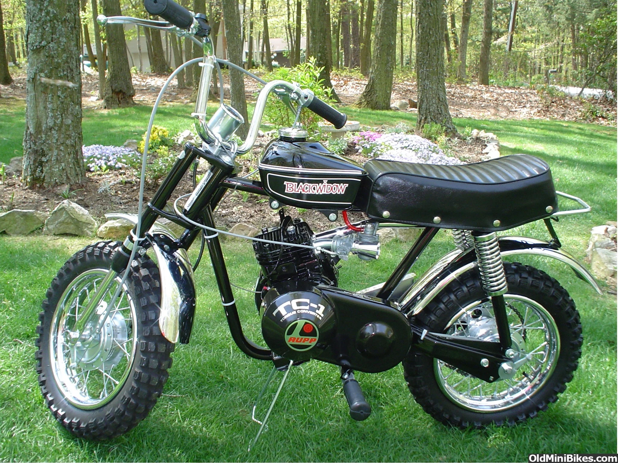

Here's a restored RUPP Black Widow.
It's not mine but the same thing.

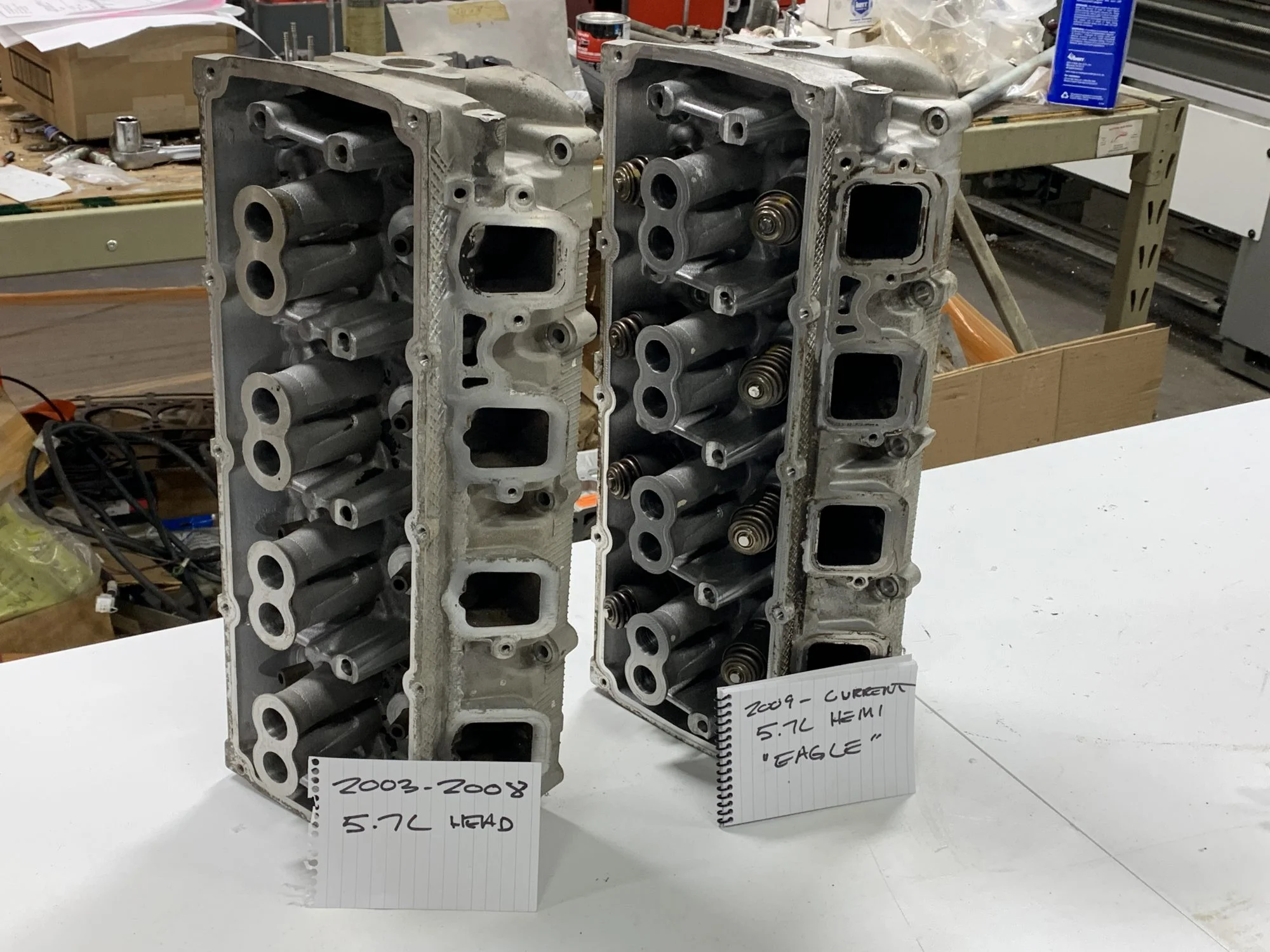

Just to NOTE here: If doing this swap to Eagle heads you have two choices when it comes to your intake manifold.
1) Reuse the stock 03-08 intake manifold but the runners will be smaller & you'll need some adapter plates form MMX.
Early 5.7L to 5.7L Eagle HEMI Intake Conversion Plates
2) Get a 09-current truck intake manifold and run it. Now I'm not sure how much room in between the throttle body & hood. JeepSpeed does make a 90* adapter that I'm waiting to get a price on.

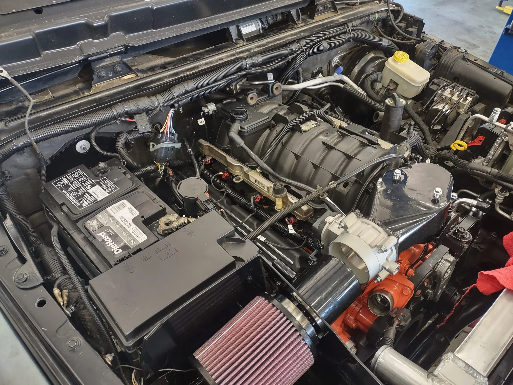

Nice! The 6.1 8 speed swap was relative easy if you can fabricate. Without hijacking the thread I can shed some light on the swap. When I get time I’ll do a detailed write up.
I have over 1,000 miles and loving it. Did the Rubicon a few weeks ago and plenty of on/off-road with no issues The 8 speed feels like you have an extra 30-40 HP vs the 5 speed and you can hit 100mph+ very easily. Not that a jeep should be going that fast.
As far as I know there are only 3 TJs running the 8 speed and we are all slightly different. There is not a lot of support, however Hotwire and Jeep Speed Shop helped where they could, but I was left to figure a lot out on my own.
The trans harness is completely different since it’s wired as a standalone hot rod harness with its own computer and canbus input.
I made my own gas pedal bracket, trans mount, exhaust, AC lines, and power steering lines. I re-used my TJ PSC pump since the bolt holes lined up perfectly, but had to make a simple spacer to align the belt.
My 6.1 came from a Cherokee and I didn’t need to change the accessory drive since everything fit…closely.
I used the Holley mounts and they worked great once the motor is in but it’s a PIA getting the motor and trans in.
You have to run a 1” body lift. I spent weeks trying to fit the exhaust and trans and couldn’t fit them without a lift. I am running a belly up skid plate so that might have played a part.
Stock SRT manifolds will not fit on the driver side with a long arm set up. Spent countless hours trying. Ended up using a modified shorty holly header to fit everything.
For my 2000 TJ I used a 05 ram computer, flashed the TCM in the trans for a 16 challenger.
6.1 and the 8HP70 bolts right up but I needed a different starter, shifter and trans dust shield.
Feel free to DM if you have any more questions.
Hammer do you happen to have any pictures or drawings of your fuel pedal bracket? Be nice to have the information here plus I'm starting my Hemi swap and need to make or find a bracket.
Thanks
