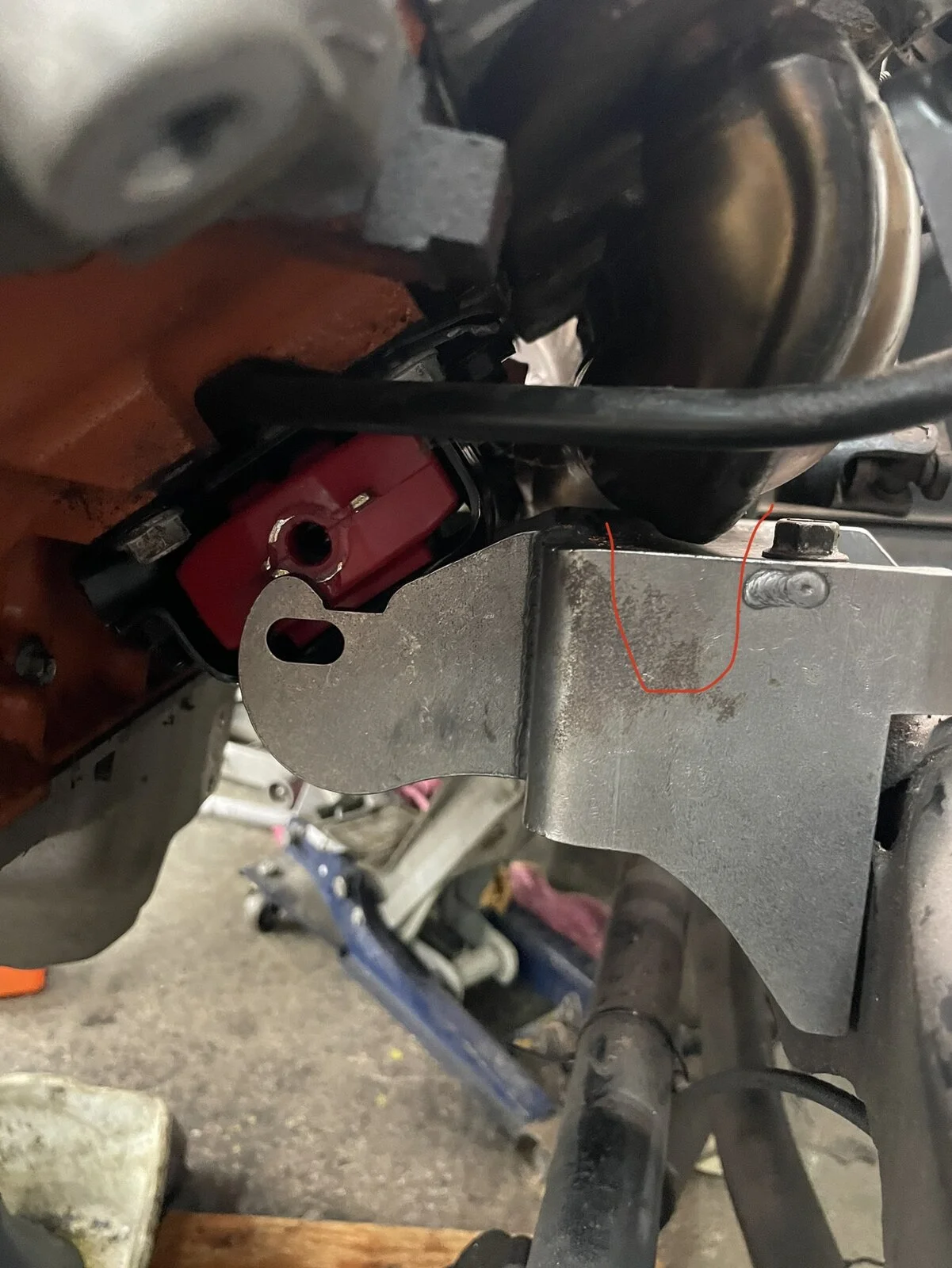

Hey Hemic, the 8 speed is not the issue, but the clearance from the 3” exhaust, suspension, Atlas, and driveshaft became an issue on mine. I’m running 37s and wanted to keep a low CG and ran into clearance issues with the amount of travel on a 4” lift. I’d try it with the factory skid first since you can always add a body lift.
Even with the shorty black hearts I had to cut and turn down the driver side to clear the tub (part BH2375) Not sure on the long tubes.
Teraflex bracket is discontinued and has been for awhile, I confirmed this with them. The bracket was pretty simple to make with a vice and a welder.

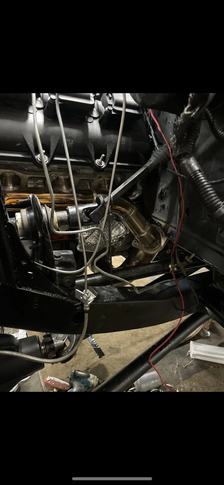

Hopefully it all fits. I really didn’t want to run a body lift but couldn’t stuff everything in there. The driver side gets really tight.
If the 6.4 exhaust is similar to the 6.1 the driver side will not clear the Holley mounts.

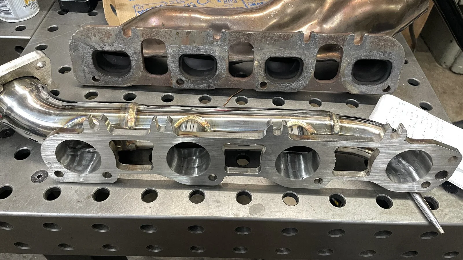

I think this won't work either... do the Black Heart Shorties have D shaped ports?

Large circle ports on the shorties. The circle ports are larger than the d-ports so they won’t restrict flow and they still use the factory SRT gasket. They seal up nice and I haven't had any issues with leaks or flow.

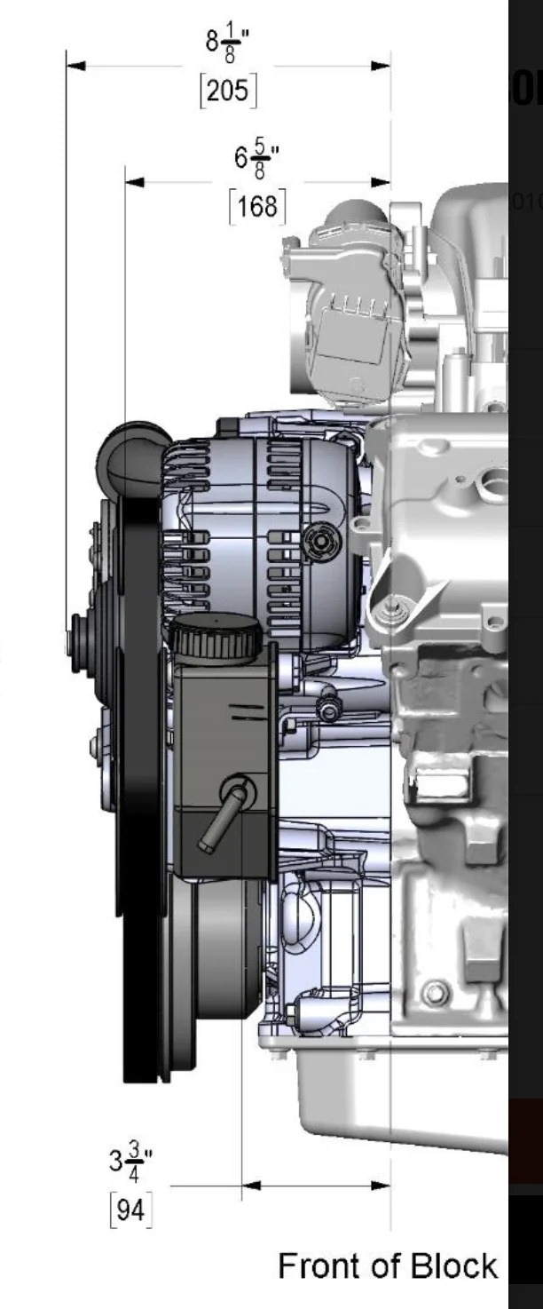

Hammer_c, I purchased a Holley Mid-mount accessory drive for the 6.1 and just noticed that the water pump pulley is 2 inches further forward comparing to the factory setup. 8 1/8" vs. 6" from the face of the block. I haven't installed it yet... do you think I will have enough space to clear the radiator and a SPAL fan? I know radiators and fans come in different thicknesses. I'm thinking of getting one from Superior Radiators. Have to find out the exact thickness with the fan.

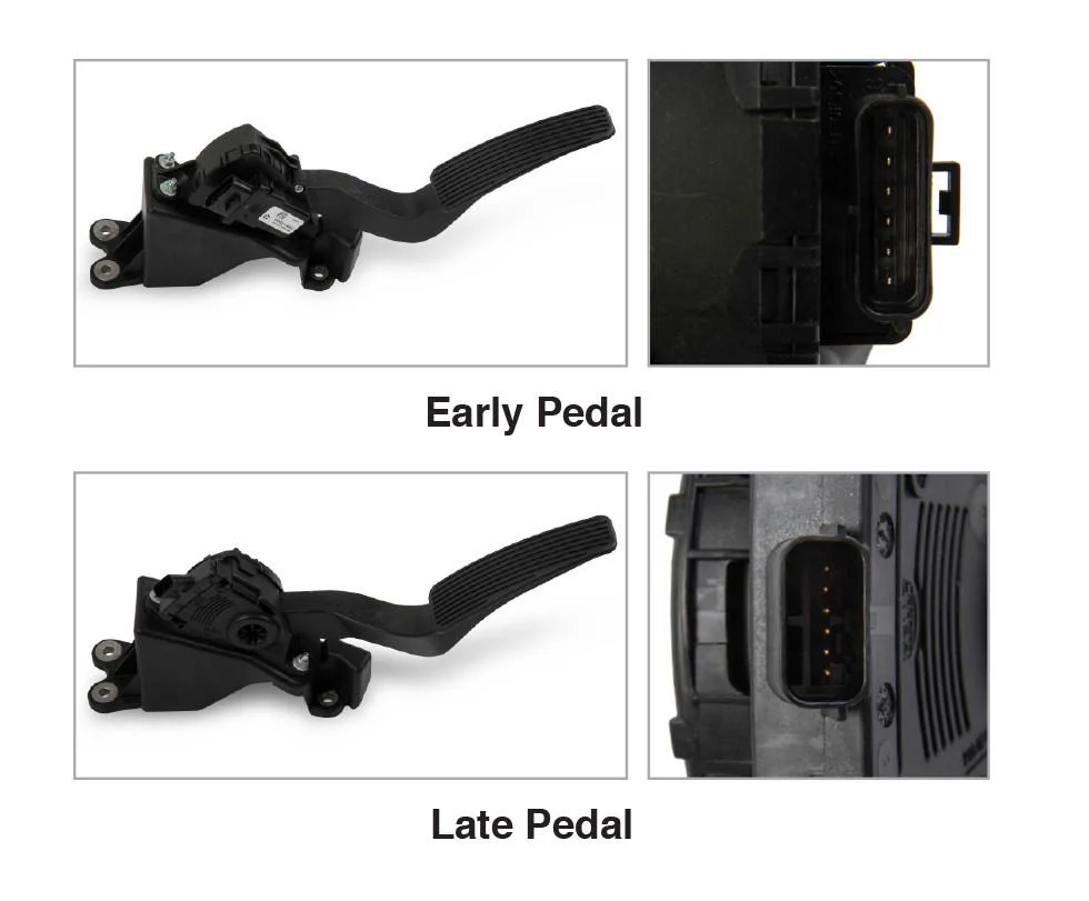

Gas Pedals
- All Hemis utilize a DBW (drive by wire) throttle body, though the early ones use what is known as a "bell crank" to generate the throttle position signal. There are two styles of connector that I've been able to find: Early (2003-2007 cars, 2002-2006 trucks) and Late (08+ cars, 07+ trucks). Functionally and physically they are similar but the connectors are different:
[Early and late style connectors - https://www.redline-motorsports.com/products/hly-558-418]

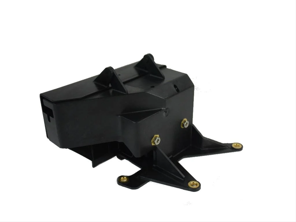

[Early Hemi Bellcrank assembly]
- The cable went to the bellcrank assembly that housed the TPS (throttle position sensor) as well as the mechanical linkage to work with the early transmission throttle valve assemblies. For those looking to utilize a TF-727 or perhaps an A518 transmission, this is one of the few ways to get OEM-reliability with a modern Hemi swap.

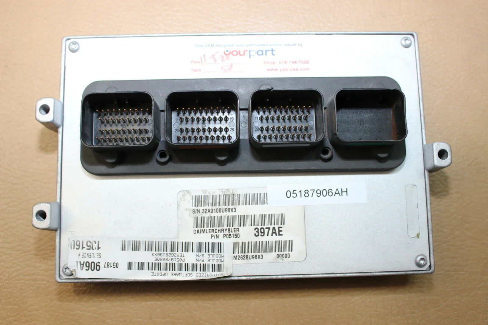

ECM Differences:
The reason the LS was so popular was because the ECM's were more quickly cracked and there weren't as many variants to understand. Over time however, the factory Hemi ECM options were more understood and now many aftermarket companies are developing standalone units.
There are two major iterations of G3 Hemi ECMs: NGC and GPEC. Note that these are generic terms and there are many sub variants (e.g. NGC4 vs NGC4A)
All NGC (Next Generation Controller) variants utilize 4 plug connectors at the ECM: C1 thru C4. These ECM's are found on 2003-2010 cars and 2003-2012 trucks. Note that individual model year changes vary, so you'll need to physically check what ECM your donor vehicle has if you're buying a transition year rig. Truck ECM's are "standalone" and the case is designed to be installed in an open environment. The car NGC ECMs are designed to be flush or near-flush mounted.
C1: power/CANBUS/SCI/grounds
C2: engine controls (coils, sensors, injectors, TB, etc)
C3: cabin/chassis interface (gas pedals, auto trans user control, etc)
C4: transmission controls (this will be blank on ECMs that came with a manual transmission or with a NAG Auto trans)
[Rebuilt NGC controller for a 5.7L Ram - note the blank C4 port, suggesting this was for a manual trans truck]

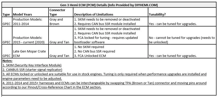

On the GPEC (Global Powertrain Engine Controller), there are now only two 96-pin connectors rather than the 4-connectors of the NGC.
C1: cabin controls (power, grounds, CANBUS, starter-sense, communications, etc)
C2: ECM/Transmission
[example of a GPEC ECM - note the consolidation of 4-ports to now just 2-ports]
DIYHemi has another great video here:
2015+ GPEC EMC Considerations:
2015+ GPEC ECM's are difficult to work with and at the time of this posting, are generally referred to as being "locked" (although many places can unlock). These require removal of some factory systems and also require some circuitry manipulation and circuitry emulators (such as starter-signal from what would be a factory BCM unit). I won't be dealing with a 2015+ ECM for the foreseeable future but will include any links or info as I run across it.

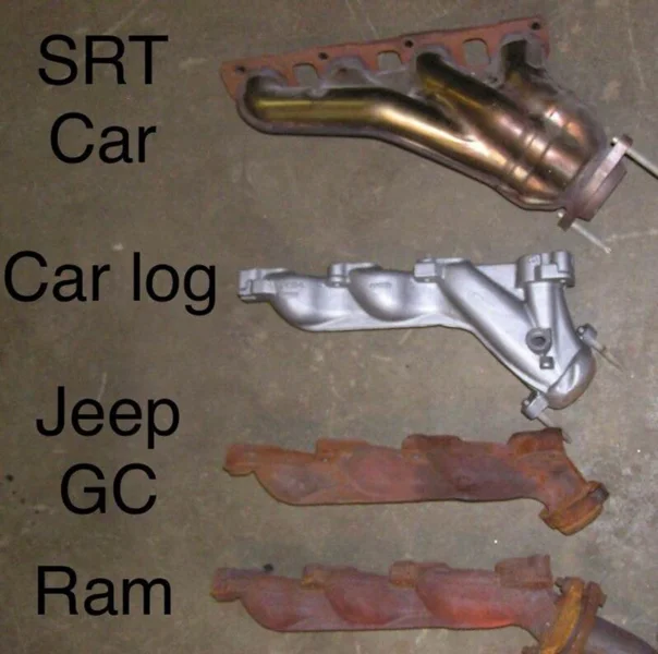

[Visual differences of the various manifolds available on the Gen III Hemi vehicles]
The early non-Eagle 5.7L heads have a standard square exhaust port. The early 6.X SRT motors had D-shaped exhaust windows that the later 2009+ Eagle 5.7L motors moved to. As a result, the later Eagle-style exhaust manifolds and headers typically fit just fine on early 6.X motors.

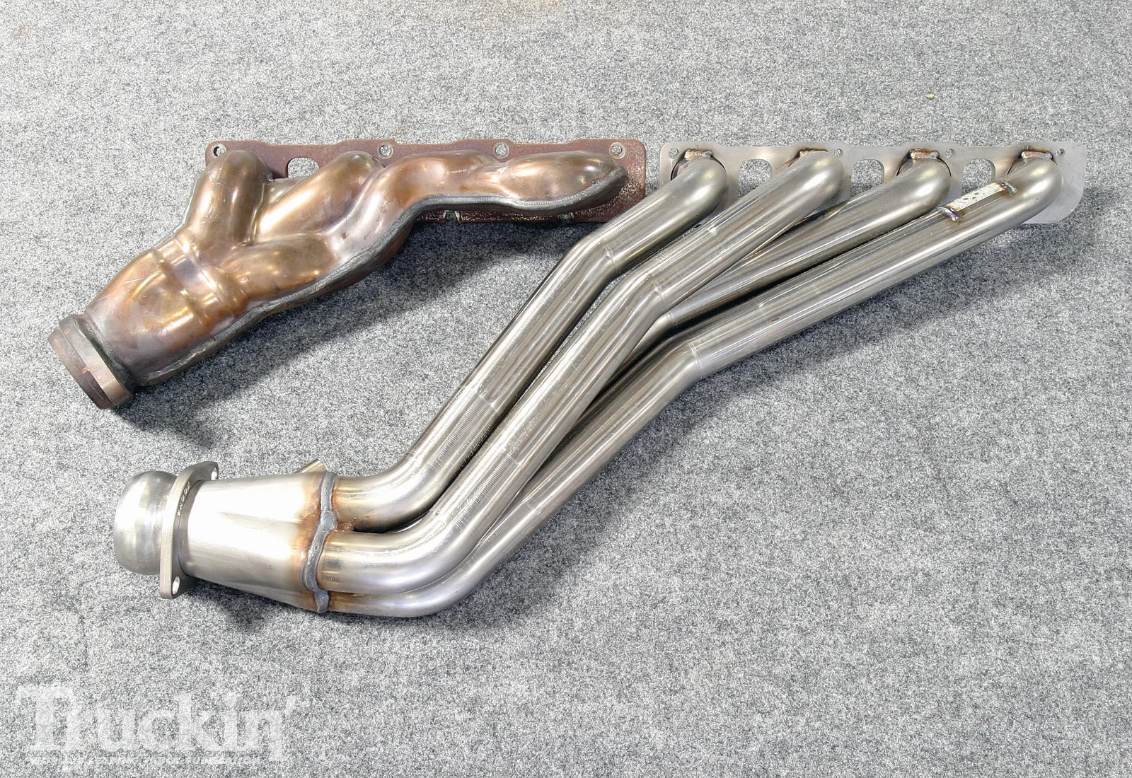

[Factory Jeep SRT 6.4L tubular manifold on left; Kooks long-tube header on right]
The SRT manifolds are excellent and flow very well. However, the car SRT manifolds (as well as the car 5.7L log manifolds) point the collector at the frame rails. The SRT tubular manifolds are very similar to the SRT car tubular manifolds, but work well in Jeep and other swaps. As you can see in the image above, the SRT Jeep manifolds are similar to the car version, but the front two ports are siamesed together to provide clearance for the mounts. The exit port is also in better position for most swaps.

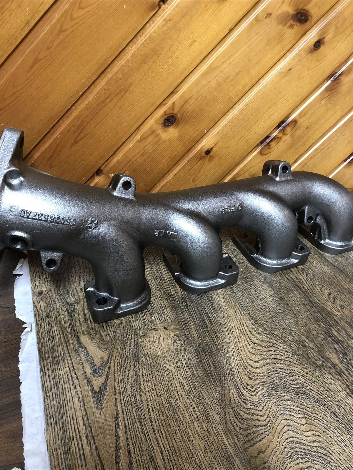

[Mopar Performance 6.4L Manifold Kit, PN 77072462AB, which sells for ~$335 for the complete set as of the time of this writing (Feb 2021)]
The SRT 6.4L Jeep tubular manifolds have been out of production for a long while. However, you can get a newer cast-style manifold directly from Mopar Performance that actually outflows the earlier tubular manifold and is less prone to cracking. The Mopar# is 77072462AB. I got a set from WholesaleMopar.com...

Did you actually use the following exhaust manifold in your Hemi Swap?
Sorry, I couldn't find any pictures or further notes on the topic:

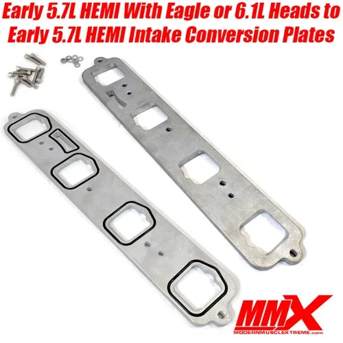

Been talking with Ryan from FRP and they are just about ready to release a Eagle head/Cam package that will include MMX adapter plate allowing you to reuse your 03-08 intake manifold on the newer Eagle heads.
https://www.modernmusclextreme.com/...sion-plates-by-modern-muscle-performance.aspx
He's not positive yet on the cost but is figuring around $4800 for the kit.
This is what would be included in the kit:
Eagle cylinder heads
MMX conversion plates
Camshaft (NON VVT) _Hellfire 2.0
Head Bolts x 2
OEM NON MDS “Hellcat” Lifters x 4
Cam Bolt (Non VVT)
Crank Bolt
Valve Spring Kit (omitted due to head purchase)
Manton Pushrods (6.775/8.075)
MDS plugs
Water Pump Gasket Truck
Timing Gaskets
Valve Cover Gaskets
Intake Gaskets
Exhaust Manifold Gasket
Eagle Head Gasket
