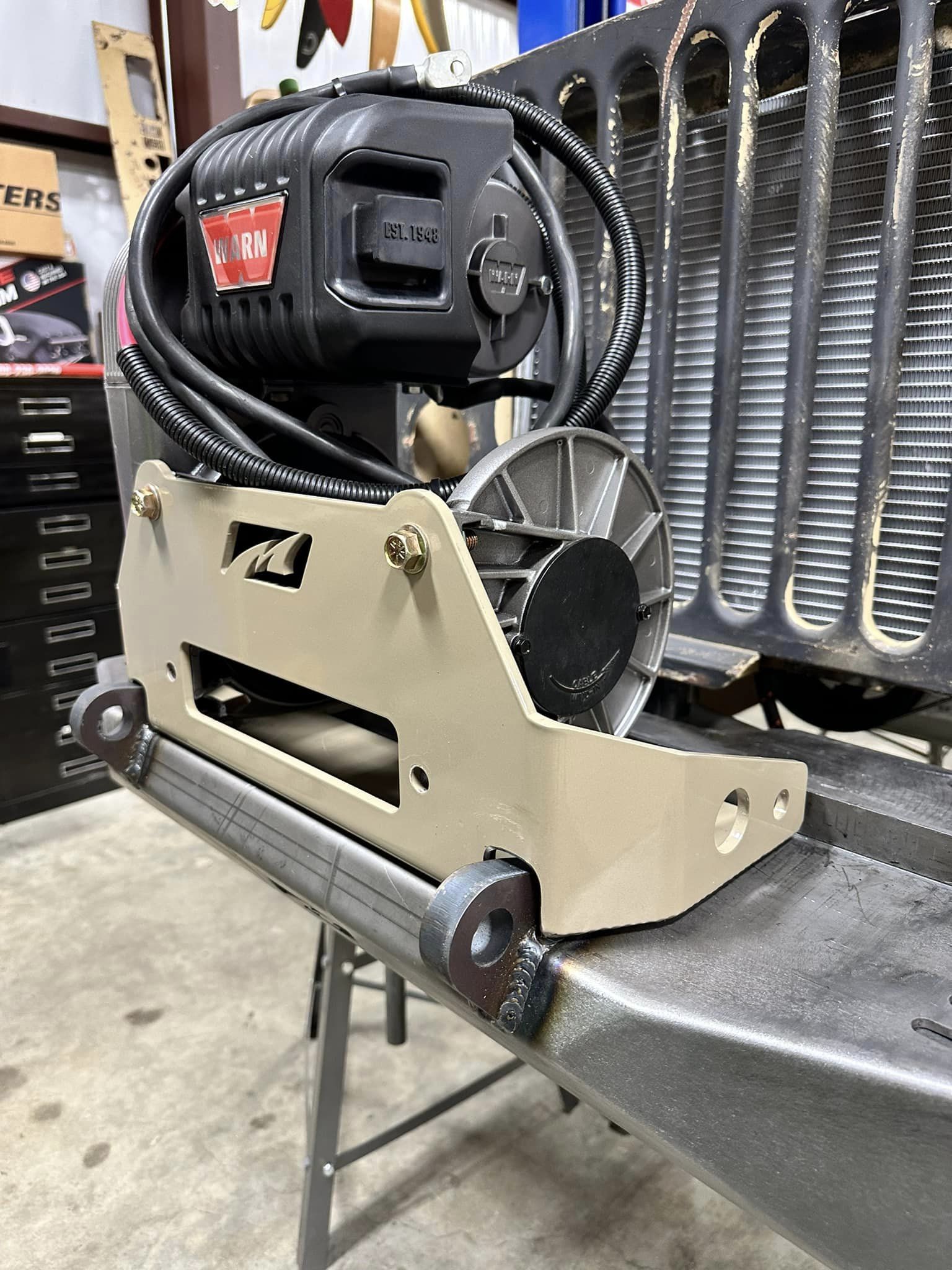

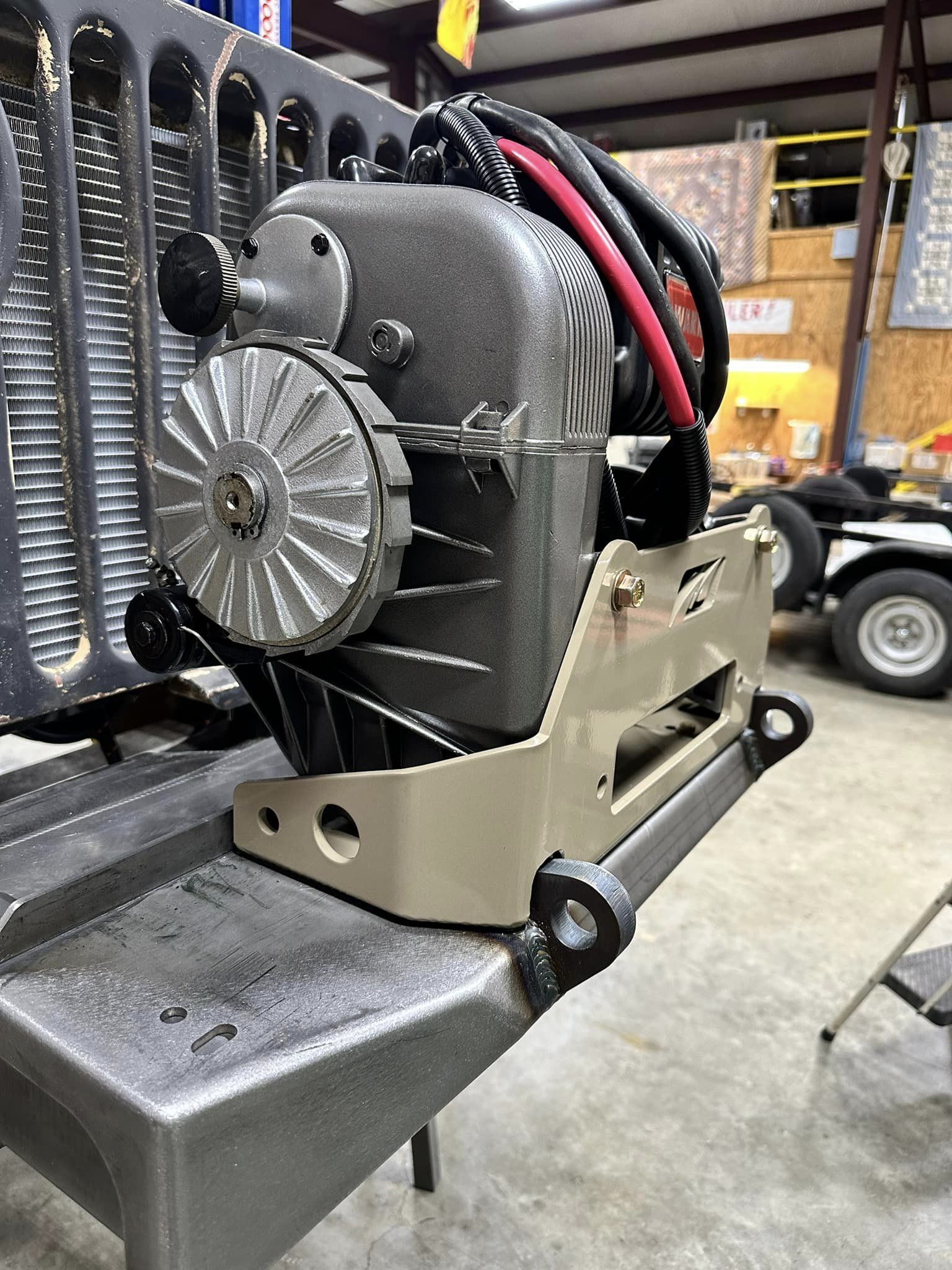

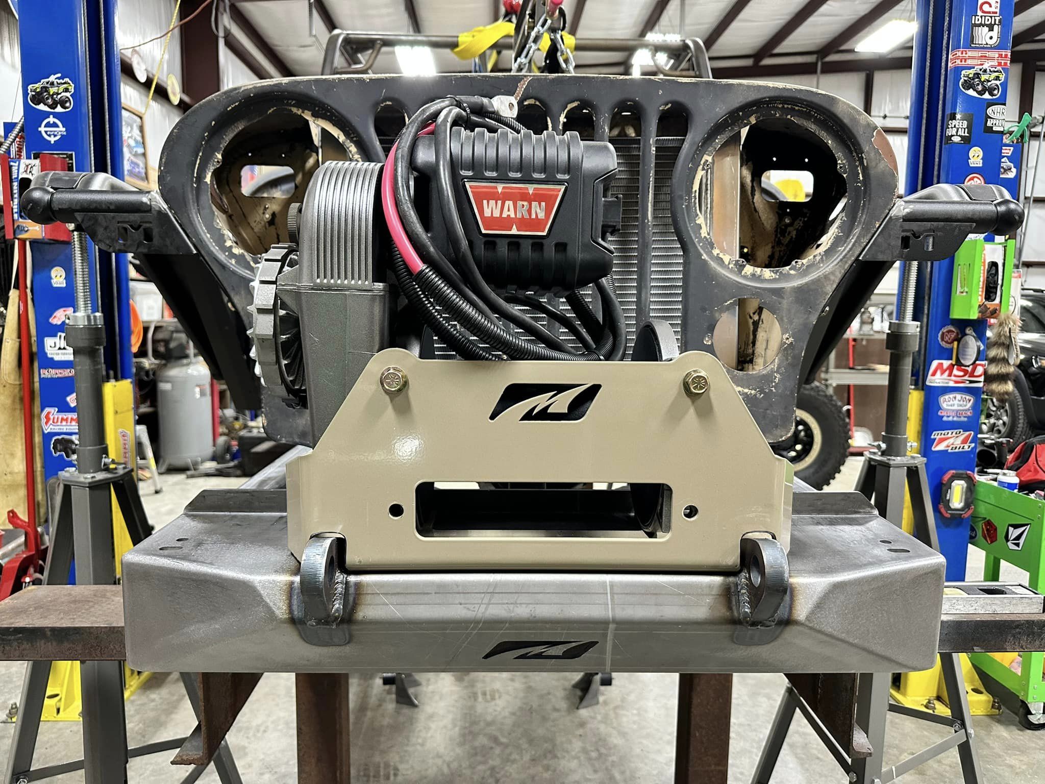

Motobilt stinger bumper and Motobilt 8274 adapter mount.
I’ve got a Motobilt 8274 mount on a modified Motobilt stubby/short bumper and love it. I had to cut the d-ring mounts off of it to get the 8274 mount to fit. I’ve added some other recovery points now that aren’t on it in this pic to replace them.
  • Love
Reactions: John Cooper
Motobilt told me I could notch out the mount to work with the recovery points.
