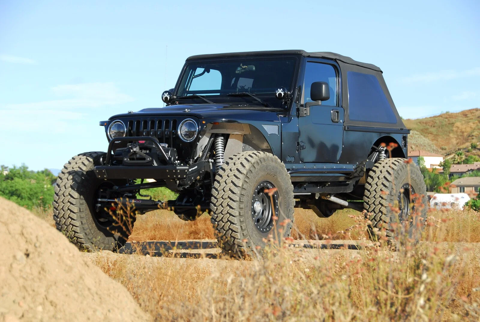

It is like the KOH car, yeah, it looks good from here until you drive it and figure out that it won't crawl nearly as well as it bounces over stuff. You won't outrun it but you may not like how it gets from point A to point B unless that is your thing.
I can tell you mine bounces like hell with these IFP Fox shocks 😆

Oh yeah, I missed the part about 37s and 100" to 101" wheelbase.
Where did that number come from?
1.5" front stretch, the most I feel comfortable without really getting involved with steering box relocation. 5" rear stretch using Genright's EXT tank. I'm setting a benchmark for 100" and with the axle build, I'll need new wheels so why not new tires... I've seen local TJ's wheel with 37's and the breakover angle will be similar on 35's. Like Blain said, go have fun and figure it out... Maybe that was condescending.

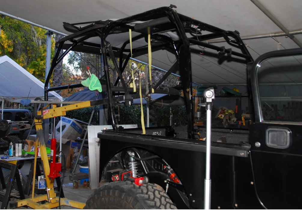

Through, or behind? Behind only means you'll need to remove the dash to remove the cage.
Ahh I think you're right. Sorry for derailing.

I don't know what to call their kit because their same "stage 1" package frame brackets are used in their COMP & EXT kits and the first sentence to their description is "This package is for the guy who just wants to convert their Jeep to Coil over shocks (and does NOT want to stretch their wheelbase)."
This is how you learn stuff here. I hadn't really thought about the narrower rig on 35" tires finessing through a trail, taking its time, versus KOH build skimming across the top at speed. This seriously does help explain the very different approaches. Both share the goal of getting to the end, but one is about doing it faster than everyone else.
