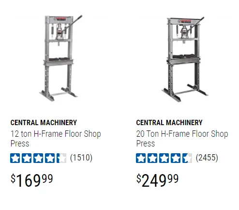

Don't do this to the new bearings. Also, if you need a press, I recommend the HF unit.
HF unit? Could you give me a part number or link….or do you mean harbor freight? Cause I’m looking at the 12 ton press , But they don’t have it in stock. Figures. 😊
If you are not needing a press very often and do not want the expense of one look around for a machine shop, driveline shop or the like and you will probably find that they will press your bearings for $30-50.
i appreciate the tip, but my better half is ok with it, and I want one! She knows me enough to realize I am going to get my money’s worth! The bigger issue is the room I have in the garage LOL…
Reactions: Blackjack
Damn, I just looked at their current prices. I bought my 20 ton for $150 out-the-door about 5 years ago. That sucks. It is a good unit, but I think I would be looking for a used one.
