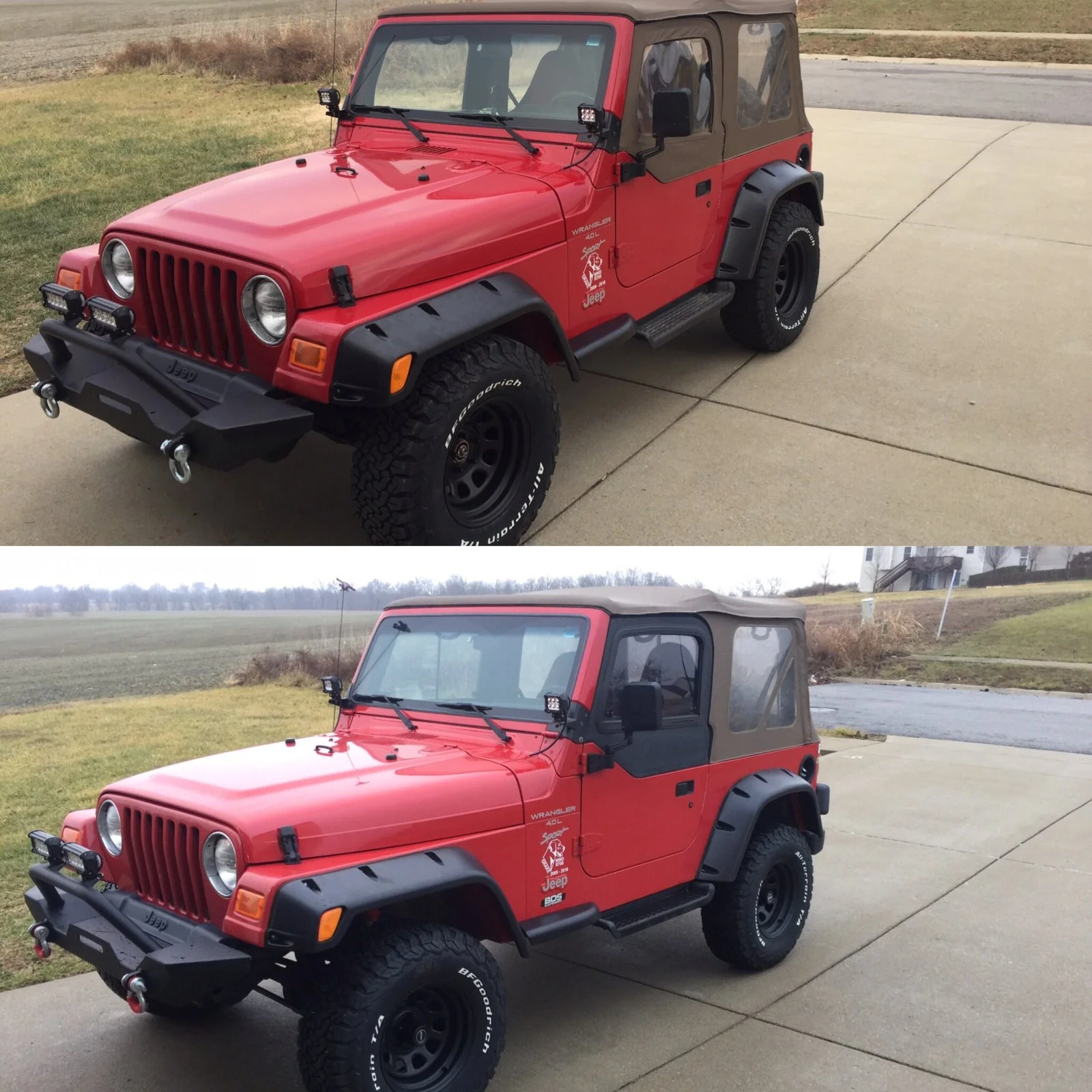

Here is a before and after shot! Thanks all for your help. The hardest part was reattaching the lower control arms (all 4 were pretty difficult). I ended up using the spring compressors on the rear coils, just barely had to compress them. I was able to get the front coils on without compressing.
Looks so much better! If it were me I might put factory flares back on. I only say that because those bushcrackers look a little too wide for those wheels / tires.
Other than that, PERFECT!
