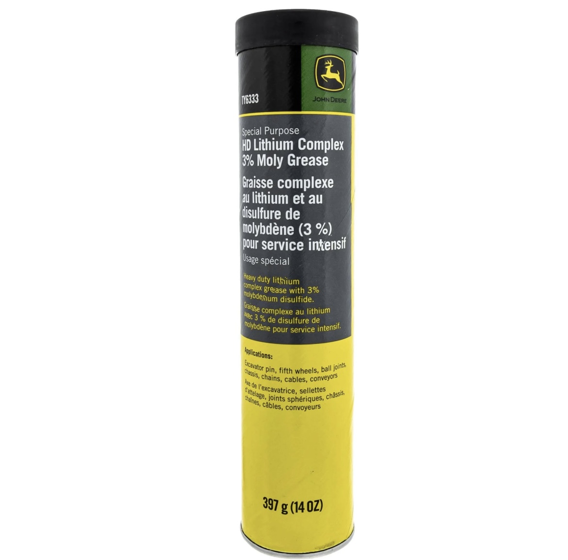

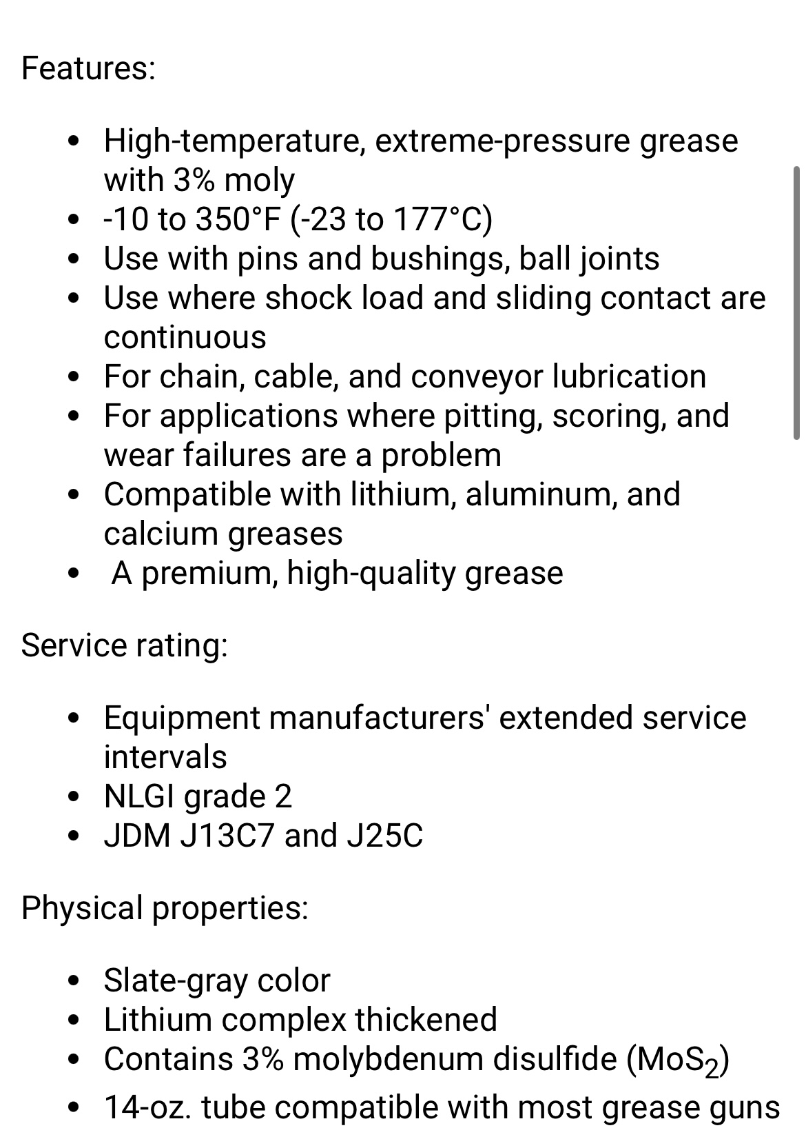

@Blackjack or anyone else, thoughts on this grease for regreasing my xd900i? I can get it pretty cheap from work. From what I’m seeing discussed about the importance of low operating temp requirements I’m guessing that may be a issue?
So the two things that stand out are that it only has three percent moly and it is #2 weight. The lower moly content is not probably the end of the world. #2 weight can lead to stiff freespooling in colder weather but that is probably not as big a deal where you are at.
Reactions: TJ Starting
Appreciate the input. JD has another moly grease but I’m not sure if we have it in stock. I’ll have to check today and if we have it, see if it’d be a better option in comparison to this stuff.
