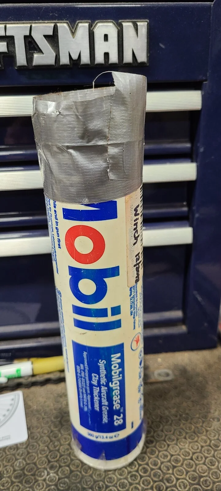

I tore apart my Smitty winch a couple years ago. Removed all of the original glue (yes glue, not grease) and replaced it with actual grease - Mobilgrease 28. 20201201_220024.jpg
Works VERY MUCH better now!

I tore apart my Smitty winch a couple years ago. Removed all of the original glue (yes glue, not grease) and replaced it with actual grease - Mobilgrease 28. View attachment 207140

The Mobilgrease 28 that I posted above is synthetic and came recommended by Smittybuilt.
