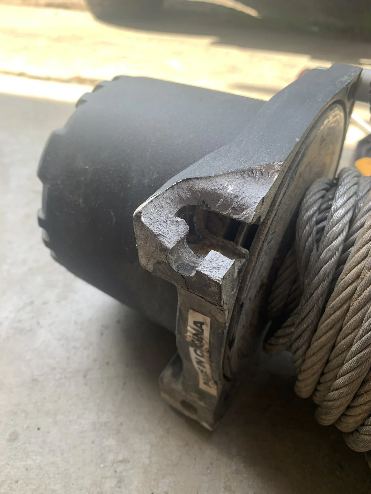

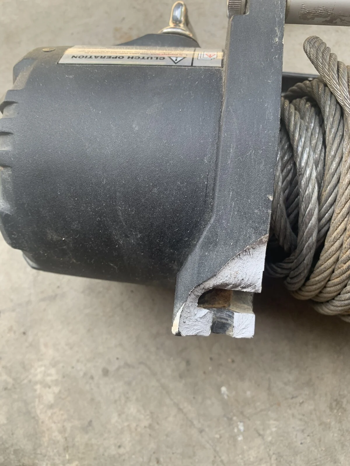

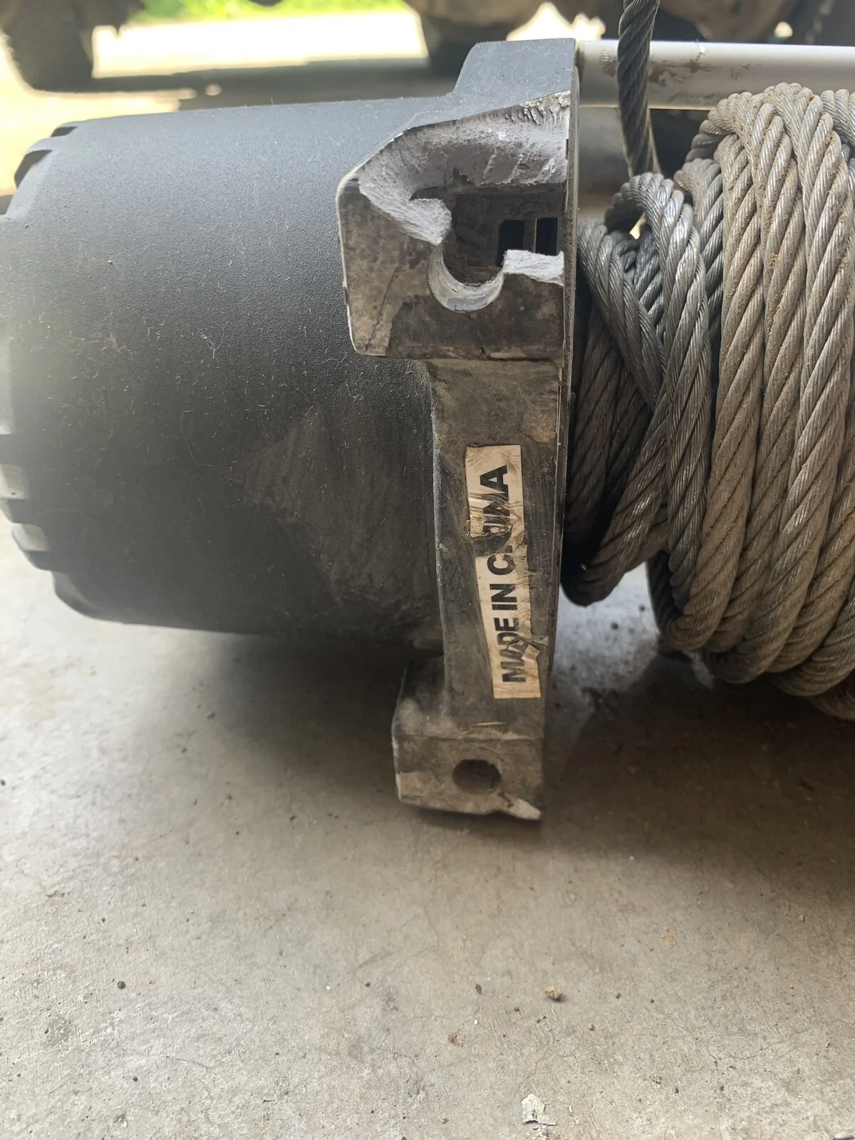

Broke my Smittybilt XRC 9500 winch, is there any way this is fixable? It’s only one of the 4 mounts that broke. Thanks.
If smittybilt can’t help, and it’s an aluminum alloy, a good weldor could weld it up. Provided it can be dissembled to the point where it has no seals or plastic parts left in the casting. If anything is left in the case, it could be damaged by the extreme heat of the welding process.

Said it wasn’t covered in warranty
That sucks but knowing Smittybilt it's not surprising. Sorry they wouldn't cover it, that's not a common breakage. Was there something you're aware of that caused it to break? How old is it?
Before you bolt another winch back on the mounting plate you need to diagnose why that failed. Did you have a bolt come loose or is the mounting plate distorted in some way? Were you pulling off angle for an extended period and the wire rope balled up on the drum flange and pushed the winch away from the mount? From what I can see in that pic the drum support did not have a fracture so it was not a bad casting.
