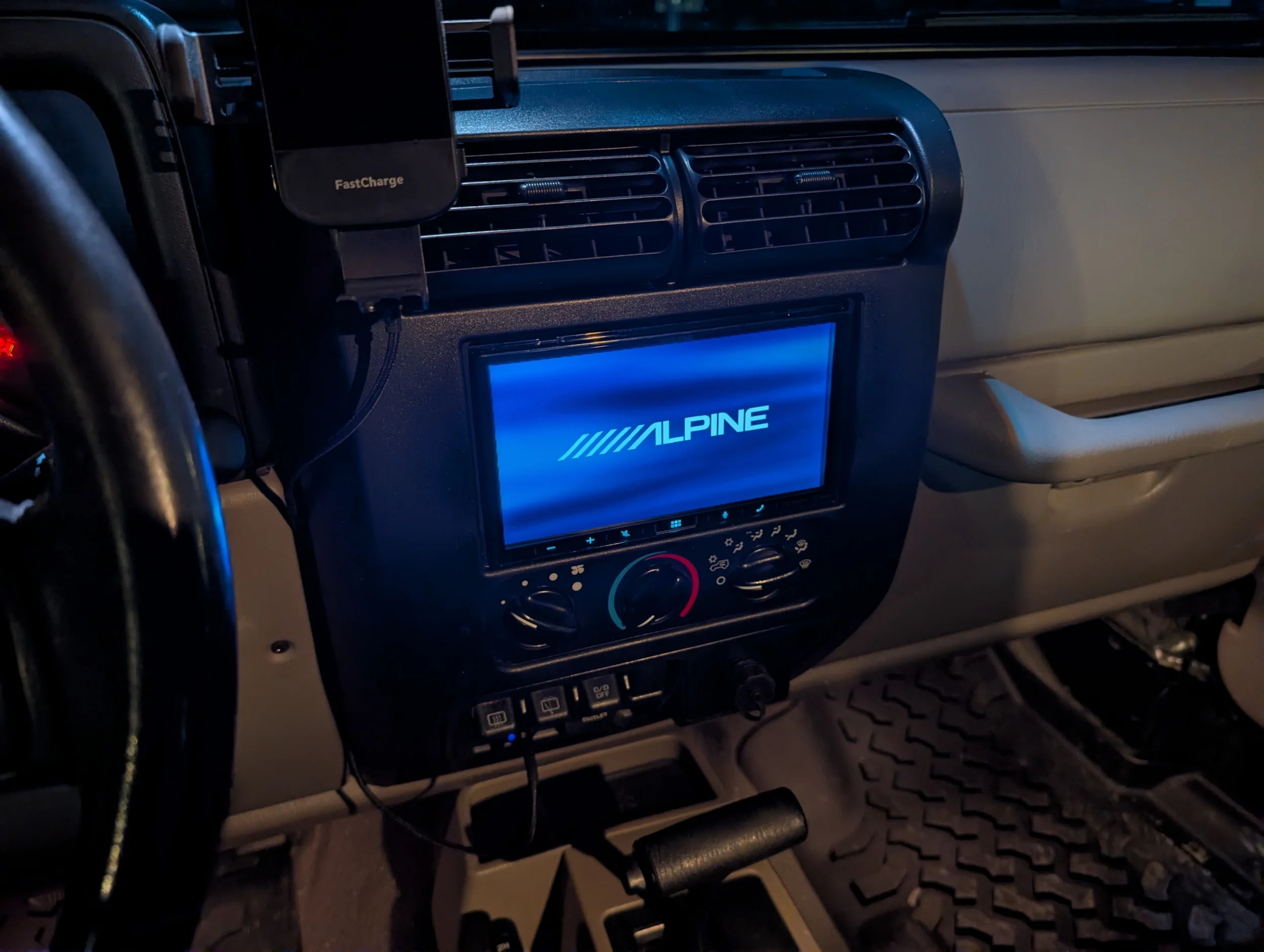

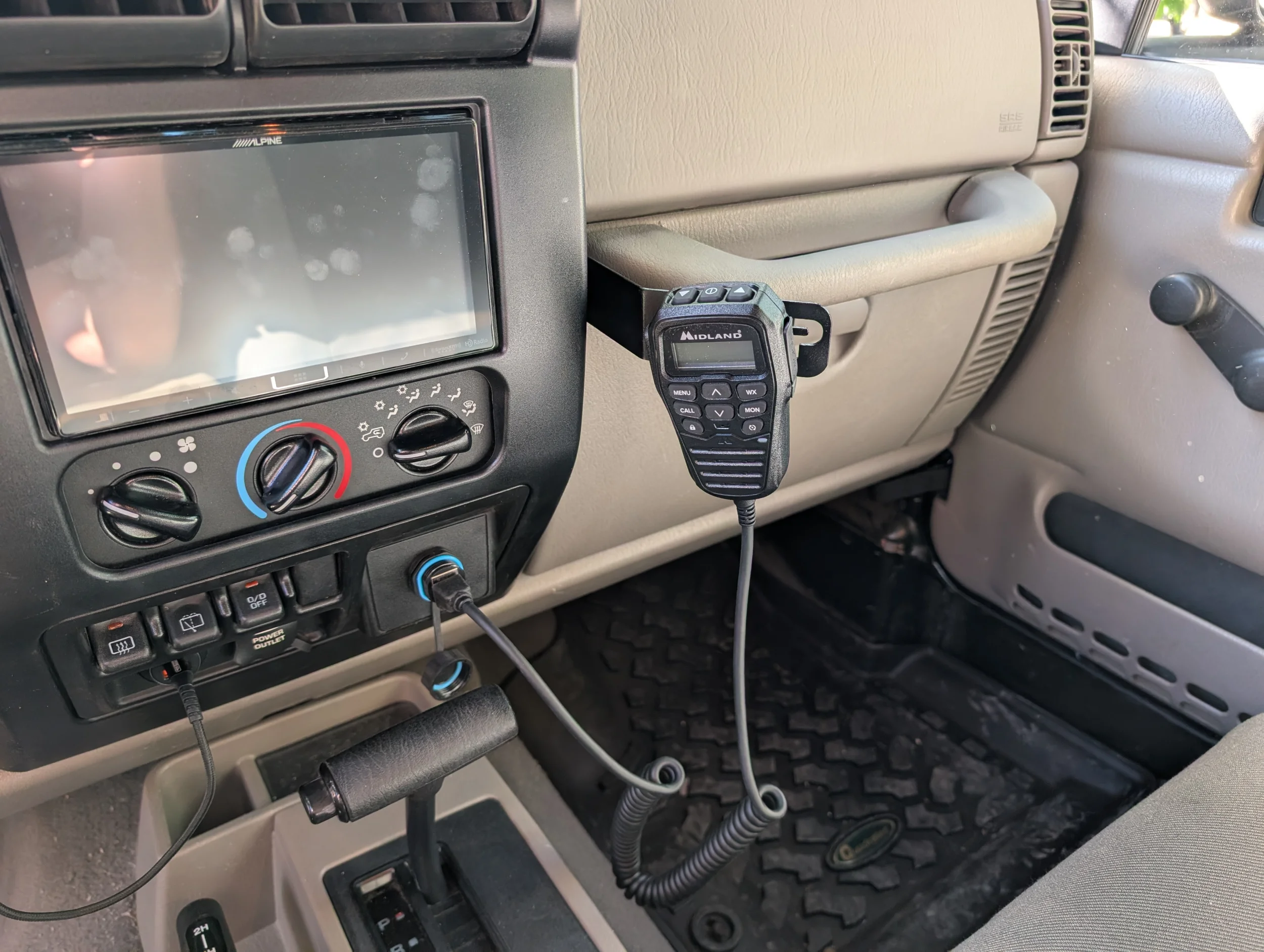

I did like the functional 6 disc in dash CD changer that came from the factory. But I wanted to modernize and upgrade the sound. I grabbed a double DIN kit and put in an Alpine head unit. I wired up a backup camera, upgraded the factory speakers, and the factory sub. I found the thread here about the MTX subwoofer upgrade and used that as a template

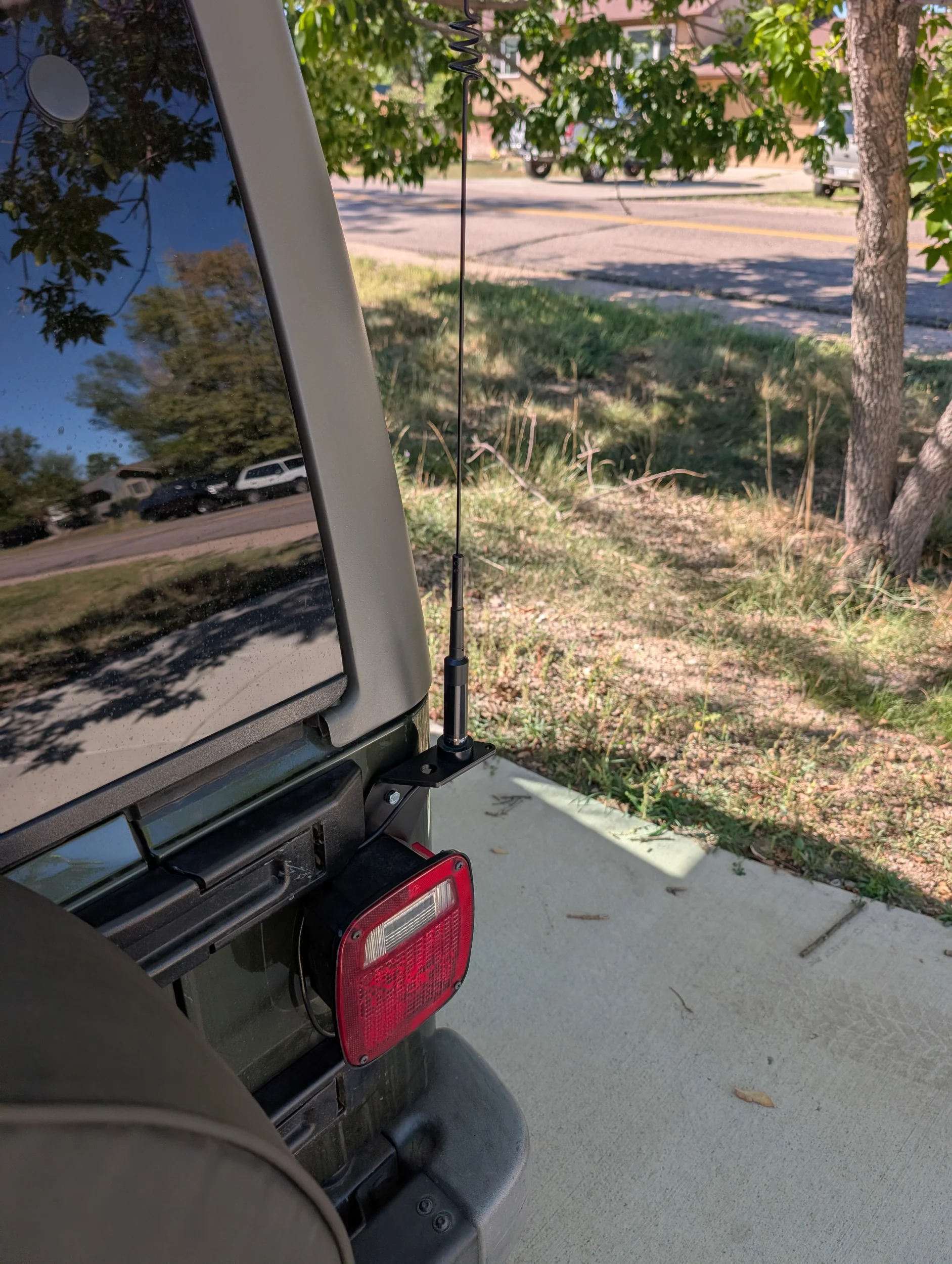

I also decided to add some trail comms. I found a bracket on fleabay for a Midland MTX275 GMRS. The slightly modified Terraflex tail light antenna mount works well. No good pics of the radio but I like the way the antenna fits.

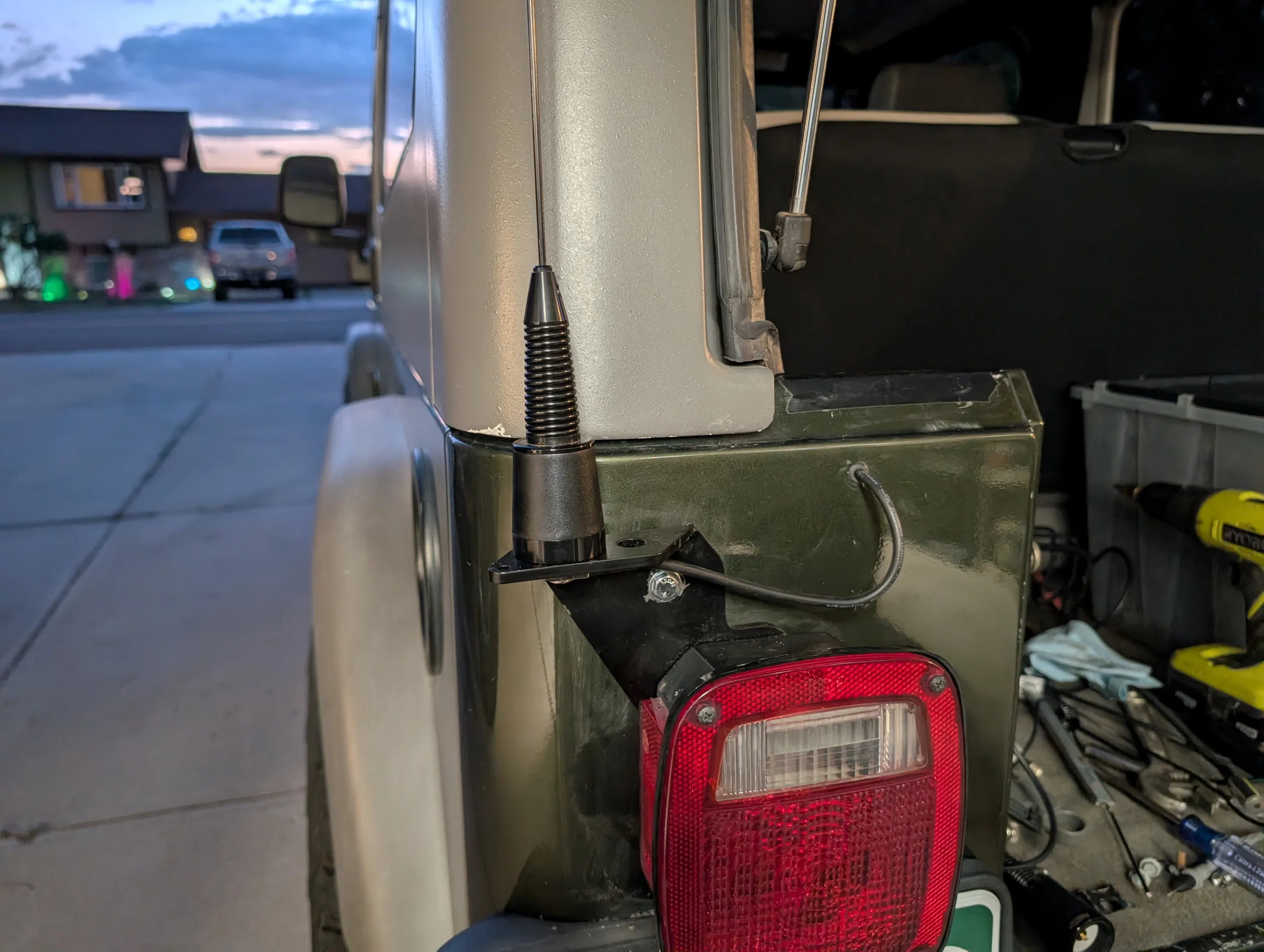

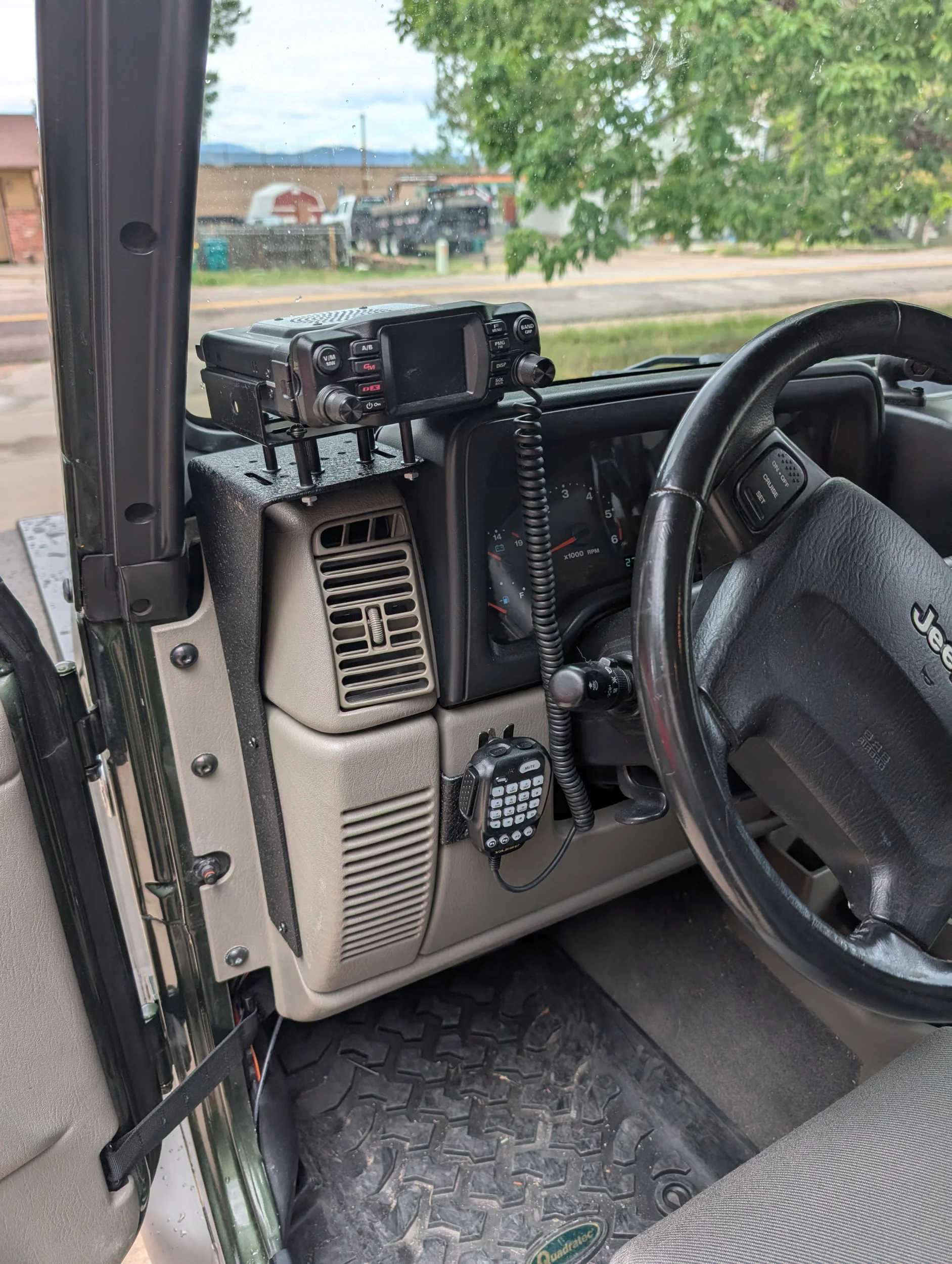

I also added a ham radio using a modified CB mounting bracket. The antenna is on the matching brake light bracket on the passenger side. I managed to find an NMO antenna cable that was just long enough to go from the passenger rear to the driver side dash.

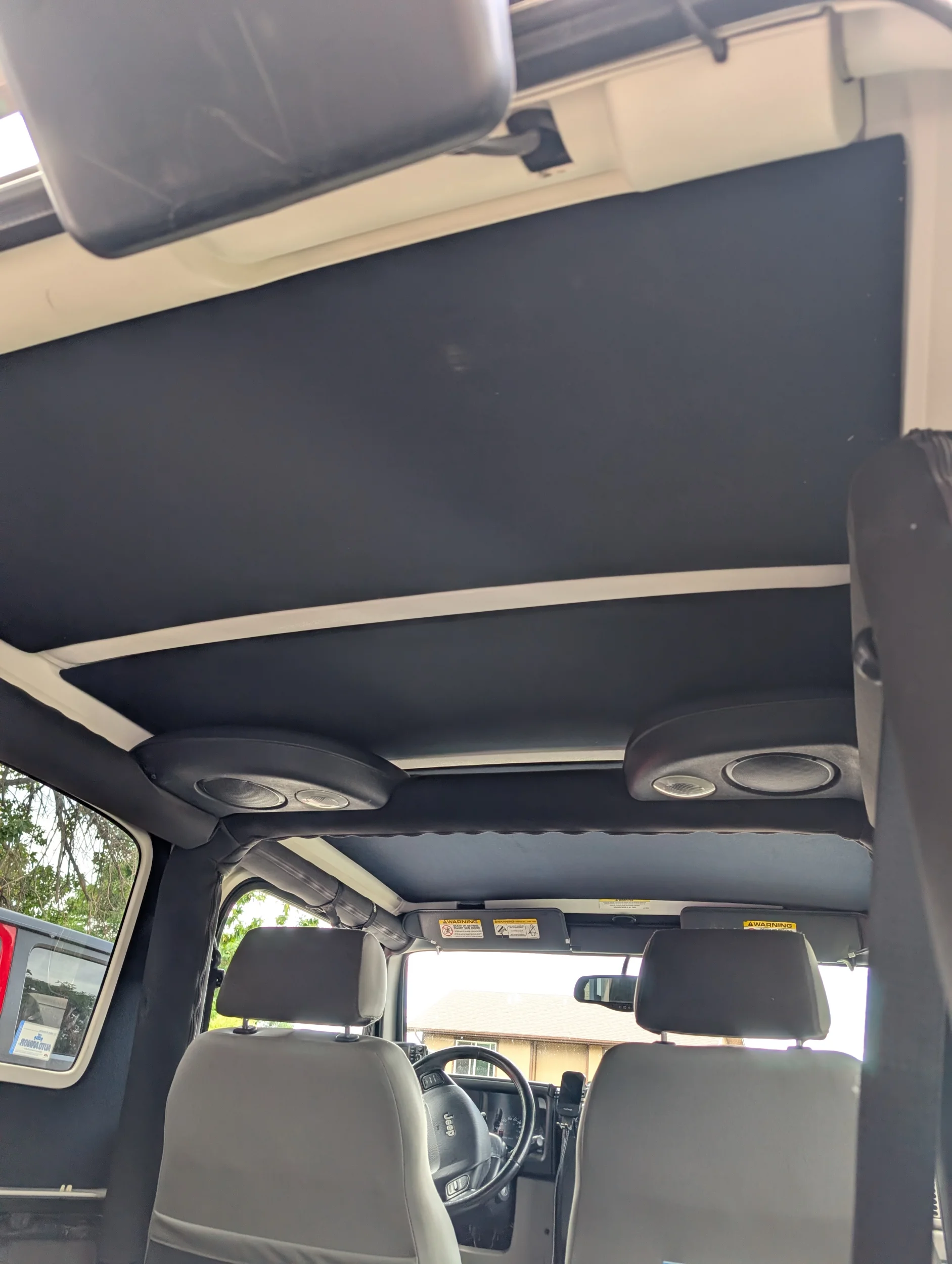

Lastly, I put in some hothead headliners to keep the heat down in the summer and help keep heat in during the winter.

I was waiting for the paint to cure on the microphone mount but now the GMRS radio is ready.
And I didn't get a picture of the ham antenna before.
