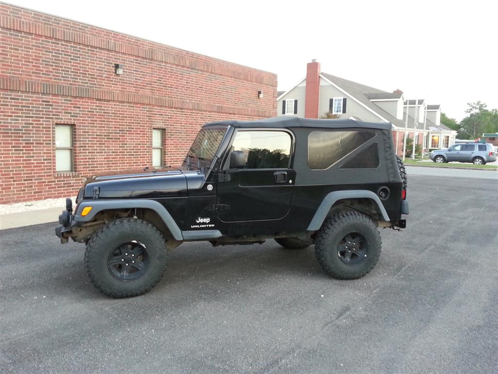

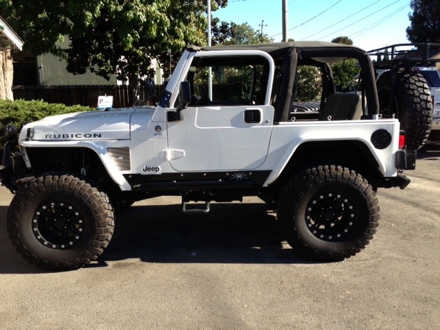

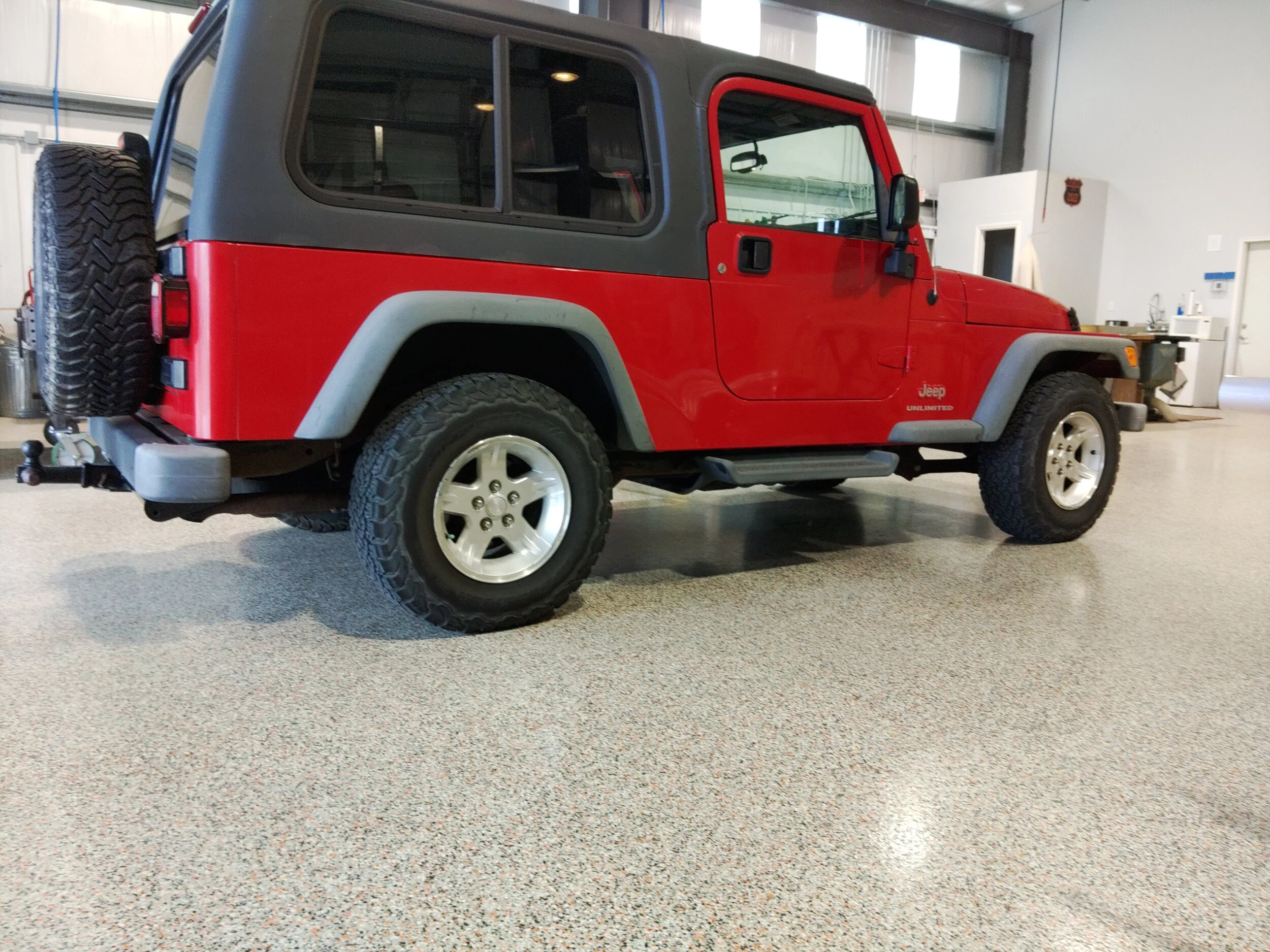

Photos for reference.
This was a 3" Zone lift with 33x10.5 BFG KM2s and stock wheels, which create a more narrow stance. Another path is 33x12.5 with spacers or more backspacing but I prefer the tighter look and the better steering performance.

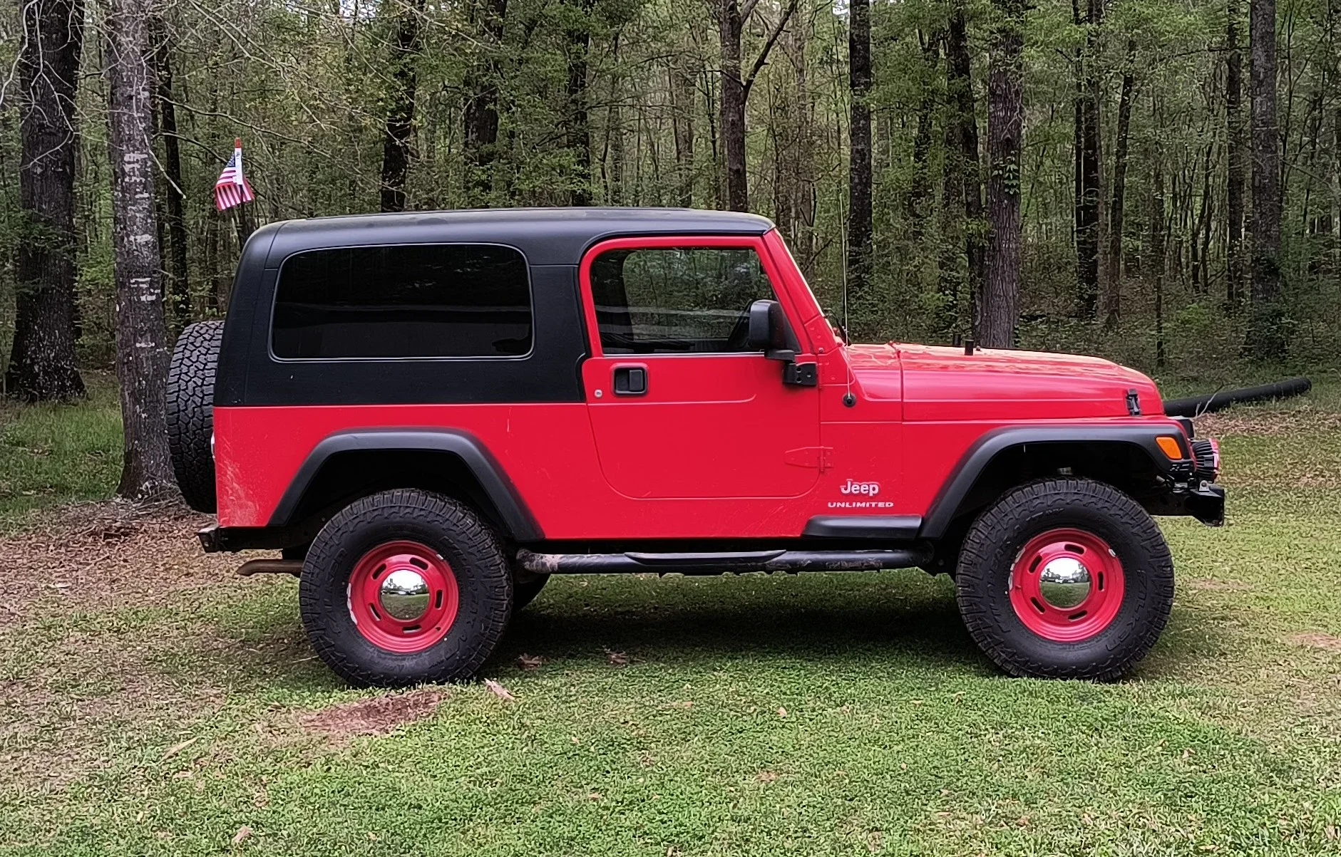

We will be flat towing behind motorhome.

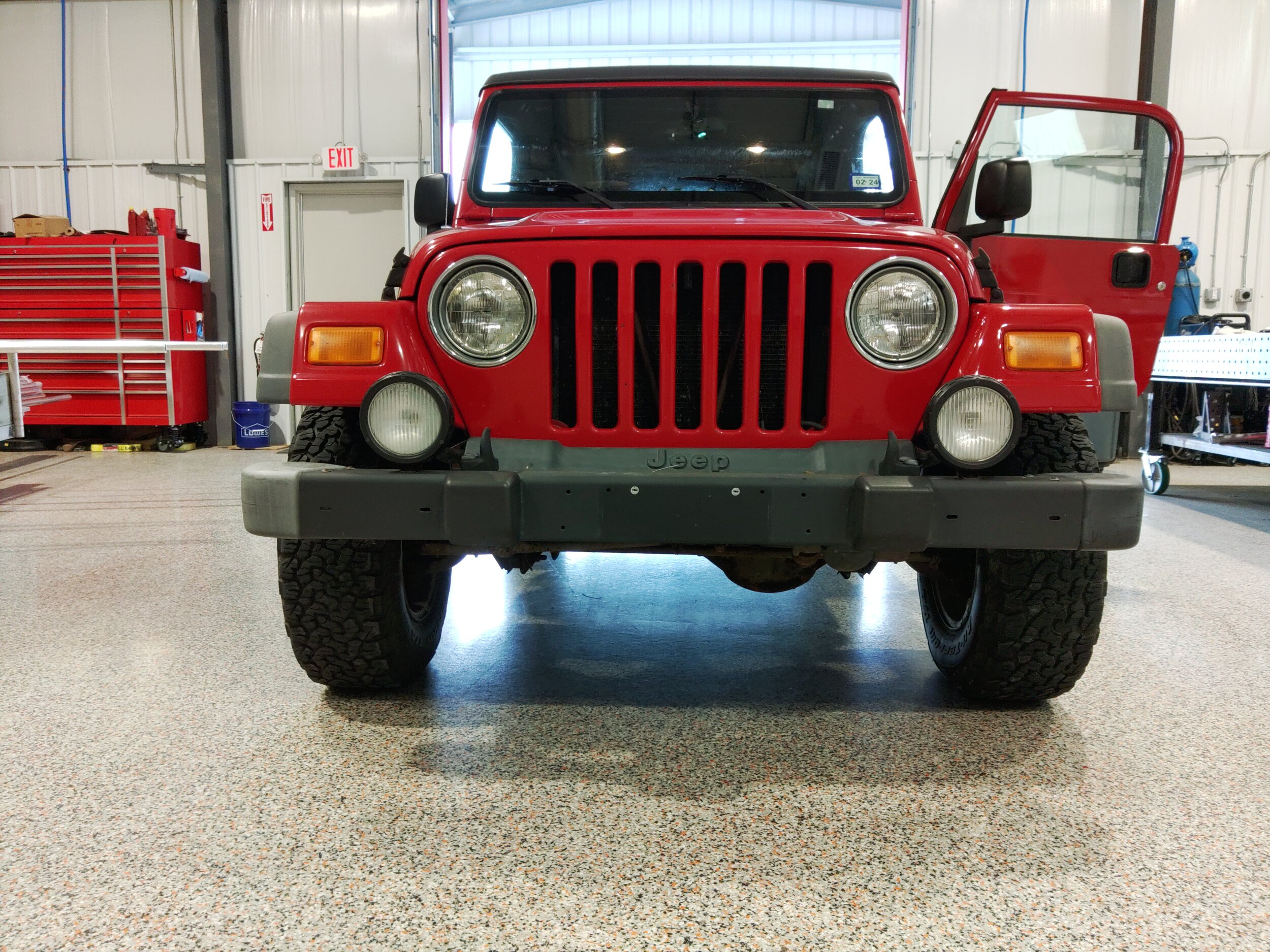

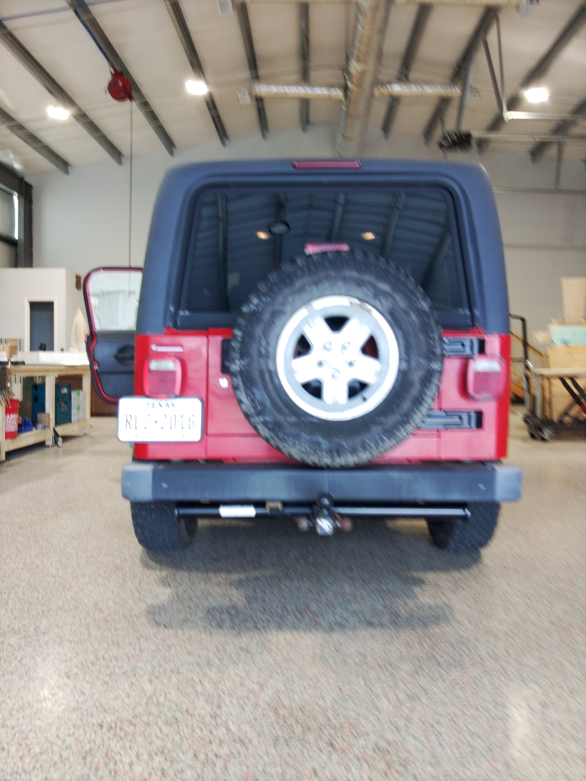

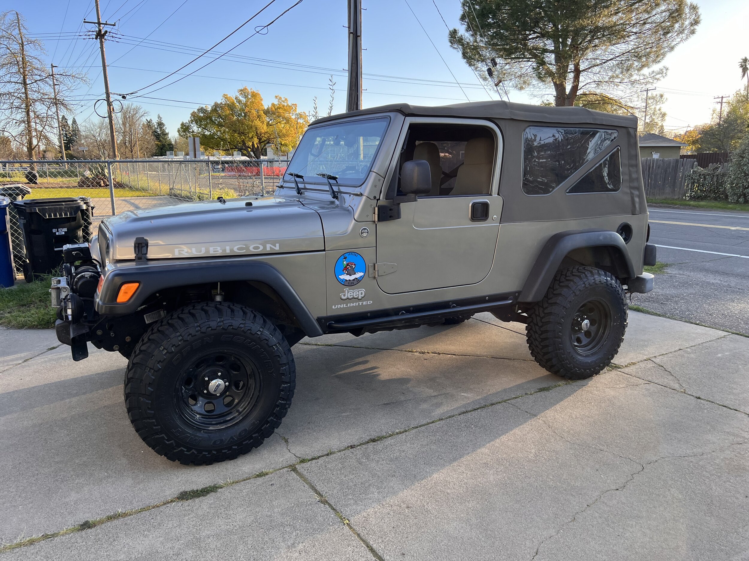

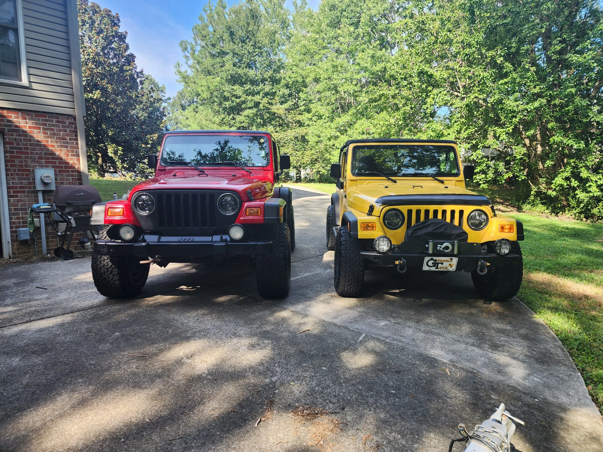

Took a couple of pictures of it. My wife is 5'5" and has no trouble getting in and out .

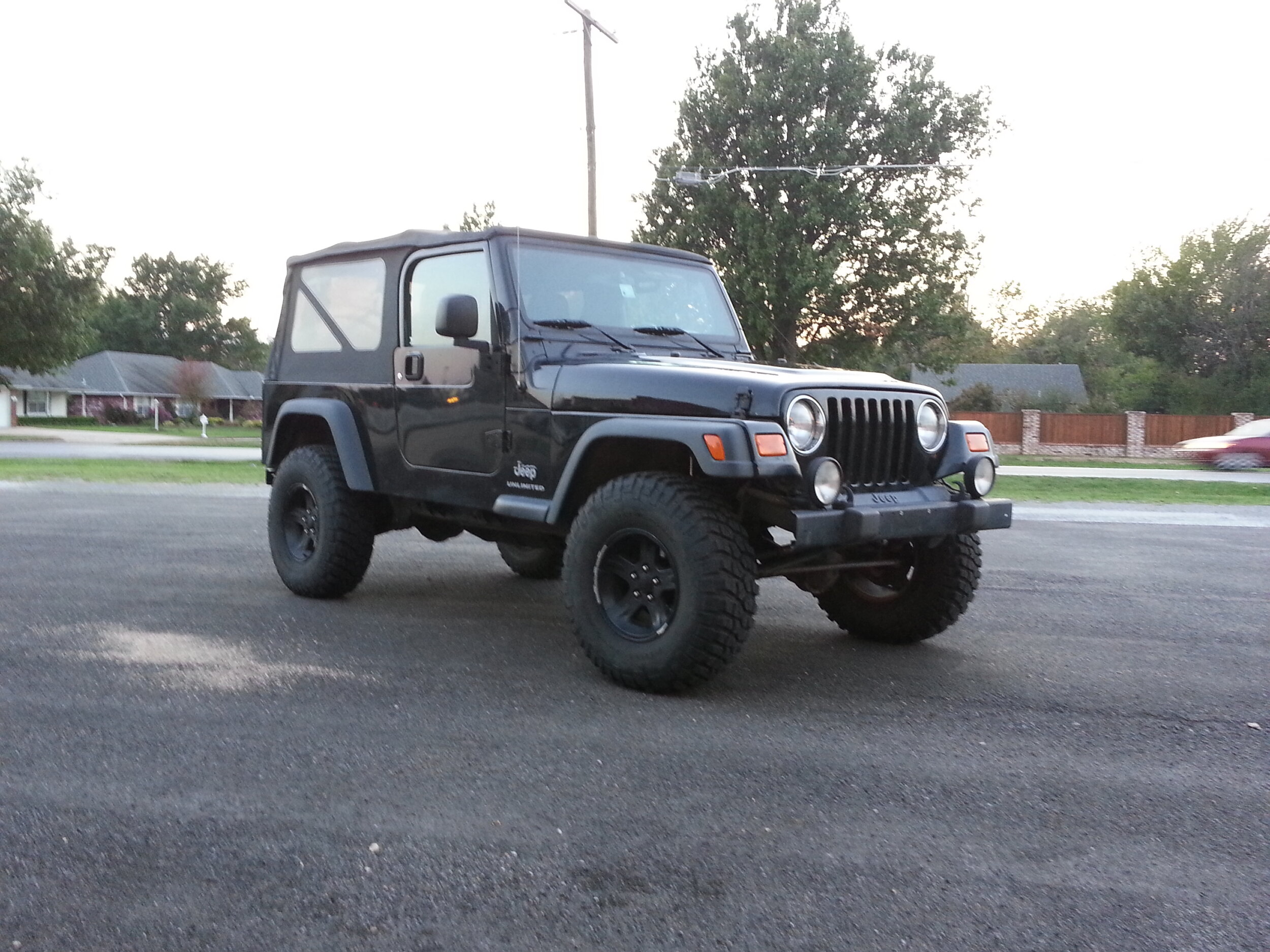

Ours has 2 inch OME springs on the rear and 2 inch OME springs on the front with 2 inch Streetray spacers to help level it out . The front springs are 11 years old and settled in to about a 1 inch lift after adding the winch .
Tires are 33 inches tall.

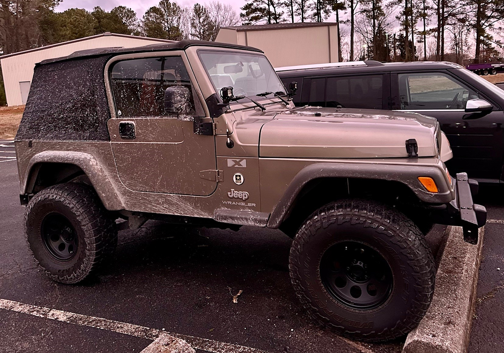

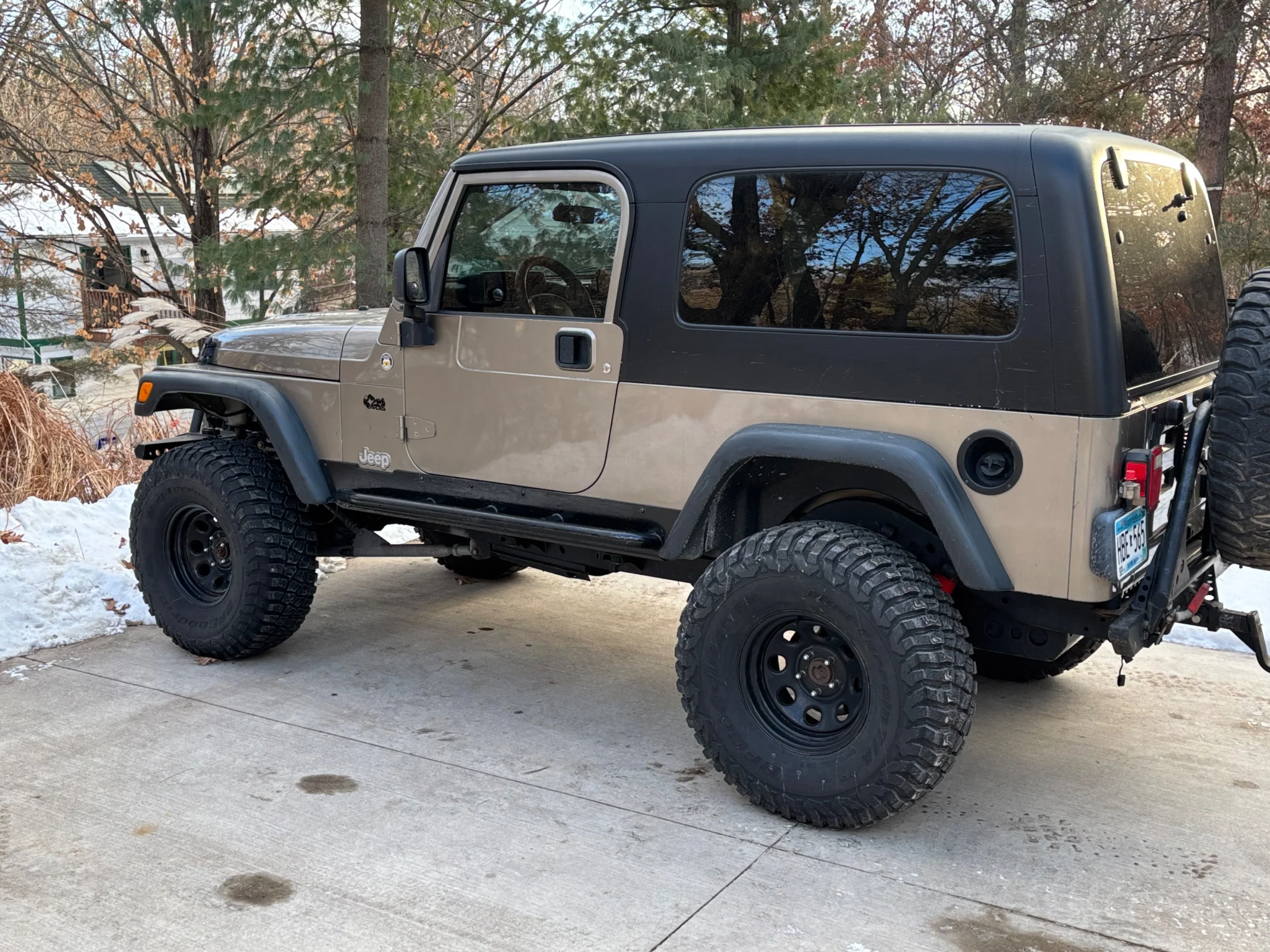

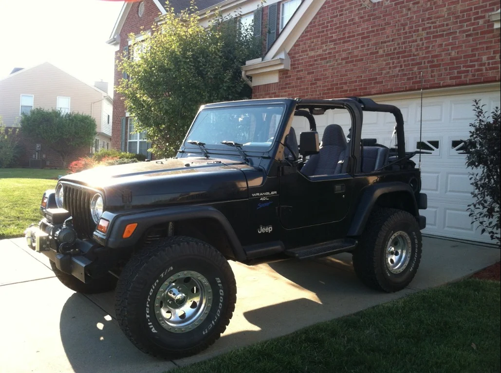

Man I need to clean my Wheels, they look so shiny in this old pic. When I first put on a 3 inch lift with BFG AT 33x12.5x15

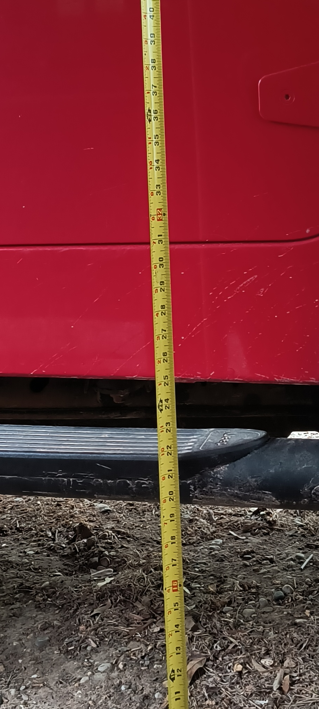

My Wife is 5/1 and does need the step to help her get in. Sometimes I'll pull up to a curb if i am in a parking lot to help her. I think the image above with the tape showing it's 25inches explains it best but, even then you have to get your foot above the body another 6. If it didn't have those side steps she'd need a portable step.
