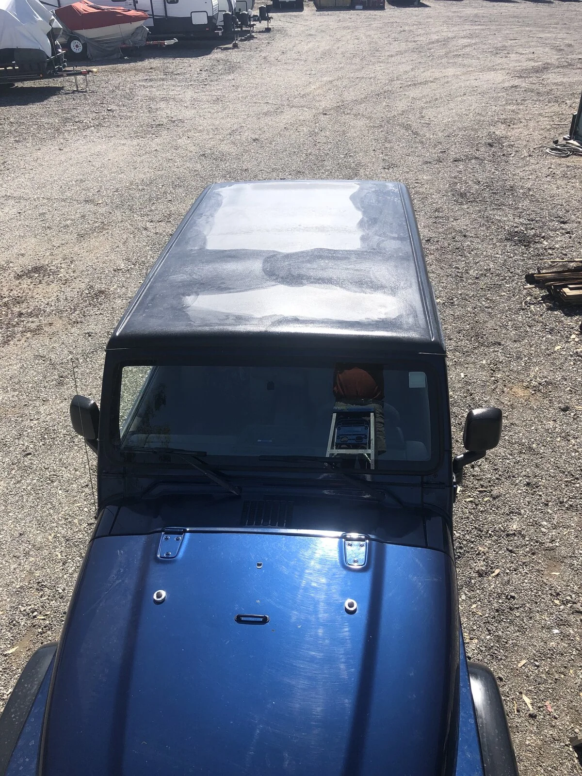

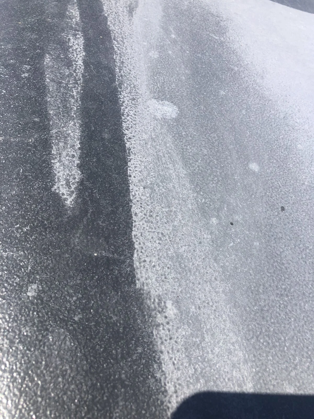

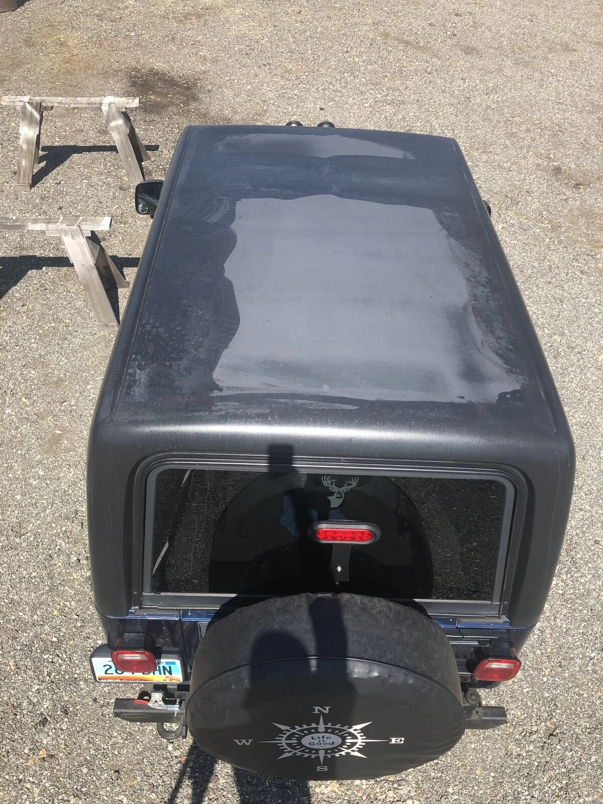

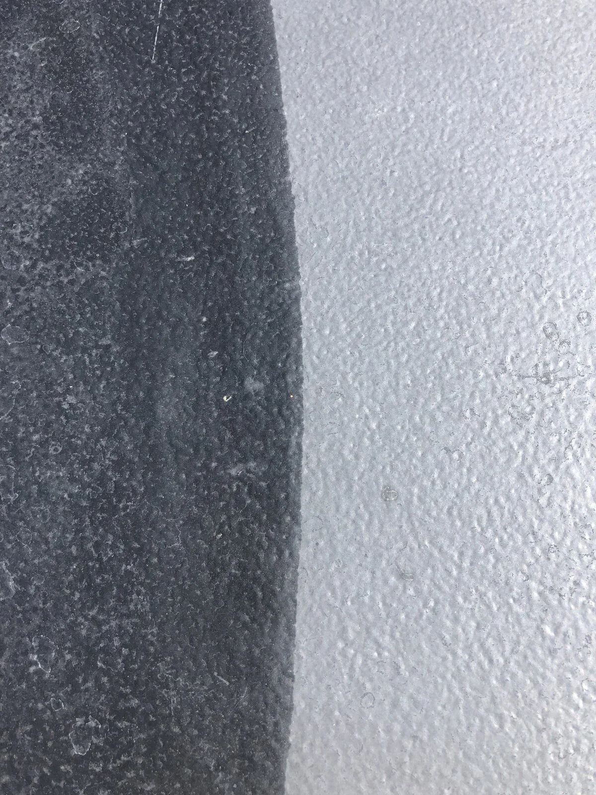

I finally removed and sold my Gobi rack. The PO applied some type of protectant to the hard top and missed 2 areas that were inaccessible due to the rack. I have no idea what he used. The flares are also treated the same. When I bought it I did not notice this and therefore did not ask him what he used. It appears to have been applied with a cloth, darkened the grey to a black and has a gloss finish. The bare areas are very oxidized and I need to treat them and try to keep the same look as the rest of the top. Whatever he used seems to be very durable and not some cheap product. Any Ideas of what he may have used? What do you use on your Hard top to remove oxidation and protect it? I believe this is an after market top.

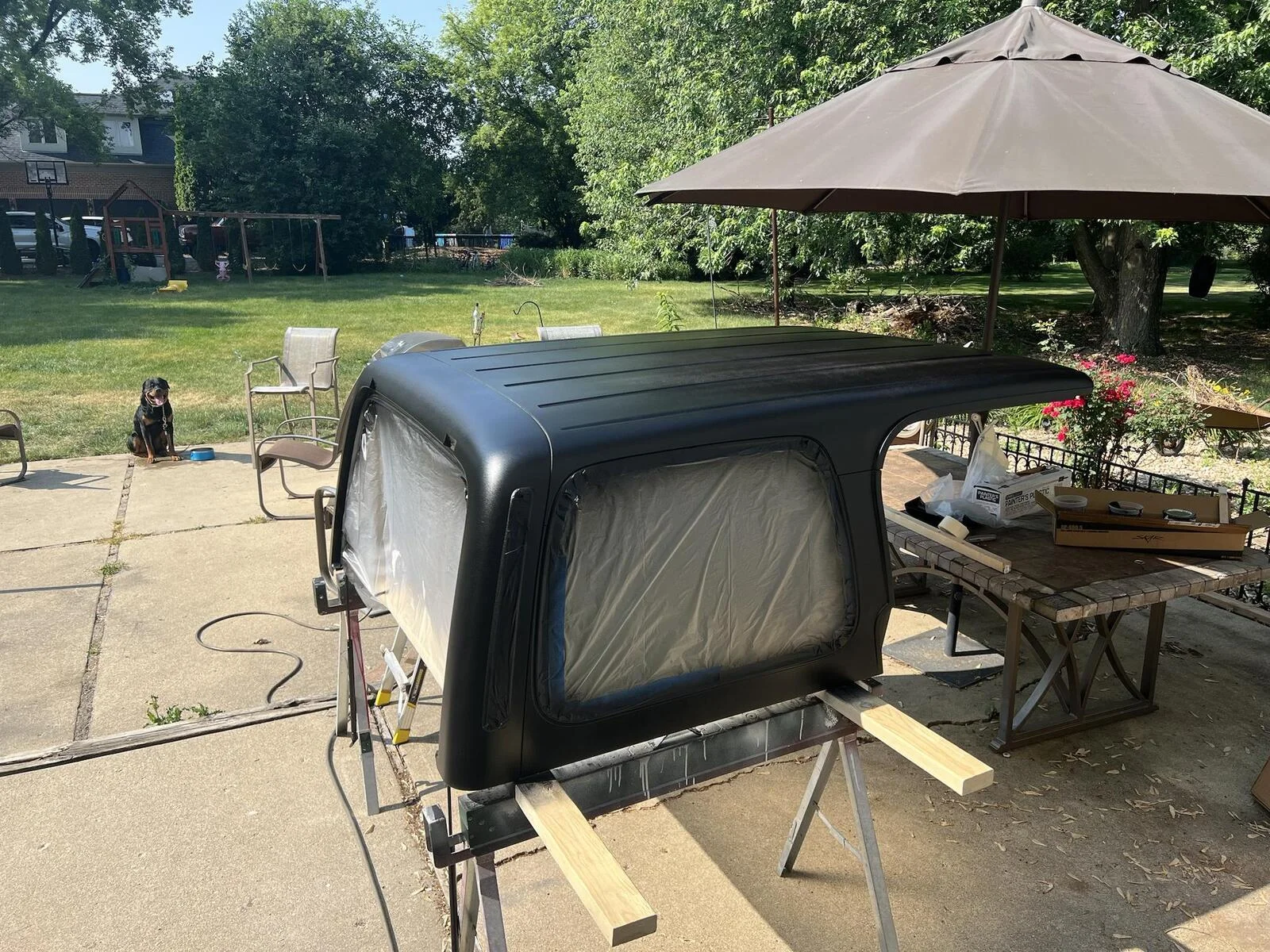

Take the top off, and place it on an elevated surface. Clean it thoroughly with a degreaser / cleaner (I just use Simple Green) and allow to dry for a day.
Take the rear glass off, and weatherstrip. Take painters tape, and painters plastic and tape off all windows and trim.
Go buy a quart of Rustoleum oil based Satin Black paint @ home depot , Lowes, Menards, etc. its about $17
Mix it 3:1 with acetone and pour into an HVLP gun, and spray the entire top several coats. First coat should be light and thin, then go heavier. My top I just got was faded beige, and its now Satin Black
Heres a quick video.
Keep in mind painters have so many mix ratios. The 3:1 worked great for me

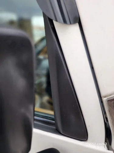

I had a similar problem with the side plastic on my doors, fender plastic, and outside mirror plastic. I brushed them with Soilove to clean them really good using a plastic brush and rinsed immediately and dried them. Soilove is real good stuff. It is better than the Bug and Tar cleaner from Turtle wax. The Soilove brought the dirt off in piles. The Bug and Tar did nothing. Then I coated them with Meguiars Supreme Shine and I didn't remove it. I did it at night so that it wouldn't evaporate in the heat of the day. Here are the before and after pictures. I had the same problem with my fender flares and they look the same as the after picture here now. If you wipe off the Meguiars, it won't penetrate. I never wipe it off. If it attracts bugs, I just wipe away the bugs with the Meguiars Supreme shine wipes, and spray it again with the Meguiars Supreme Shine. If the top is painted, be careful with the Soilove, that stuff is strong. But, your top looks like black plastic, so it should be safe. The before picture is after 20 years of regular washing and drying. The after picture is when the Meguiars has pretty much evaporated on its own. I just recoat them after every wash for sun protection, either in the dark, or out of the sun. I try to dry my Jeep out of the sun, and then I spray my plastic and soak it.
