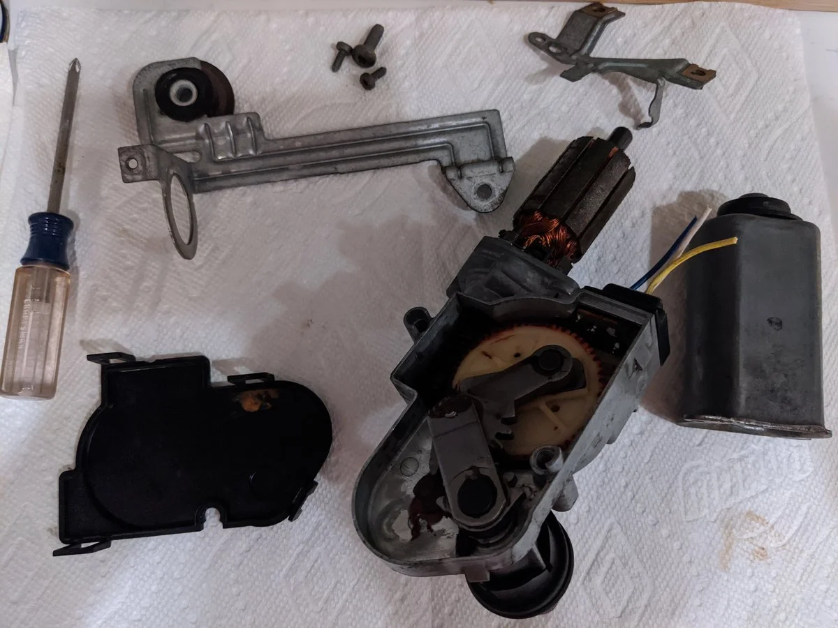

Quick update... I was stupid to try and use a front wiper motor - won't work.

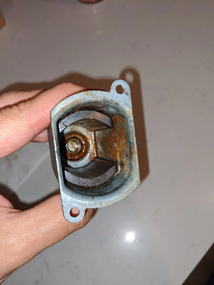

Anyway, I pulled the motor apart and found that there are two magnets on the inside of where the shaft turns. Seems like those are supposed to stay fixed to the sides of the housing in order to allow rotation. Mine were stuck the the shaft/transformer thing.
I know this isn't the most interesting thread, but I'll continue to update in case it's helpful to someone in the future.
Magnets in housing:

Yeah, I decided to just crazy glue the magnets back to the housing. I used WD40 and a brush to try to clean up the rust as best as possible.
