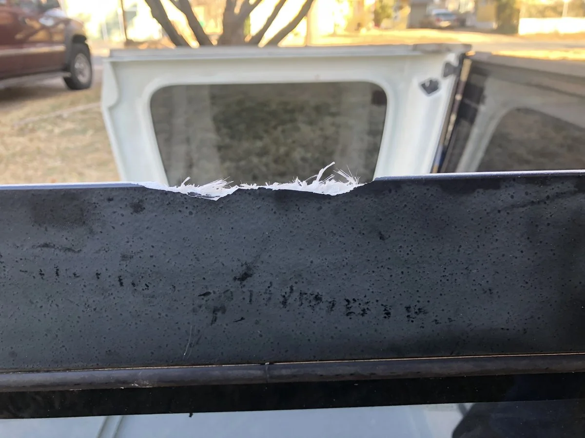

Can anyone help with repairing chipped Hardtop?
