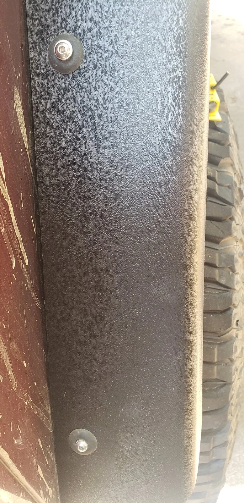

If you have all the spacers you just need to find any button head bolt that will fit through them, the nyloc nut, and 2-washers. For the body mounting mine was just self tapping screws for the rear. On the front it was countersunk head for the upper fender mounts, and a shorter set of the same bolt/nut/washer for the lower fender mounts. Then the grille support nut you probably have right now and a final button head bolt/washer/nut.
They’re not super special, you can build out the set at ace or Home Depot for sure (unless they’re out of a lot).
