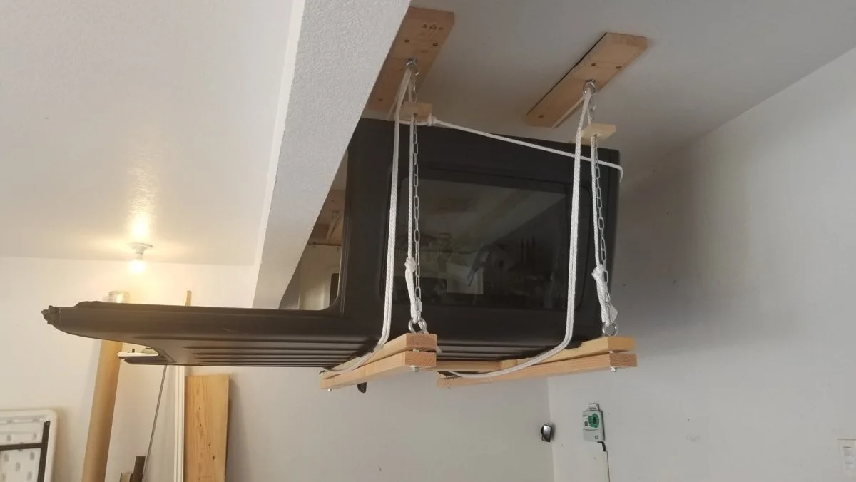

We store our Jeep Wrangler 2016 JK hard top upside down hanging from the garage ceiling using an inexpensive custom hoist / lift to get it up there. Our garage ceiling has an odd shape so we were forced to build a DIY custom jeep wrangler hoist lift. Total cost to make this was about $100. We skipped the electric hoist / lift and just used a tow rope attached to the jeep front bumper hook to simply back up the jeep, which smoothly lifts the hard top right up to the ceiling. We then clip it to the chains shown in the picture to hang for the summer. If you want the parts list, just message me. Building the lift was a one-day job. Each spring, it is super easy and only takes a few minutes to pull the top off the jeep, lay it on the lift, and run it up to the ceiling. Since the jeep is doing all the lifting work, no one has to be very strong to handle the hard top.

You invested $100 in your hoist system? Usually these kinds of jobs cost around 30-40 bucks if that. Why was yours so expensive?

looks very well done. looks like you actually found joists, rafters to screw too rather than hollow wall toggle bolts
unfortunately, effort wasted an a JKU.
Thankfully, the beer was free thanks to two neighbors that came over with perplexed looks of disbelief and slight fear during construction and lifting. I suspect there was a bet going against me, primarily due to my hoist-free approach using the Jeep to pull the top up in the air. Anyway, since this hangs directly over my jeep hood, I had serious fear of it breaking loose and trashing my front end (does insurance cover that?). So it is definitely overconstructed everything. I'm surprised but the parts list really added up to more than I expected...it was closer to $150 when I add in the parts for the actual lifting. Here's the list... Four 2x4x8's=$12. One 2x6x8=$6. Two 1x4x8=$12. Eight 1/2" Eye Bolts=$16. Eight 3/8 Quick Links=$12. Chain=$10. Rope=$15. Eighteen GRK Fasteners Star Drive Washer Head RSS Structural Screws=$20. And for the parts to do the lifting up to the ceiling...30 foot Tow Strap (my 20 footer was too short)=$22. Two Stainless Steel Spring Links=$16. Wall mount tie down ring=$10.
