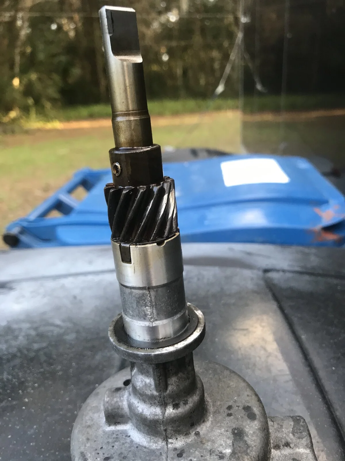

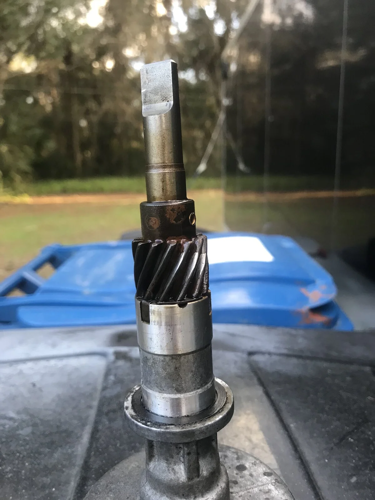

Ok well thanks to the forum here I ordered a crown replacement and fitted today. All seems well. Engine quiet no noise at all and runs great. I didn’t have any codes or oil pressure drops… just the screech. I included pics of old unit. From the little I could see cam looked ok. The old Opda has some wear but less than I feared. It was stiff however. The pics actually make it look a bit worse than in real life
So, all seems good… thanks!

You should be good to go.
