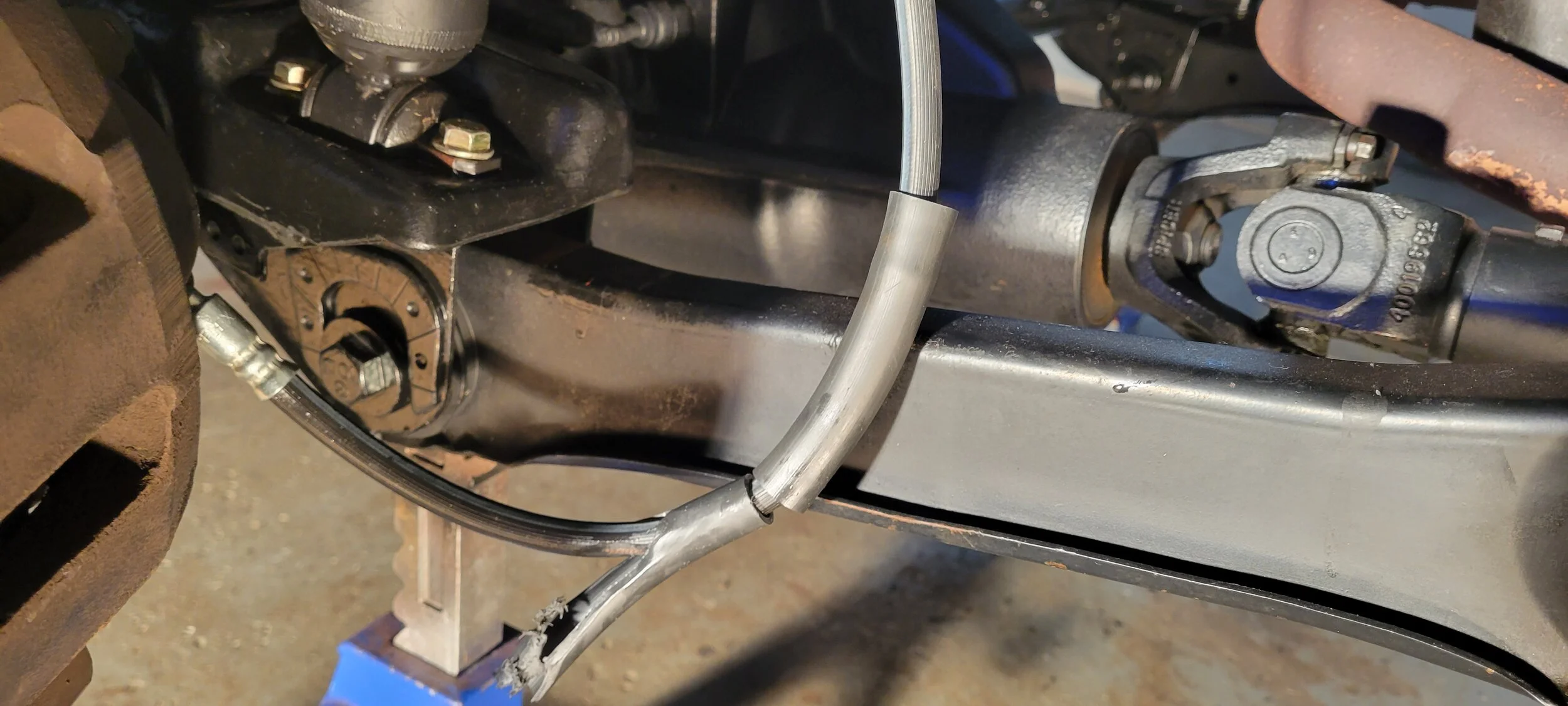

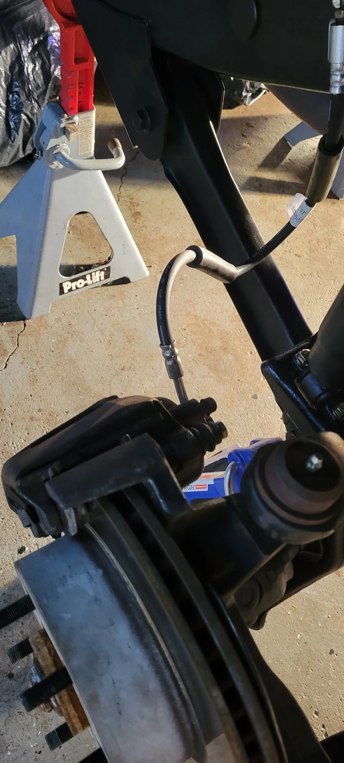

So I'm having some difficulties here with the extended lines I'm using. I had both driver and passenger lines orientated the same way to copy the stock set up. Essentially the beginning portion of the hard line by the caliper is kinked upwards slightly, with the flex line facing towards the back of the jeep ( 2 o clock position). But for some reason only the driver side line started rubbing. The driver line initially was away from the tire, but if pulled outwards will rub on the tire and stay there indefinitely. The passenger line can be pulled outward to a position where it could rub the passenger tire, but it immediately bounces back to center without any assistance. This will make more sense when you look at the pictures I took.
Passenger

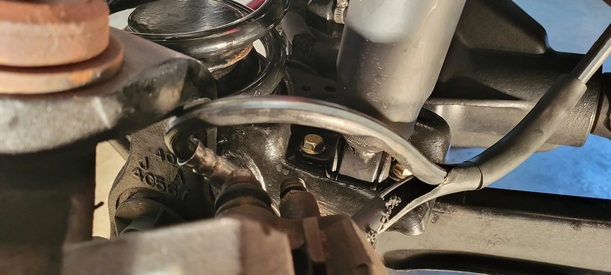

I don't know why the driver line is flexing differently. The only thing I can think of is something must have gone wrong with placing the upper bracket, although it looks centered on both sides. The passenger side didn't have any issues installing the bracket with the hard line. But the driver side was a bit tough to get placed in there, I had to fight it a bit. I assumed this would be a non issue because between the bolt, the hard line, and the hook going into the hole it should center itself. Maybe there is some room for placing it every so slightly off center?

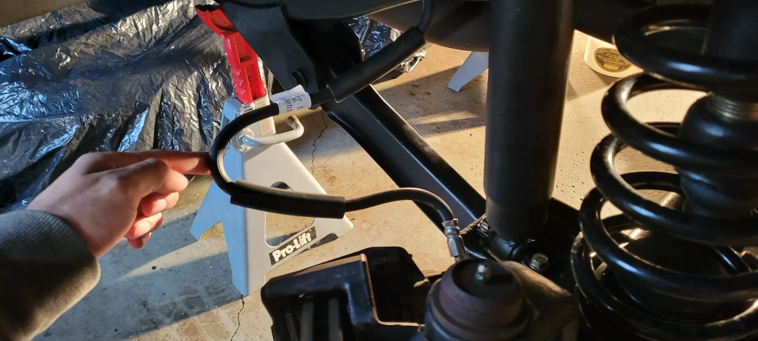

The passenger line I left alone for now because I think it's okay/more or less road worthy. it doesn't rub lock to lock. I can't test it for full stuff because the suspension, springs, etc is all in there. Measuring for full droop is pointless because the more it droops the more the slack will be taken away anyways, circumventing the problem. Axle is on stands, no stands on frame, suspension at ride height.
The driver side I tried flipping around, that was not the answer. None of the positions worked. I flipped it back to the proper orientation (kink facing upwards at hard line) and tried 2 positions. Facing upwards, and facing downwards. ( The original position was facing outwards towards back of Jeep).
The upward facing position seems to work well at center and full lock pass. At full lock driver however it makes contact with the inner c of axle. It doesn't rub too hard but it does make contact for sure.
Facing downwards is not ideal because of the risk of the line being snagged in an offroad situation. But I like this positioning better, it eliminates some slack that was causing the issue. At center and full lock passenger all good. At full lock driver it rubs on control arm. It doesn't rub as bad as the upwards position did on the inner c. It sort of just slides up against the control arm.
Full lock driver:
Any thoughts as to what I should do? I have the Rancho RS55239 shocks so the stock brake lines will not be ideal to say the least. I'm thinking of running it with the driver line facing downwards and doing some test driving. Clamping it down to the shock is another idea but I'm not sure the best way to handle that. I know that was a lot of text for what many would consider a minor issue. but I spent a lot of time trying to clean up the axle and make sure the paint looks good. Removing and installing the brake lines, bleeding the brakes again and again, and getting paint stripping corrosive fluid leaking all over the place is not my idea of a good time. I already messed it up the first time, I want to do it right the second time.
