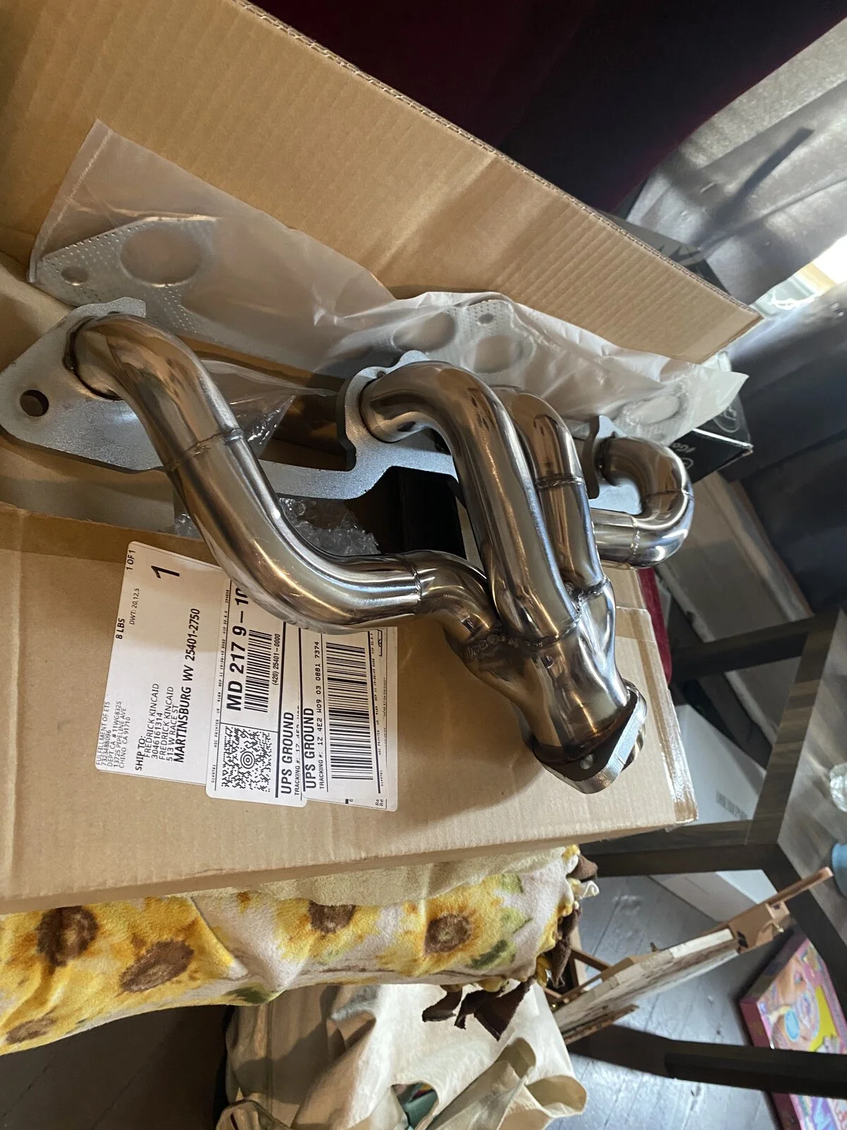

Just got mine delivered today from eBay. I couldn’t find a cheap SS one until another member on here pointed me in in the right direction. I paid $85 give or take after taxes for this one. Seems to be decent quality but I won’t get to put it on until tomorrow so I’ll have to let you know on that.

I've installed a few of those and for the price they're really not bad, when you mate the downpipe to the header give the bell a good schmear of anti-seize as it helps fully seat the joint to prevents leaks.
