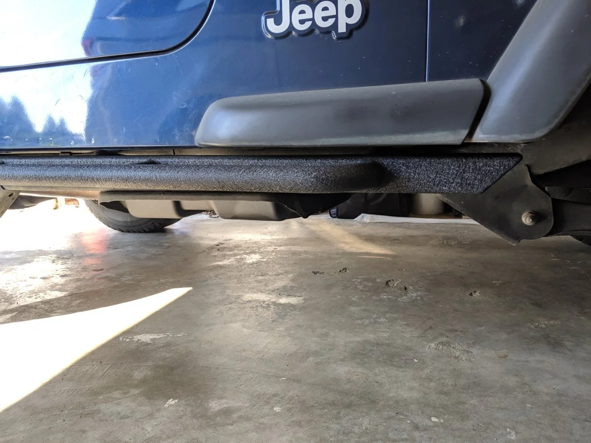

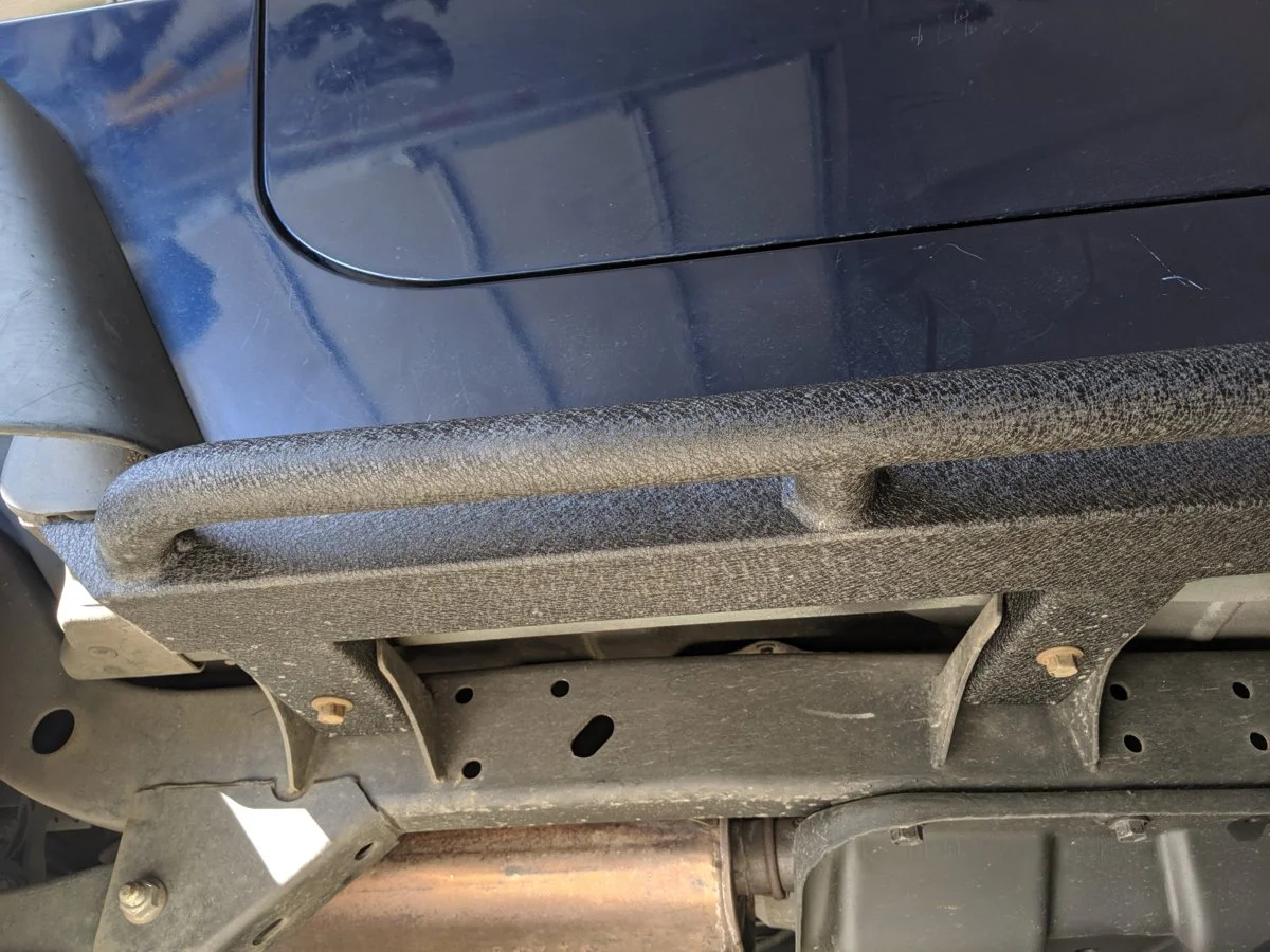

Which according to amazon should work in my 98 wrangler (has a 1.25 body lift), however it doesnt seem to be going in at all. I attached some pictures, hopefully someone is more mechanically inclined then I am can tell me what I am doing wrong. Thanks
These don't go here:
You've got those things installed completely wrong and then some. First off, they are upside down.
They shouldn't be on top of the body mount brackets, they go inside of them (or under them). Hard to explain, but the way you have it not isn't even close to being correct.
Hopefully I'm making sense. I had the same ones on mine with a Savvy 1.25" body lift.

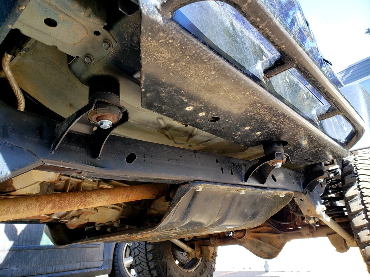

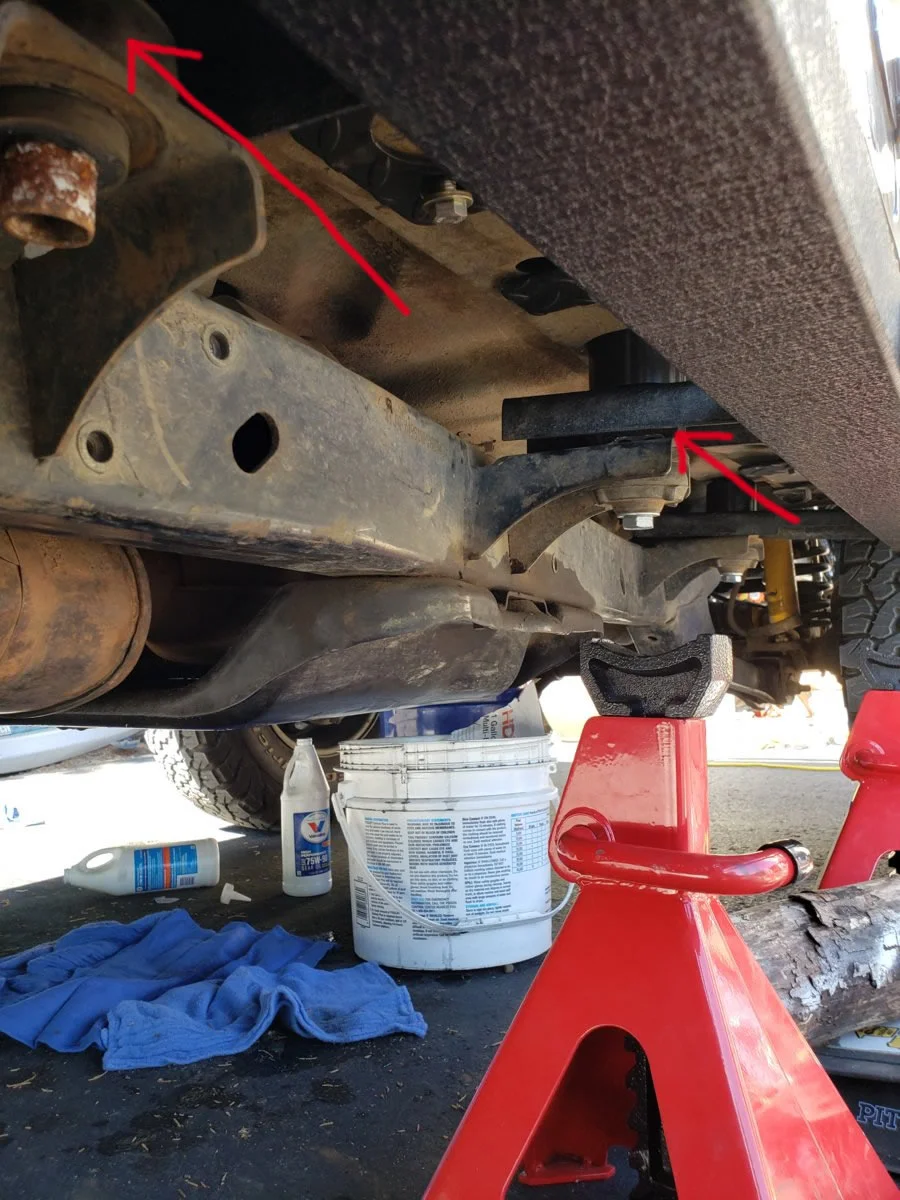

Let me clarify since you didn't seem to understand it the first time. Any designer that uses any aspect of the OEM body mounting system on a TJ to affix or support by any method, any metal appliance in the form of a rock rail that is intended to be used as such is a fucking moron. Do you need more clarification?
Go study the torque box. Spend some time analyzing it, over analyze it some, then study it some more. Certain things should become obvious after awhile.
1- there are only 3 points to mount a rail
2- the mount holes are not on flat surfaces, some are dimpled upwards.
3- the total combined torque of the 3 bolts is not enough to stabilize a rock rail that is used.
4- sheet metal is not a great material for large fasteners. It requires lots of small fasteners.
5- What the hell were you thinking?
From another thread in reference to using body mount bolts as anchors.
Not an issue for me as it's mostly dirt/mud/snow for me up here in washington. I dont mess around with that rock stuff :).

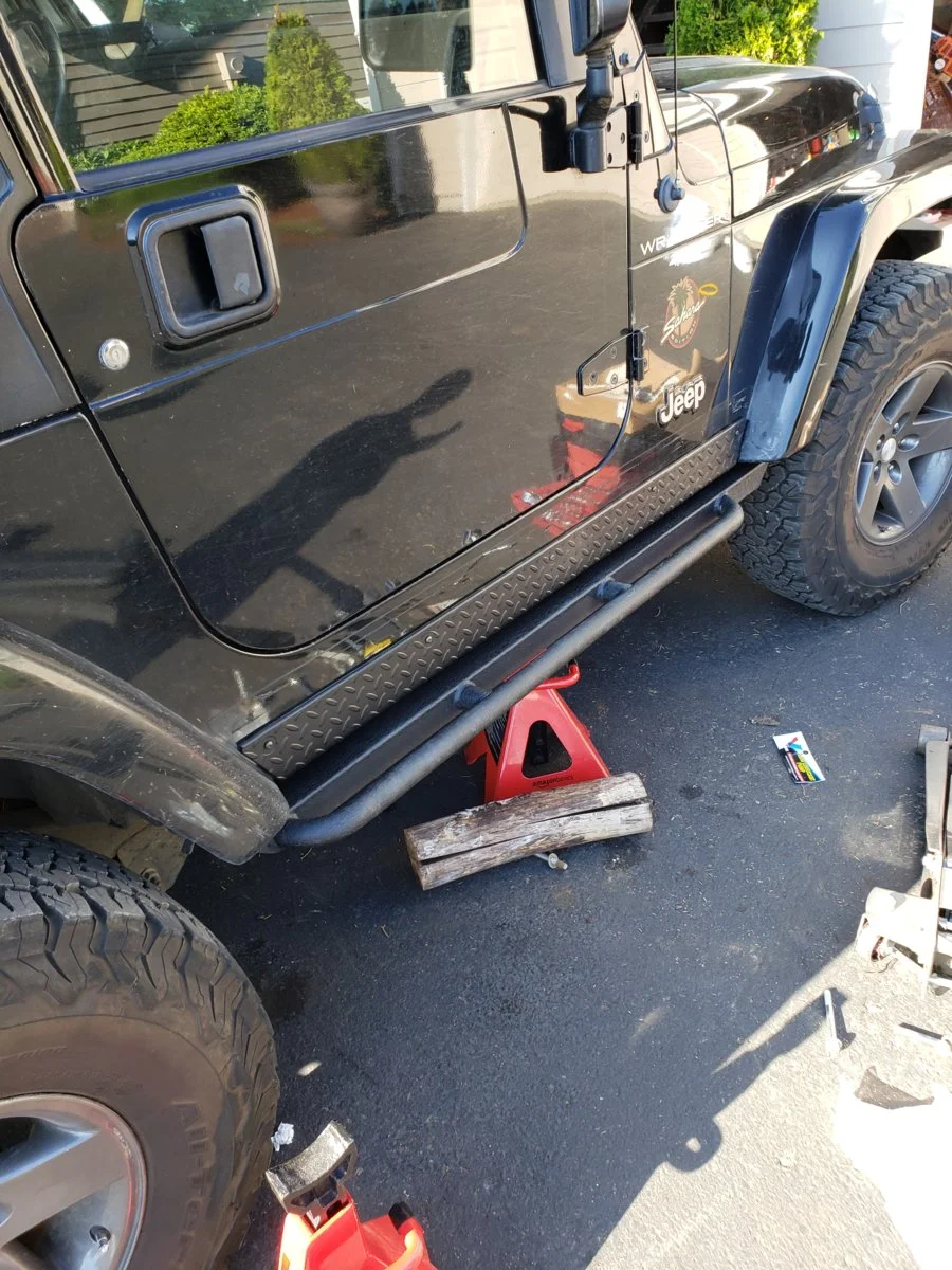

Side note i was able to get them installed ok

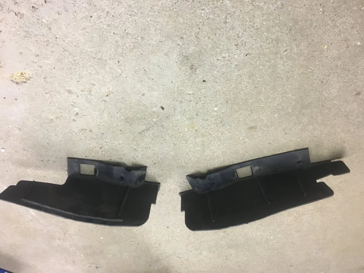

Has anybody seen these rubber liners, I manage to take apart the whole front end and for the life of me can't remember where they came from.
