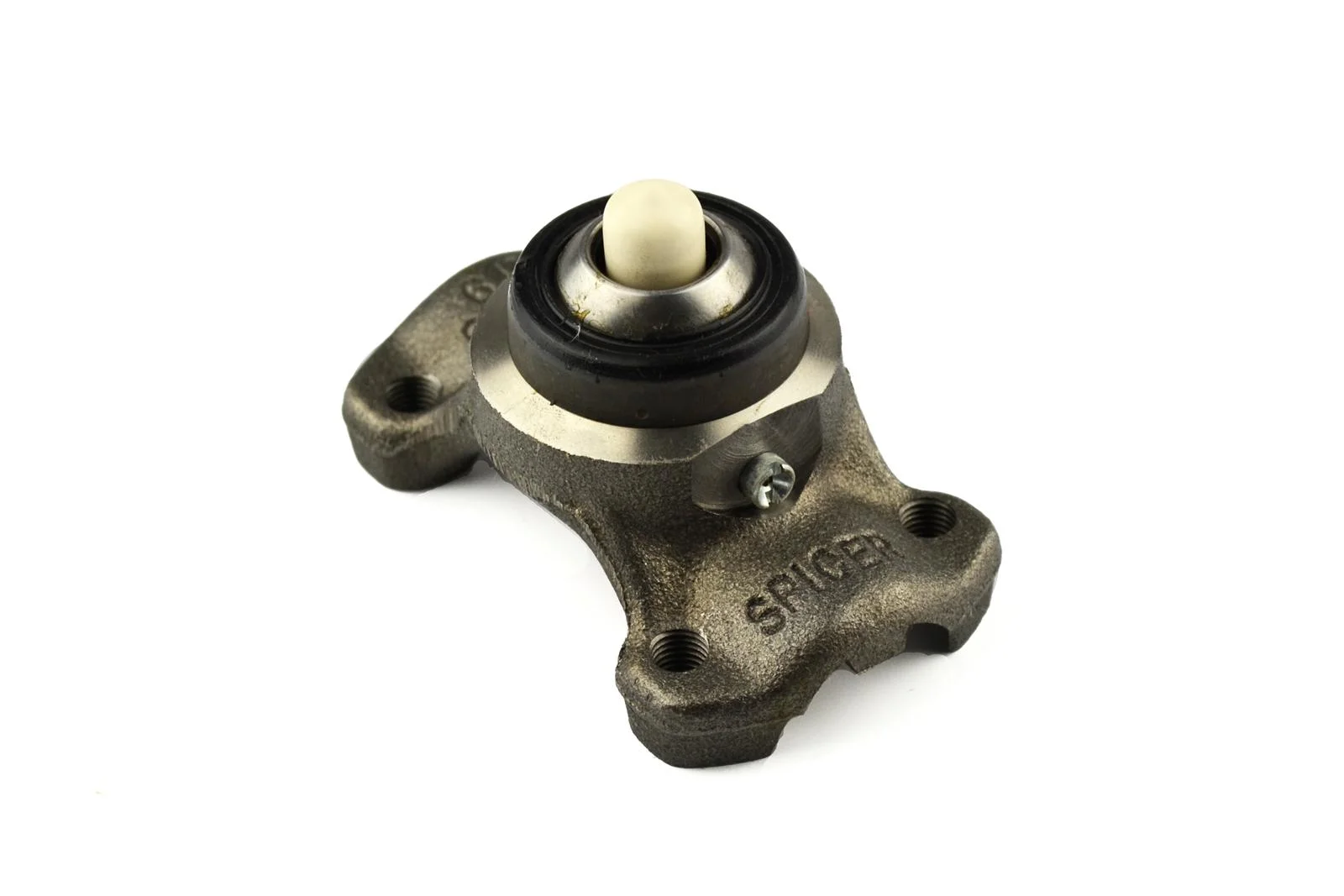

Did you replace the driveshaft U joints ?
Do you have a stock driveshaft or do you have a SYE ?
IF you have a SYE; did you replace the CV centering ball assembly ?
I do have a SYE, I didn’t replace anything on it; installed it a few months ago, no issues. I don’t even know what the centering ball assembly is!
