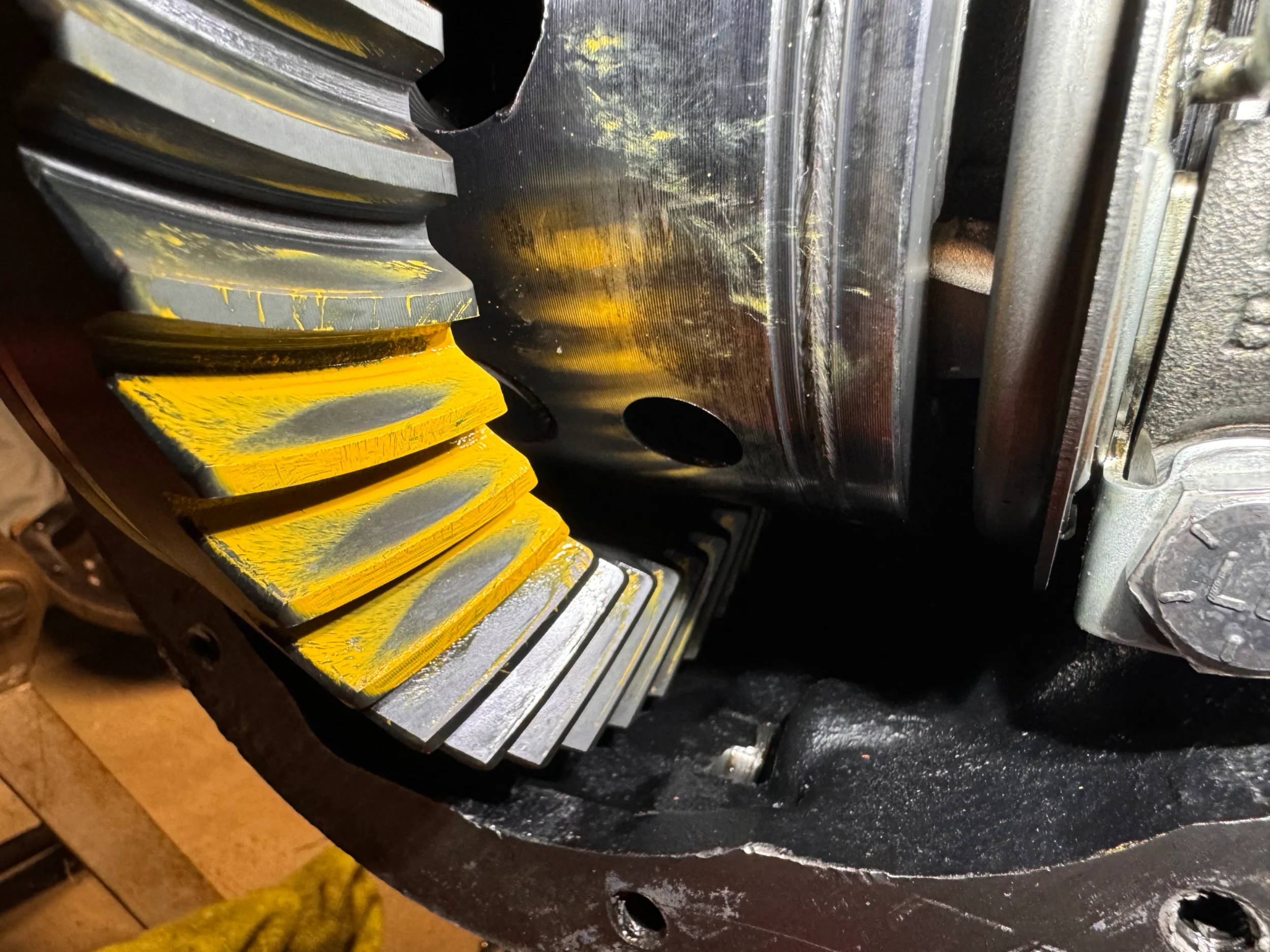

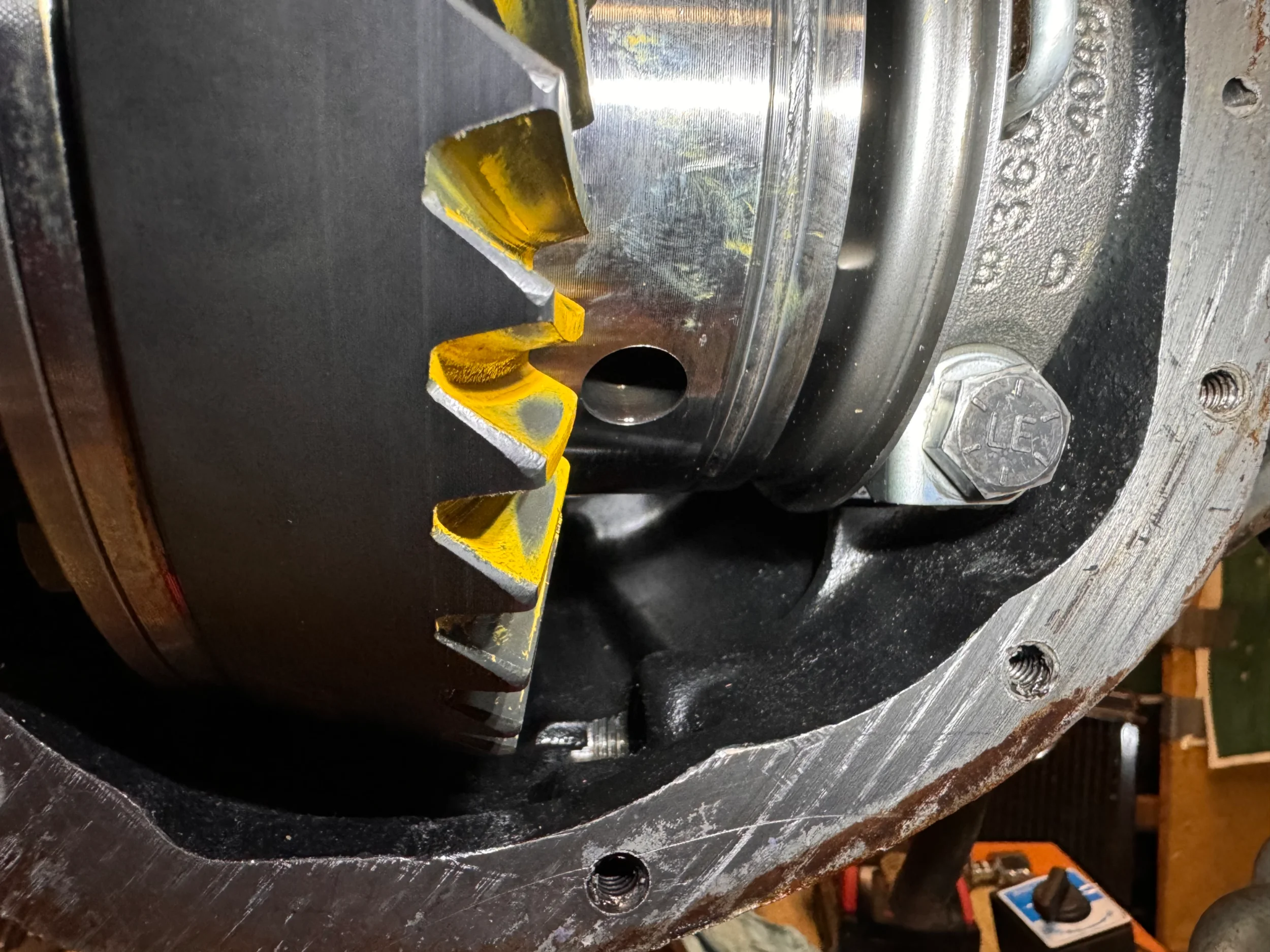

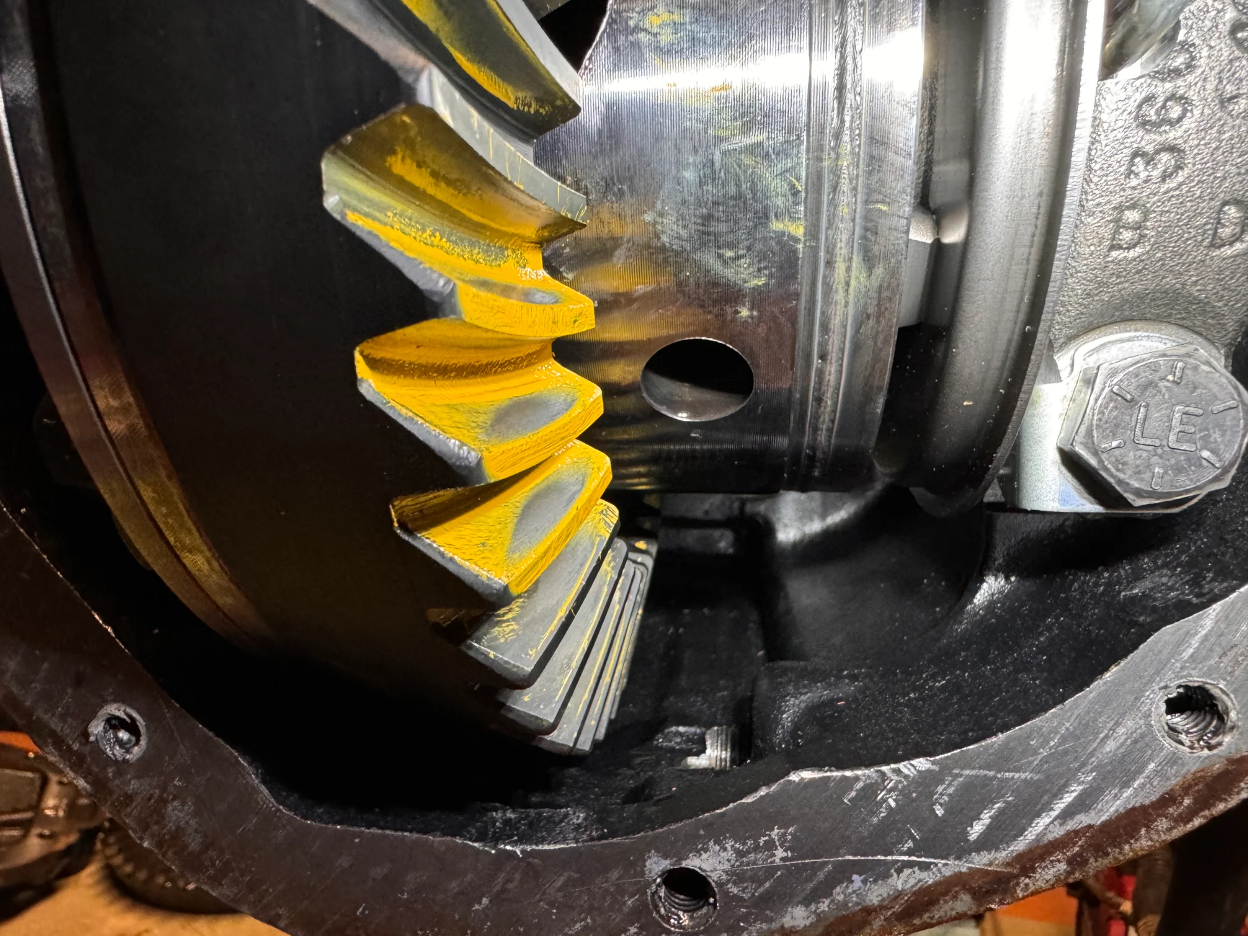

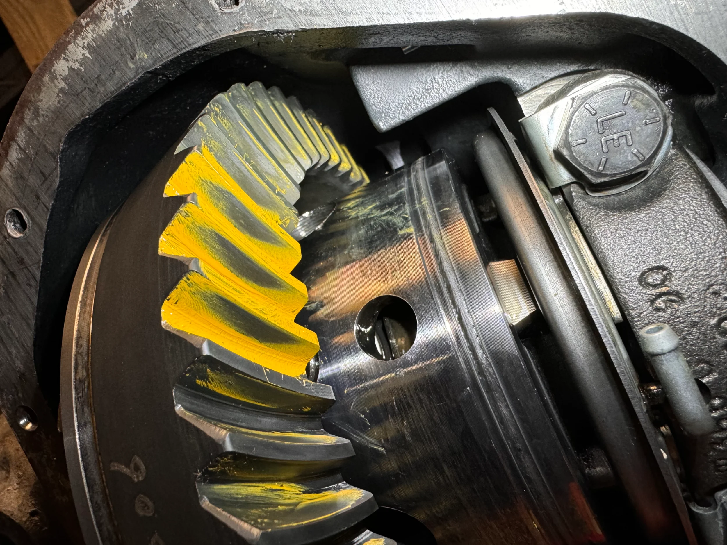

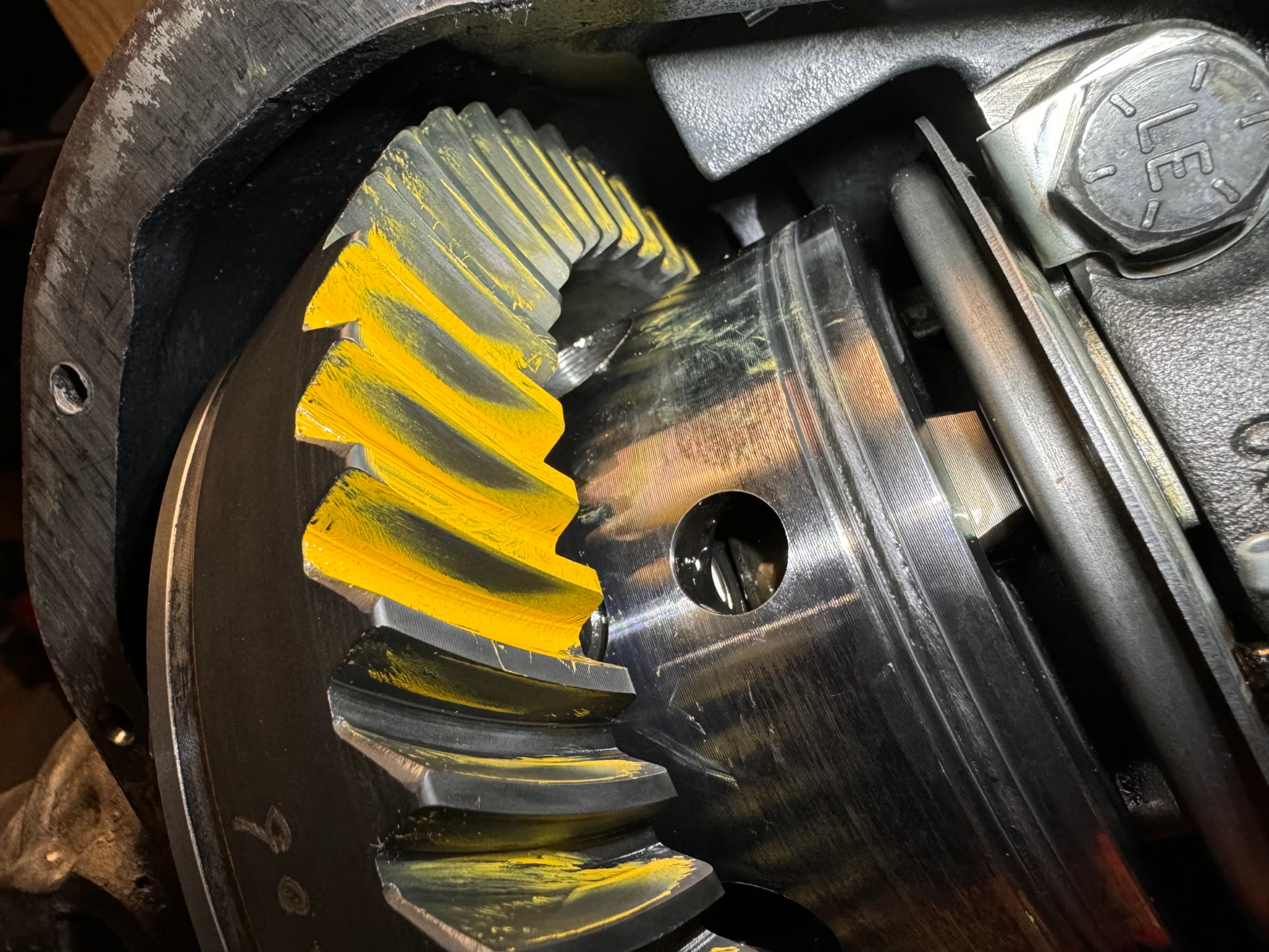

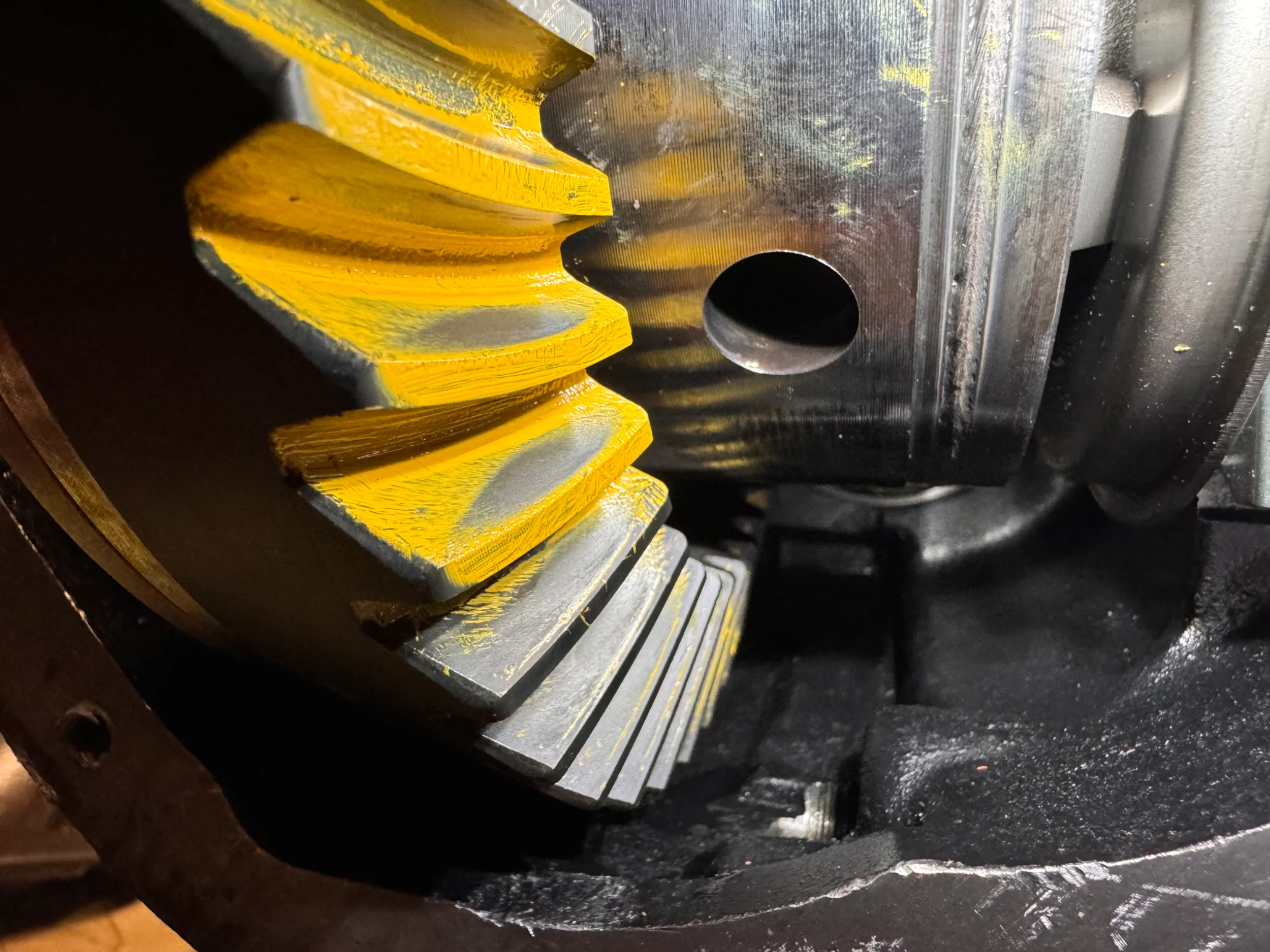

J jeewagon New Member Original poster Joined Mar 24, 2024 Messages 4 Location California Dec 22, 2024 #1 This is my first time doing gears. Any help would be much appreciated. Vehicle: 2004 Rubicon. Dana 44. Installing Revolution 5.38's. This is the front diff. I'm at .008" backlash. .048" pinion depth. Thoughts?

tworley Metalcloak free Supporting Member Ride of the Month Winner Joined May 23, 2018 Messages 9,671 Location Arvada, CO Dec 23, 2024 #3 Looks damn close to my untrained eye. Maybe a smidge shallow still....
hosejockey61 FAFO Supporting Member Ride of the Month Winner Joined Apr 9, 2020 Messages 5,055 Location Parker, CO Dec 23, 2024 #4 It's too shallow.... Add 5 thou Reactions: Rickyd, Blackjack and Apparition
