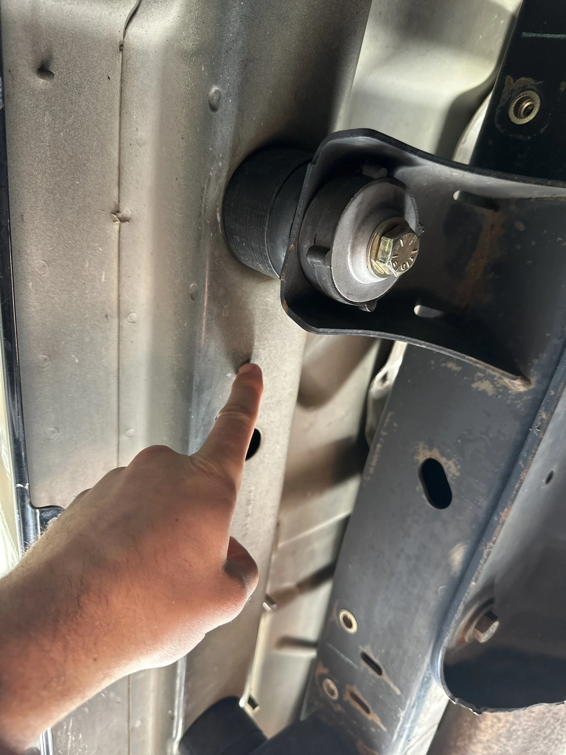

Typically, the well designed sliders are attached underneath to the torque boxes using nutserts and bolts. Nothing passes up into the floor where your feet live.
Is this the torque box? Couldn’t I cut out the body mount slot to where it just wrapped around the puck and attach it with a rivnut to the torque box?

What is your plan to avoid using the body mounts as a method of attachment? 🤫
Yes
That is a preferable method than using the body mount is. And likely less work.

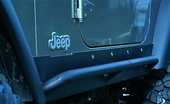

Tub/body mounted sliders, which are bolted directly to the rockers like Savvy's are, are by far the strongest and most protective way to go. Frame mounted sliders require two spindly mounting brackets that connect between them and the frame and they flex and move around and don't protect the tub nearly as well as tub mounted sliders do.
