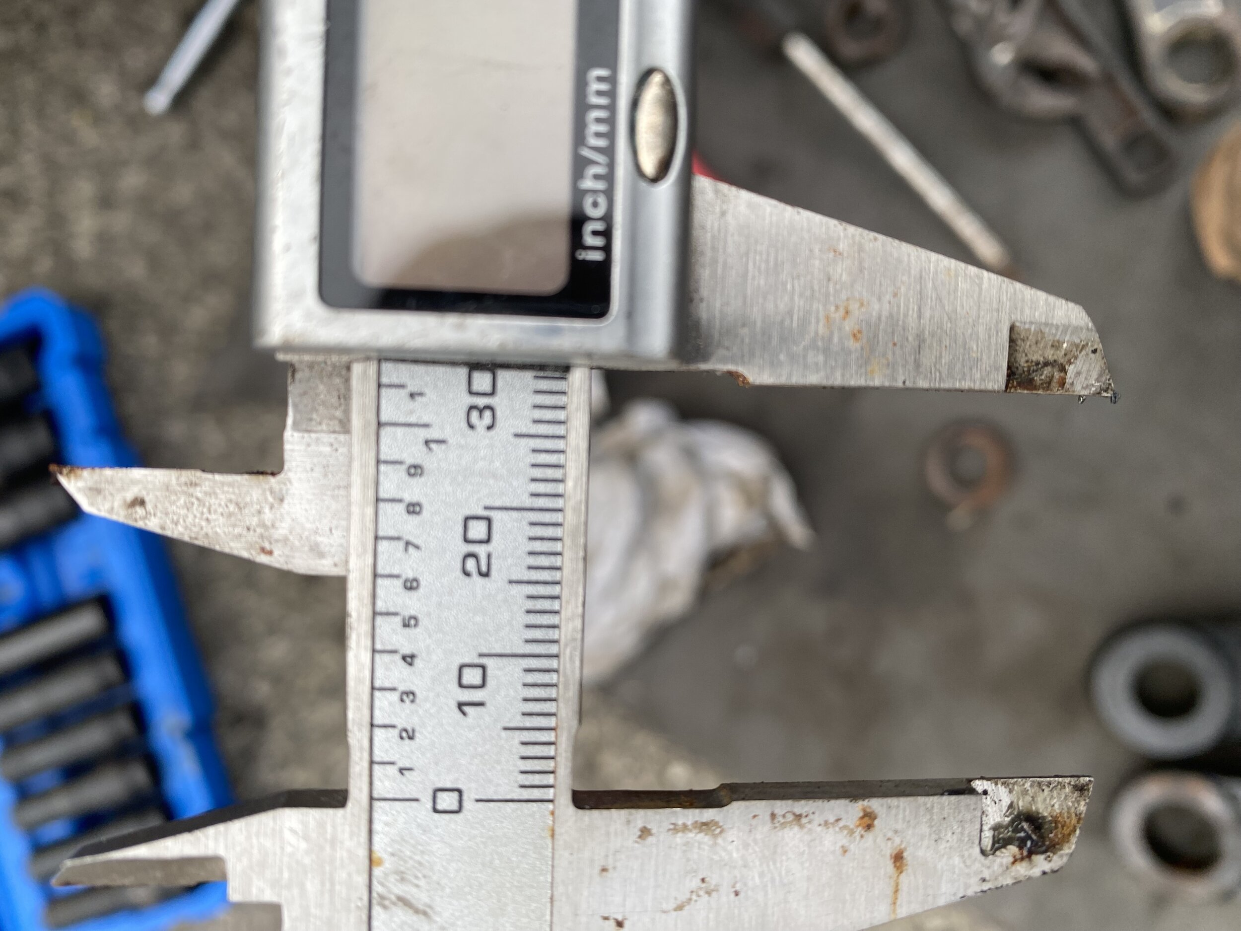

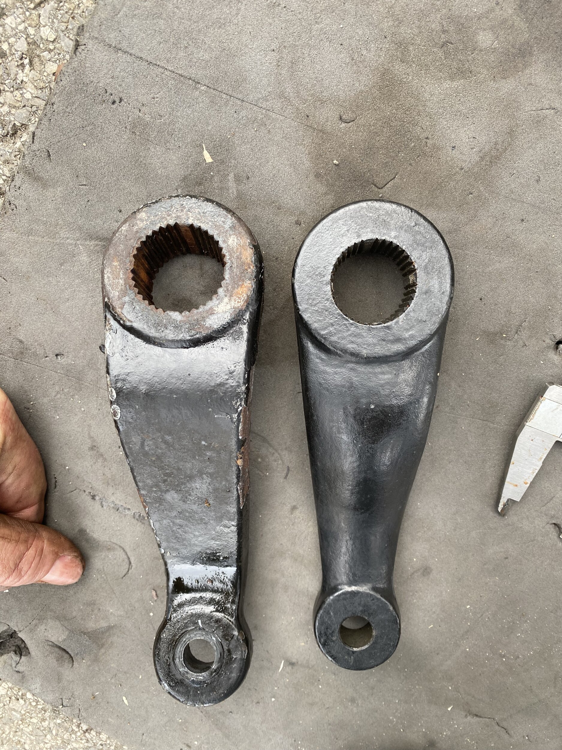

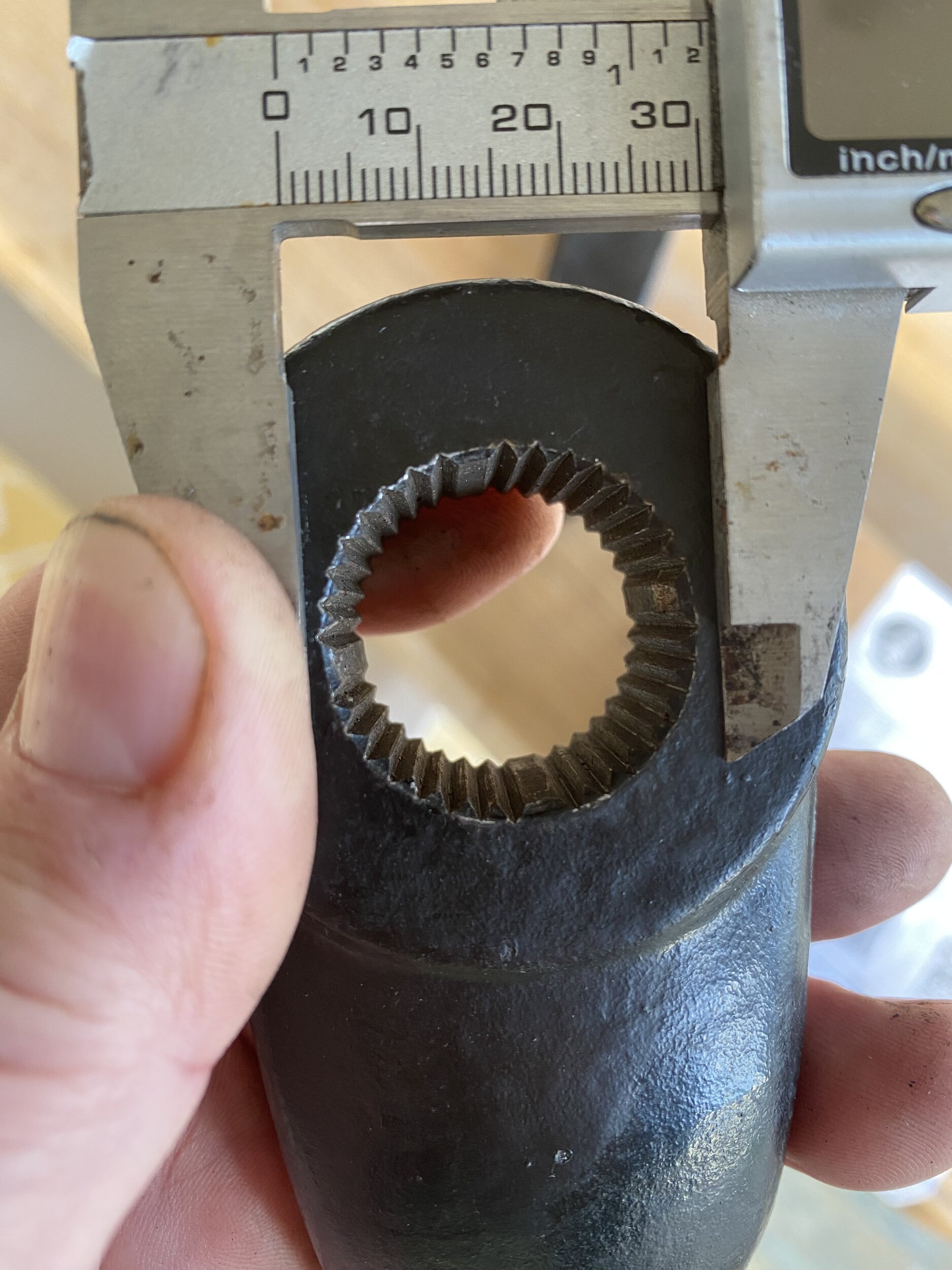

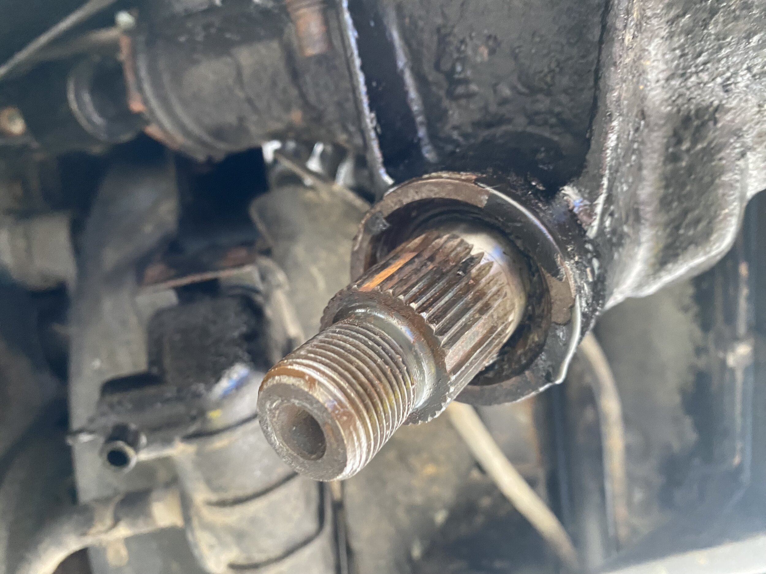

Hi I’ve just spent most of the day taking off a dropped pitman arm to replace with a standard one.when I tried to put the replacement crown one on found it to be a lot smaller on the splines. it said in the add 1997-2006 so I presumed they were all the same I’ve attached some pictures and any help would be much appreciated?measurements are between the flats on the spline.

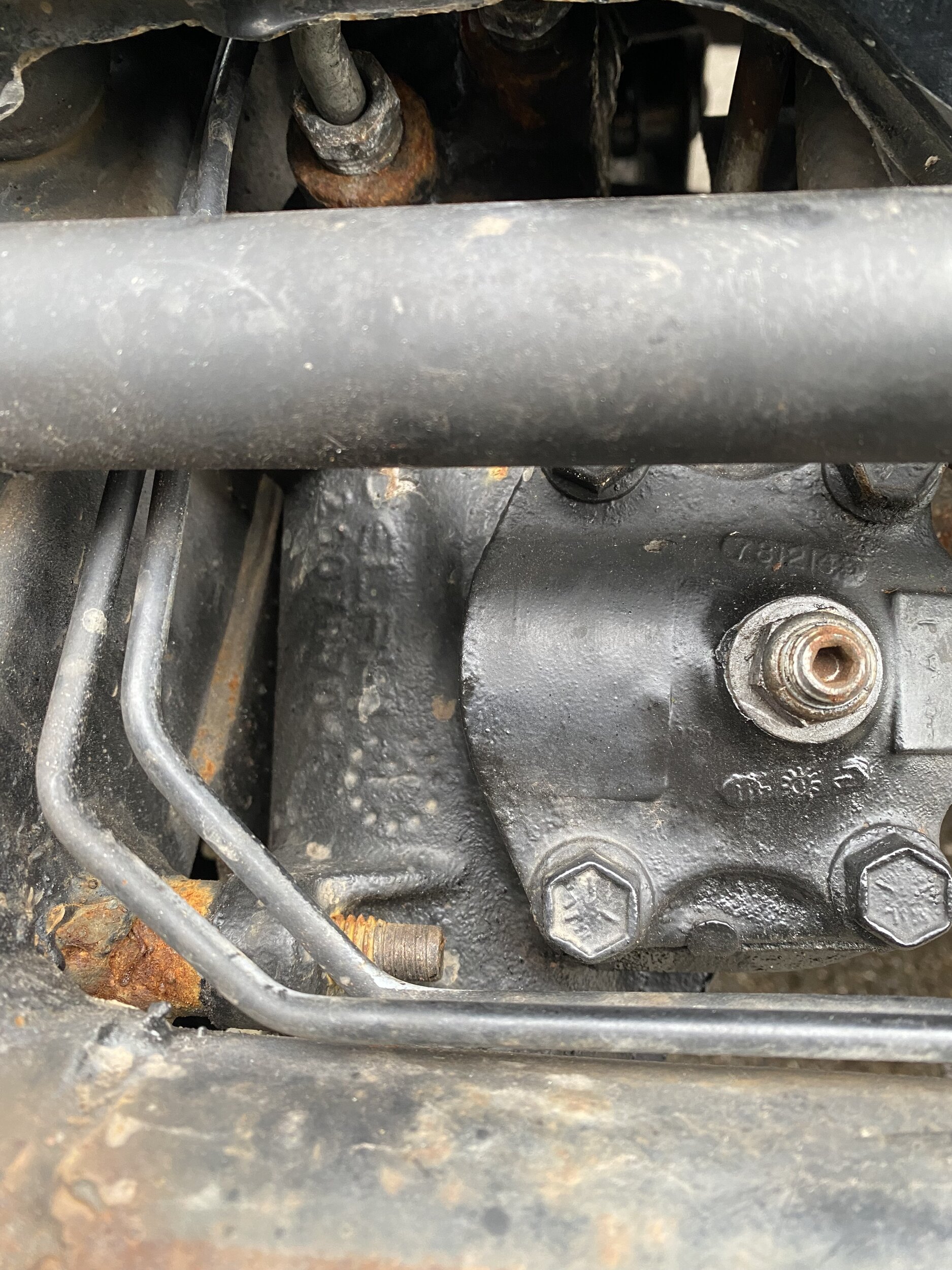

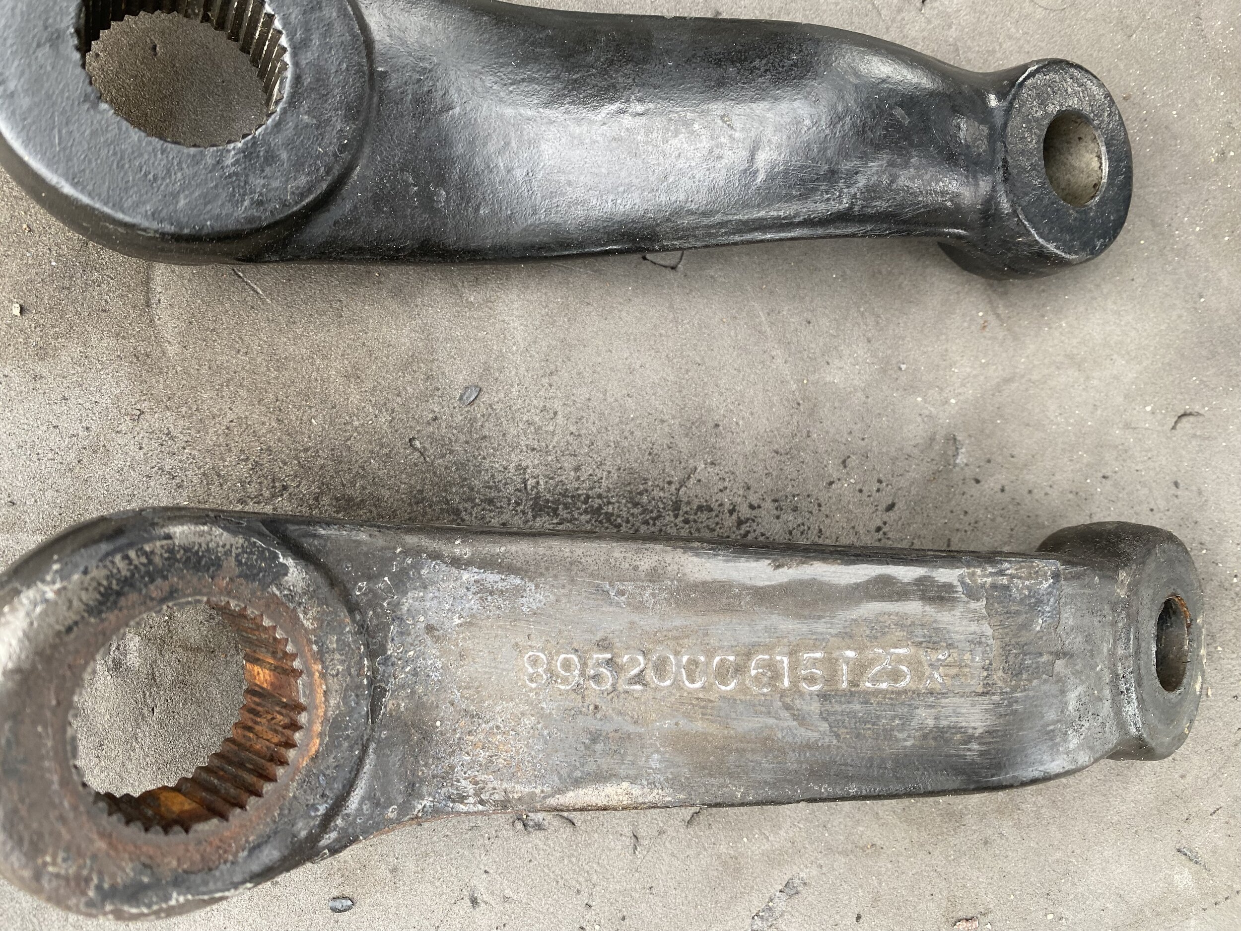

I’m wondering if po swapped the tj box with an xj one as the dropped pitman arm says xj at the end of the part number if so can I get a normal drop xj pitman to fit or do they not do them?

I think your correct MrBlaine I’ve noticed the splines are not at right angles to the pitman,ive found the part number from the dropped pitman arm says it’s for an xj so I’m thinking po has swapped the steering box out for an xj box I’m wondering if the original right hand drive steering box had a smaller diameter shaft.would someone be able to measure in between the splines on a tj pitman arm to see if it will fit if they have time?then the next question is would a lhd version tj pitman cause problems that I’m trying to iron out.thanks for your help guys I’m coming across a lot of problems and I appreciate all your knowledge.mark

My 06 and the 03 look and measure the same on the output shaft but the crown one I ordered is the same part number as my 06 but I can’t see how it will fit on as it’s 3mm smaller in between the splines as pictures if some one has spare that they could measure between the splines for me that would be great as I’m at a loss where to go with this?
