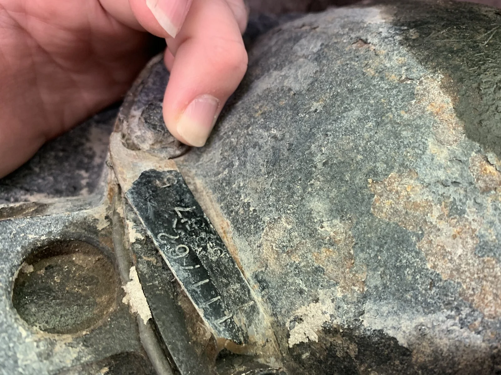

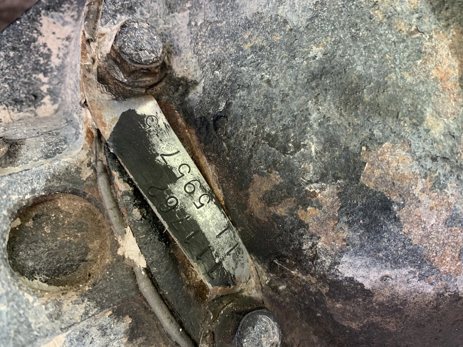

Need help determining gear ratio. rear axle went out and need to know.
2001 TJ SE 2.5l 4 cyl with 5 speed manual
You should have 4.1X stock but if you aren't the original owner it could have been swapped. The only way to know for sure is count teeth on the gears or spin the input and check the output.
(if you are having a shop do work on the axle let them buy the correct parts, if looking for a used axle 4.1X is probably what you need but I'd personally check it before spending money)

pop that bad boi open and check. Divide the number of driven gear teeth by the number of drive gear teeth. lil math never killed anyone.
