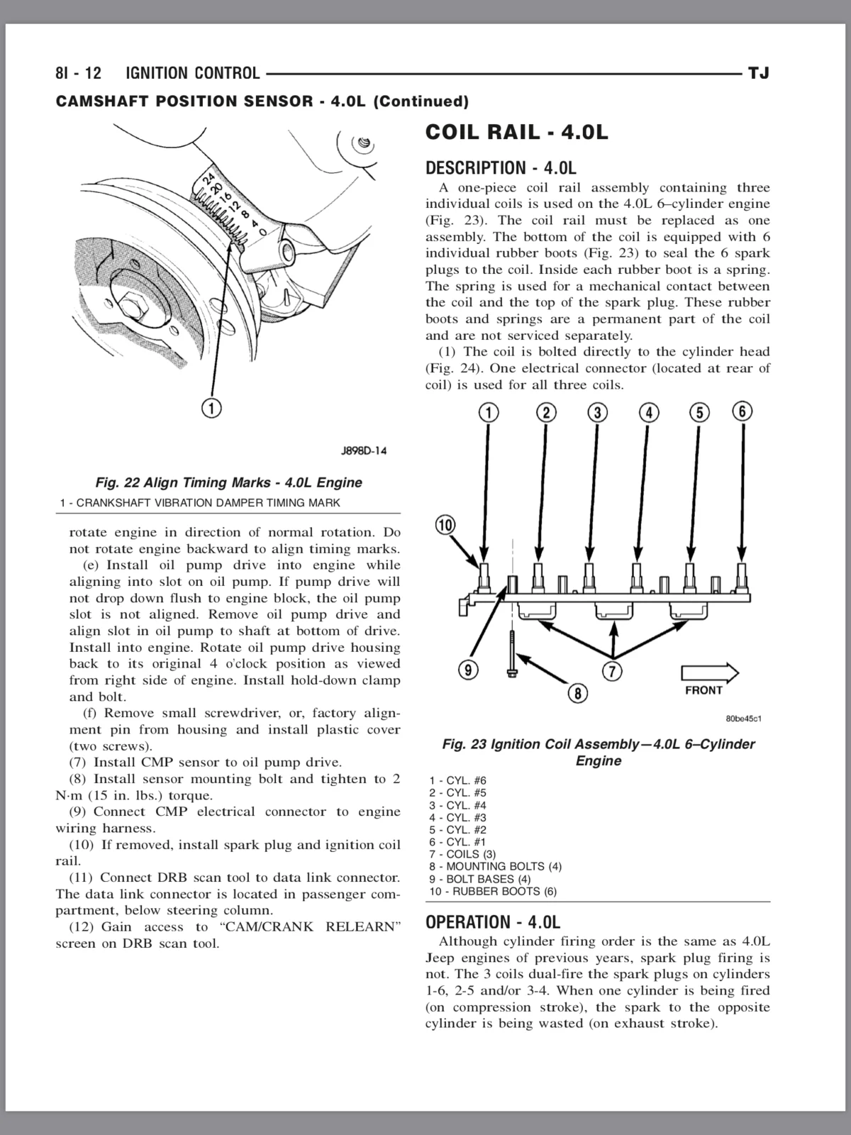

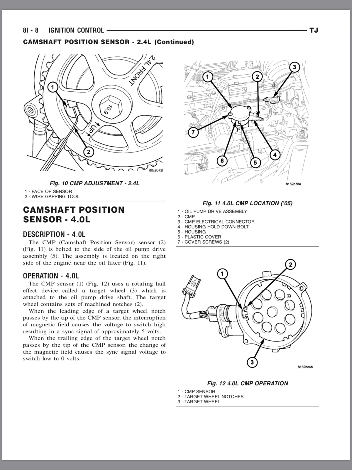

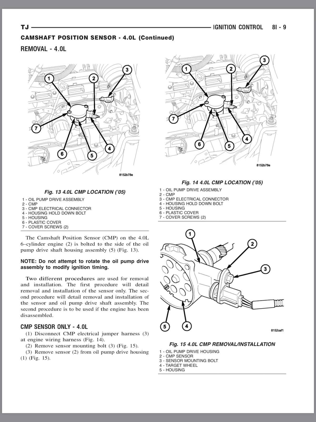

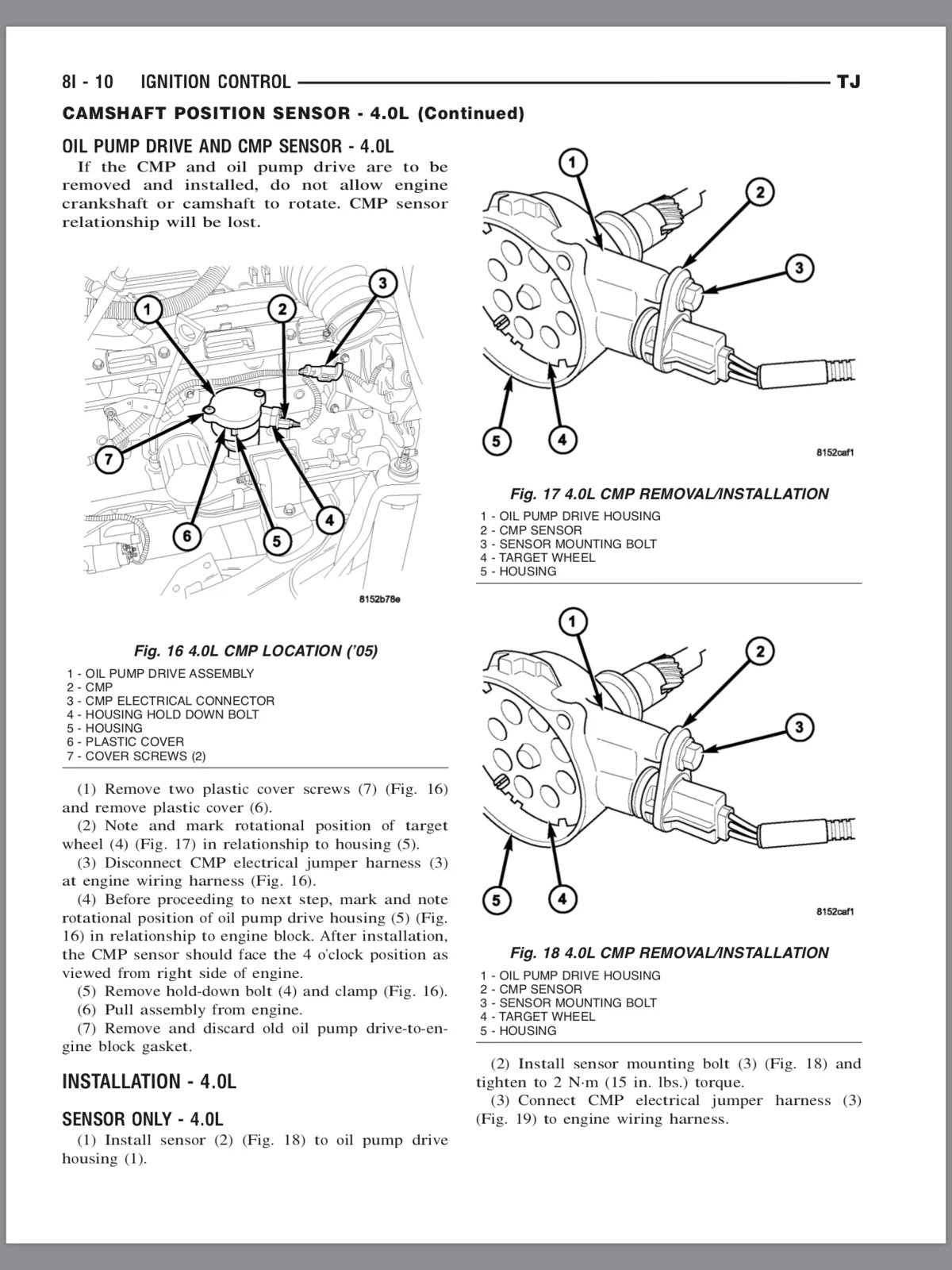

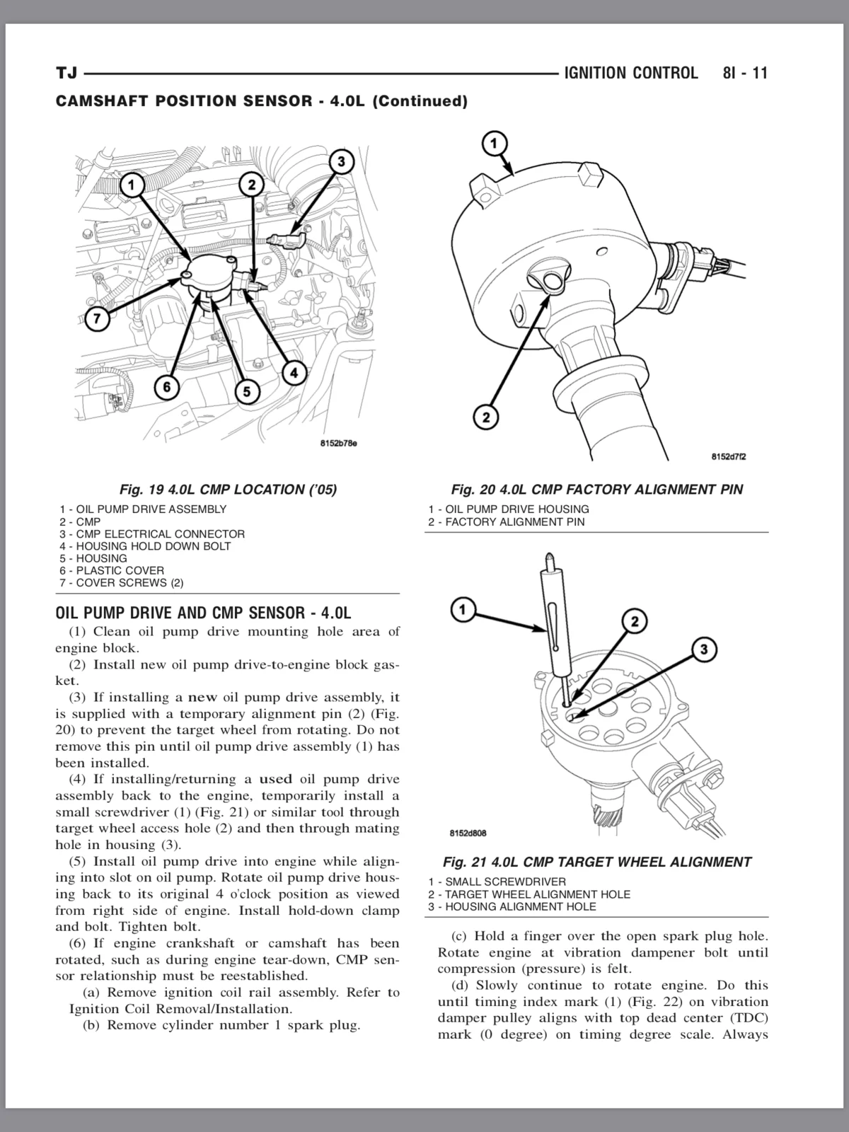

Okay I have scoured the internet but I can’t seem to find my particular sensor and how to instal it.
I had a new stroker engine built, and I’m trying to install the cam sensor. I have the oil pump set at the 11 o’clock position but the sensor is completely different than what I’m seeing online.
I do have the engine set at TDC so am I supposed to line up the top lettering with the sensor???
I don’t see anywhere I can do the tooth pick trick.
Follow this procedure:
